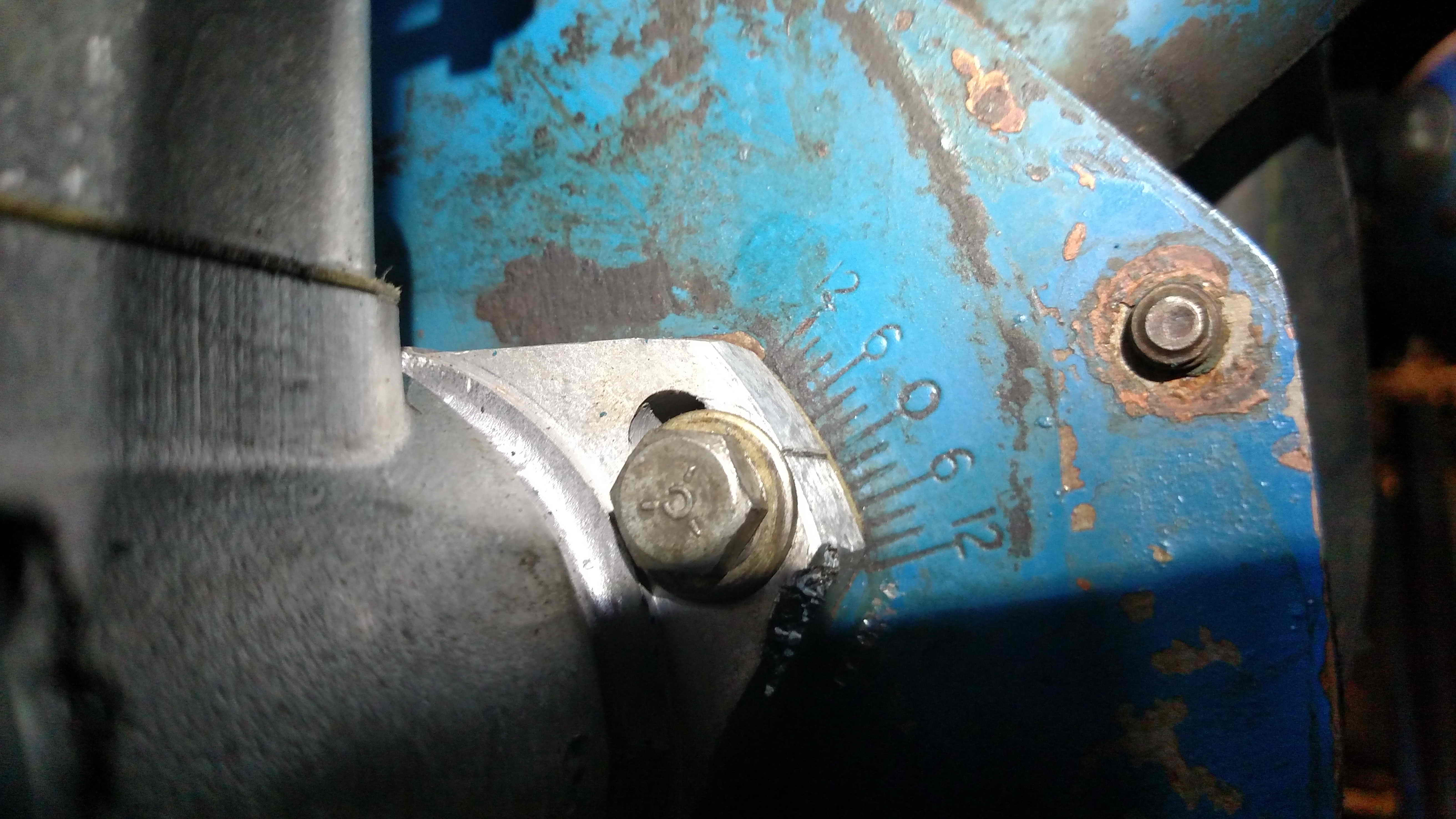

Alright, I appreciate the advice and ideas, so I drained the oil and took the pan off, but did not find any metal, not even a speck,
so I opened up the old filter and no metal specks were found. So that's a good sign.
So I put it back on and filled it with Rotella and a new filter.
I had a diesel mechnic help with replacing the push rods and he checked the rest on a mirror and all were real straight.
Then he proceeded to set the valve lash and made sure it was by the numbers in the manual.
Had a new air filter in it already, so that's good.

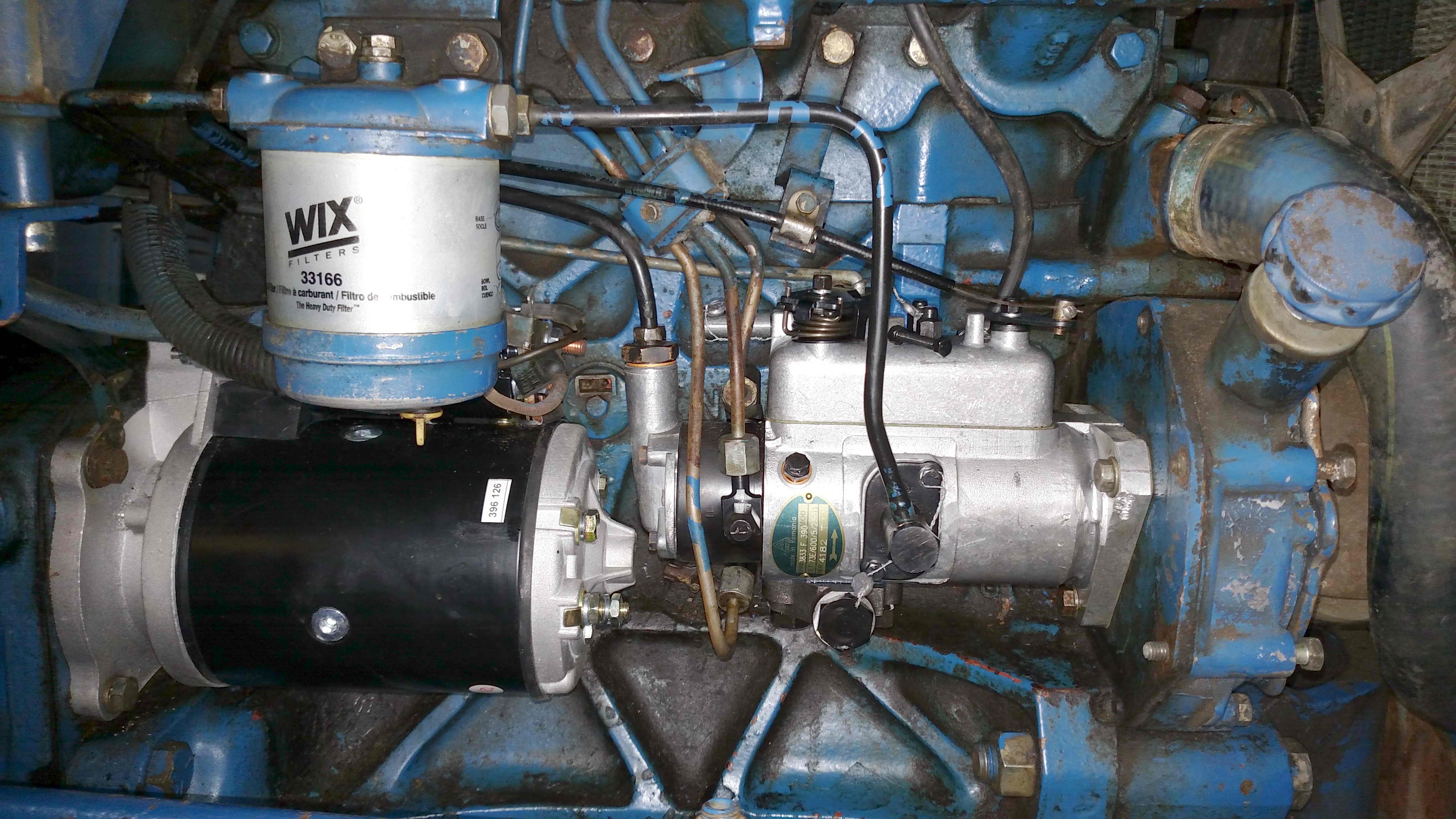

So when I installed the new fuel pump. I set it to "0" like the manual said, but did try starting it with it a little before and a little after, but it would not even smoke at all.
Pretty sure the old guy that owned it, said he used most of a can of starting fluid trying to get it started again after it sat all winter, then just gave up on it.
I put a gasoline soaked rag over the intake but it didn't change anything, even tried WD-40, but it still white smoke and allllmost starting up.
So I rechecked and all 3 injectors are spraying good.
So questions are:
Can a fuel injector that's not electric, stick "open" ? and even if it does, can that keep it from starting ?
So if I want to attach an oil pressure gauge, where do I add one on this machine ?
What shoud the compression PSI be?
Also, any idea what year this tractor is?

Did you time the new pump? Injectors Are designed to "break", or spray at a specified pressure.

Well, I checked my Ford IT tractor manual and it said to line up the marks on the pump with "O",
and I've tried starting it with it a notch above and below and it won't even try to start.
I didn't move the motor between removing the old pump and installing the new one.
Is there another way of setting the timing ?

There is a specific procedure for removing/installing the injection pump. It's timed with the cam and crank. I think you are going to need help on this.

When we removed the old fuel pump, the drive hub has a notch that fits in a slot in the timing gear, so it'll only install one way.
I took the old pump to a diesel repair shop and they found a bad hydraulic head and wanted $1200 to repair it,
found a guy on ebay up in east tenn had a brand new pump for $515, so I saved a few dollars there.
The starter is brand new, so maybe my video on photobucket is not up to speed,
the old starter worked great until we fried it trying to get it started and the generator shop wanted $200 to rebuild it,
so I checked and found a brand new starter on ebay for $98.00 with free shipping.
