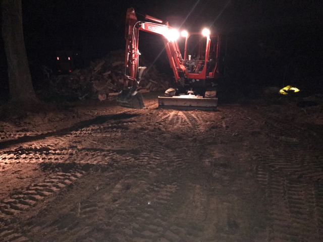

Got it roughed out, the blade sure is handy.
