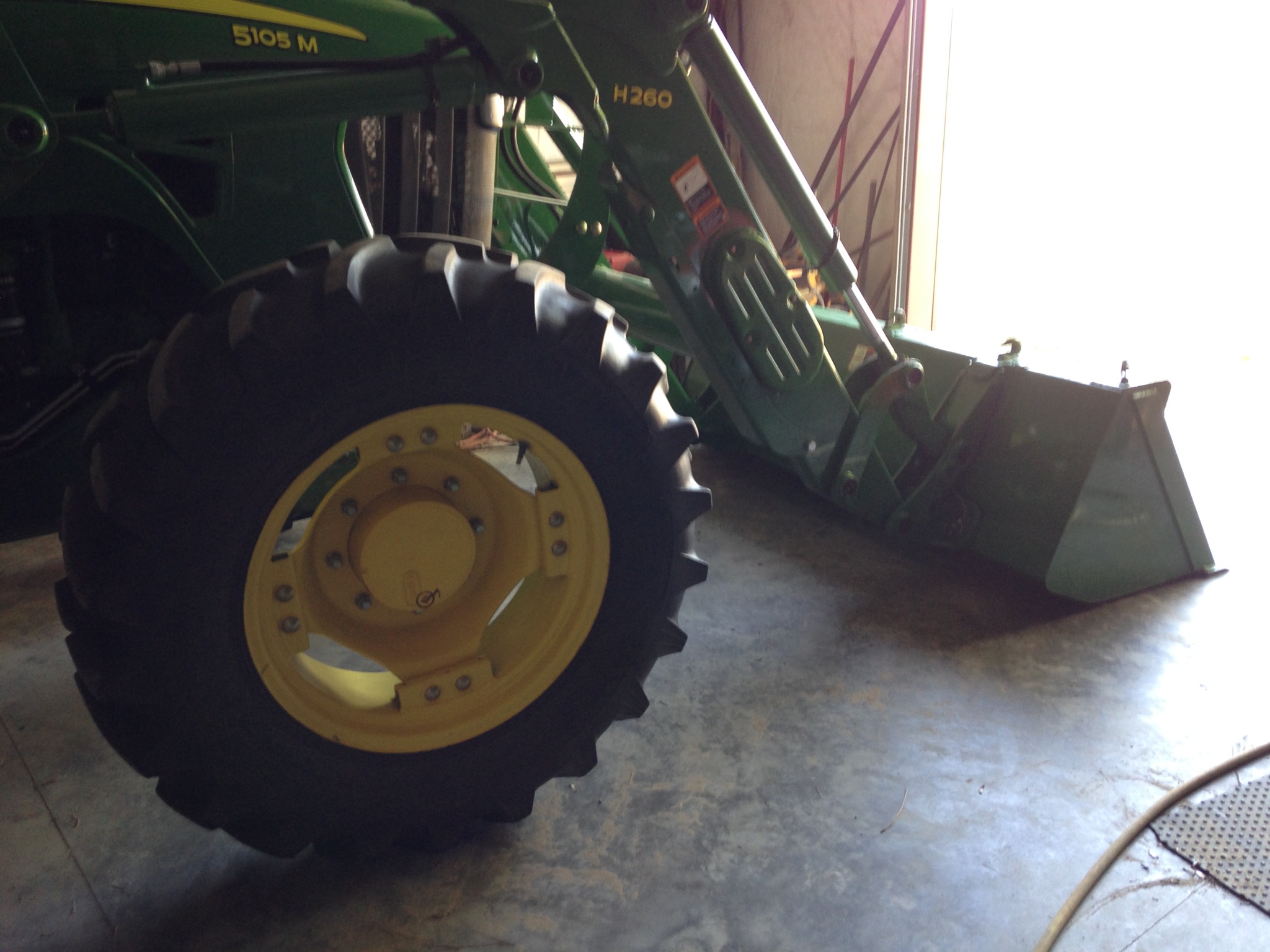

Sorry, I did mean to say the standard mount. Too much going on! I measured 7 7/16" so basically the same. I have the same tires as BigBlock. I will try to get some pictures in the daylight this weekend. I have the scrap grapple bucket on right now which is almost on the ground with the bucket level. I don't think it is the mounts because BigBlock and I have the same height at the loader arms. It has to be the position of the global mount on the bucket.

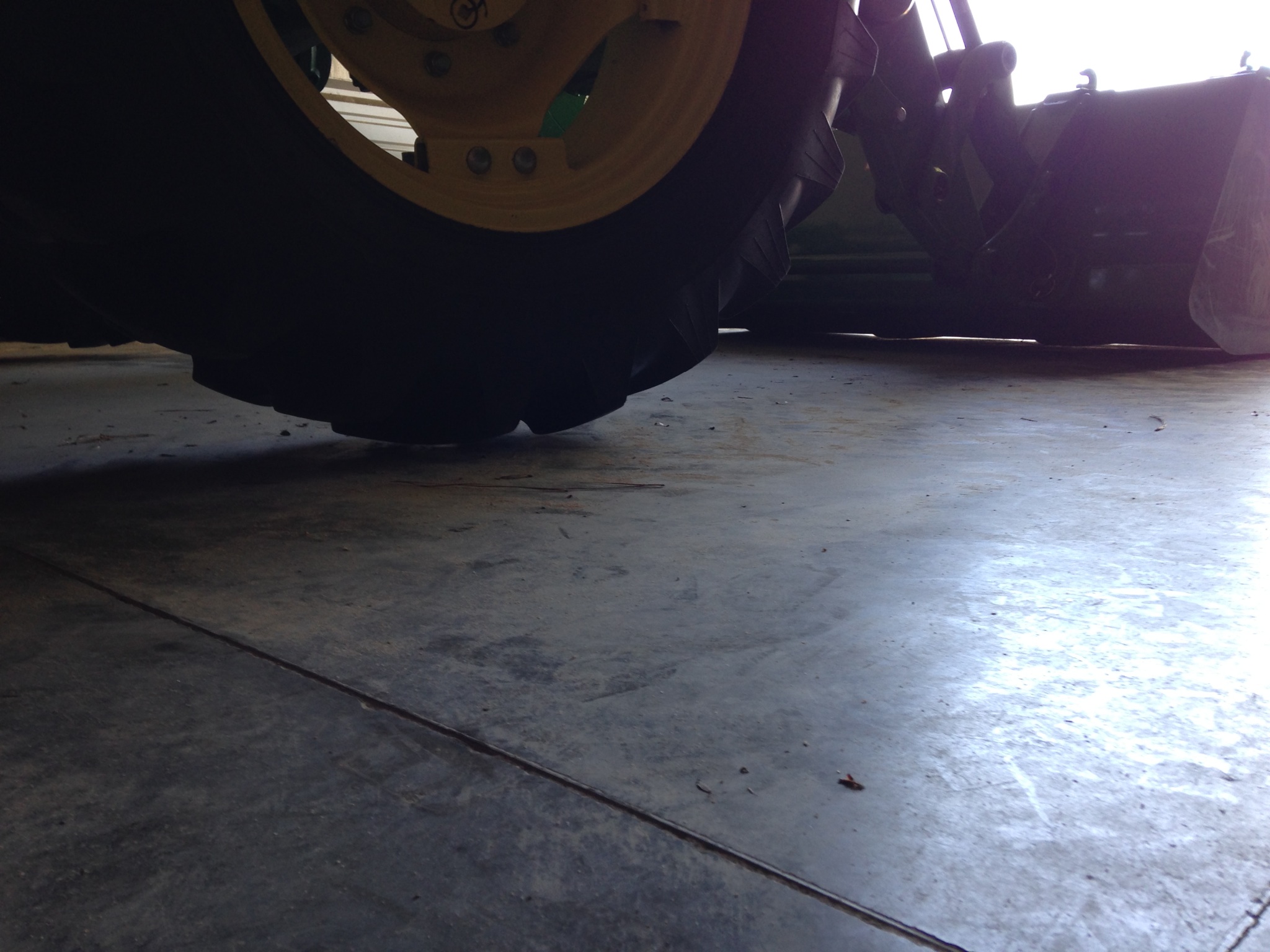

Well, I switched back to the regular bucket this weekend and this is interesting. When I first got the tractor, the tire pressures were set to the max and that is when I noticed the bucket at level would not touch the ground. I have since lowered them to something more reasonable and now the bucket at level will touch the ground and just lift the weight off the front wheels. It must have been the tire/weight distribution when I first looked at it.
