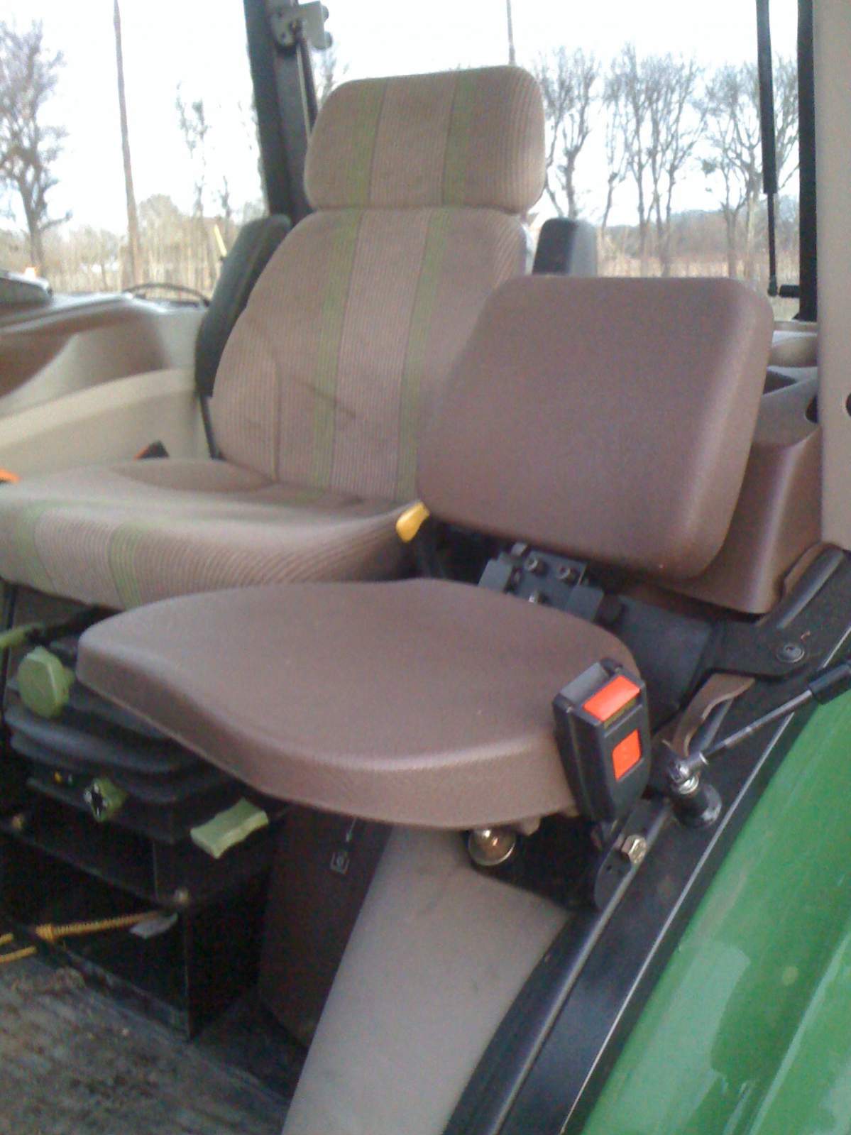

Finally pulled the trigger on an 08 5525. After about 6 months of looking I finally found the one I wanted. I am considering adding a buddy seat to my cab and was hoping I could get a little feedback from those who have one. Any pictures of one installed would be awesome. It would be nice for my kids or wife to tag a long sometimes so I am considering the seat. It looks like I will have to replace the plastic to the left of the drivers seat to do so? I dont see anywhere to attach anything from the current setup. I have also considered the seatback extension as it seems that the seat doesnt come very far up on the back support. Any feedback from owners would be highly appreciated. Along with those items I will belooking at a quick hitch system so I can hook/unhook the ccm drum mower a lot faster so any advice on brands would be good too, seems like the Deeres Imatch are kind of salty. I am sure I will have more questions to come...Thanks,

I have a 5525 and love it.
I would pass on the imatch. I had one for my 5525 - returned it.
I have a buddy seat in my 5525. It says you have to have a epto but they installed it anyway. Works great - I will find pics.
D.
   / Pulled the trigger on a 5525, now for the add-ons!!! #12
Sweet looking tractor! The buddy seat requires you to cut out the left side upholstery to install. Glad to hear you have the e-pto since it is required to install the seat. I have actually installed a seat in a standard pto. Alittle modification to the lever is required and there is very close tolerances for engaging pto. I can probably come up with pdf instructions I could email you, the file would be to big for attachment.
Mine does not have the epto. We bent the PTO lever a tad - works fine.
Also - there is an extra grab handle and extra handles on the door.
it is really well thought out.

Hey D I also noticed that you have the seatback extension on your operators seat. Do you feel that it is worth having it on there? Any dislikes? Thanks
   / Pulled the trigger on a 5525, now for the add-ons!!! #20
That seat extension is a "no brainer" it really helped. My upper back was sore after more than an hour or so in the tractor. Add the seat back and now it is all good.
Pull 2 plugs out of the seat back and slide it in.
D.
