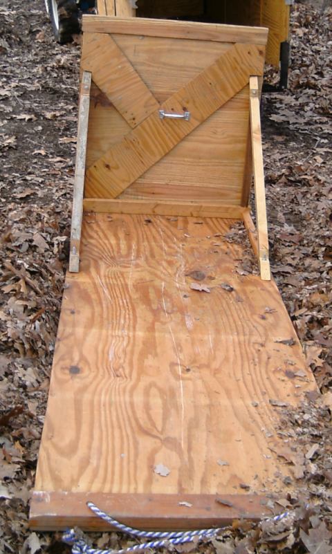

Don, how did you attach your rope to the tree? My question is, how do you avoid a knot that gets really tight when you pull forward?
I finished your invention, and tested it yesterday with just a half load since I only had a 200 pound test rope. Everything worked great. I have to make a small modification; since my unit is large and heavy I had added a handle to help put it in the cart, but I need to move the handle. If I had to do it all over I'd make the entire unit an inch narrower -- it's a bit tough to line up to put back in the cart. Also, I forgot to think about storage -- I should have hinged the front vertical board, and then could have removed the side 2x4 supports (I used bolts) and hinged the unit for easy inside storage. But other than that, it works great. I'll try to post pics shortly.
I use a tow strap -or- chain, with hooks. Hook one end around a tree and the other end to the rope on the slide out. The rope on my slide-out is tied in two places (2x4 angled supports) forming a 'U' shape so it's not necessary to do any knot tieing to pull it out. Just hook and pull.
Don

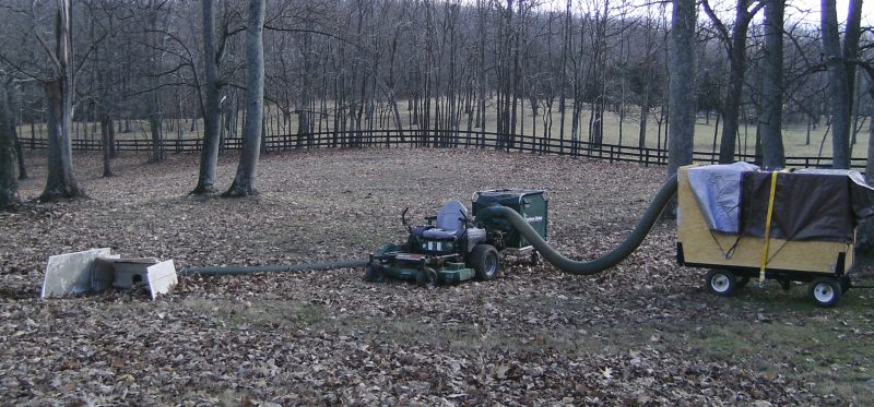

Well, here it is in action...my first post with photos, so hopefully I'm doing this right.
Two pics show the entire 'system' in action. Note that the bag on the Cyclone rake is bypassed. The entry vacuum hose goes to the vacuum, and then outputs into the large cart. On the imput side, I'm trying something new; instead of the backbreaking method of manually sucking up the leaves, I attached the input hose to a box (just a plastic storage bin) with 2 boards forming an entry shute. I then use a backpack blower to blow leaves into the box.
The other pic shows the sled.
The system works great. A little slow in some ways (getting the leaves into the box takes some subtle blower work, and getting the whole system in place takes a while). But once going, it saves the big time waster, dumping the leaves, since this cart holds at least 5x what the cyclone rake bag holds, and now with the sled, the dumping is very quick.

pic of the sled....

bill333 said:
The system works great..........the dumping is very quick.
Excellent! Should be good for years to come.
I have an idea'r. :D For the next update down the road apiece. Is there a possibility of hooking the large wagon up behind the cyclone rake and pulling the whole rig while vacuuming with the mower deck. It kinda be like driving an 18 wheeler that doesn't back up. :rolleyes: .....but it would work in open areas. Just 'leafin' a thought for a future project. :) You can never have to many future projects. :D
Good job on the sled!
Don
   / Pulled the trigger on a Cyclone rake #56
Well, as for the sled, I have you to thank, it's your design!
BTW, there was no problem at all with the larger size, it still just slides out fine.
Regarding the 'semi' idea, I have thought of this. I'm not sure if the 'trailer' on the rake would be strong enough to connect the cart to. What I have considered is, at some point, finding someone to help me weld a small platform on the front of the cart, above the level of the tongue. I could mount the vac on that (it is held in place on the vac cart by just two bolts) and do away with the vac bag altogether.
