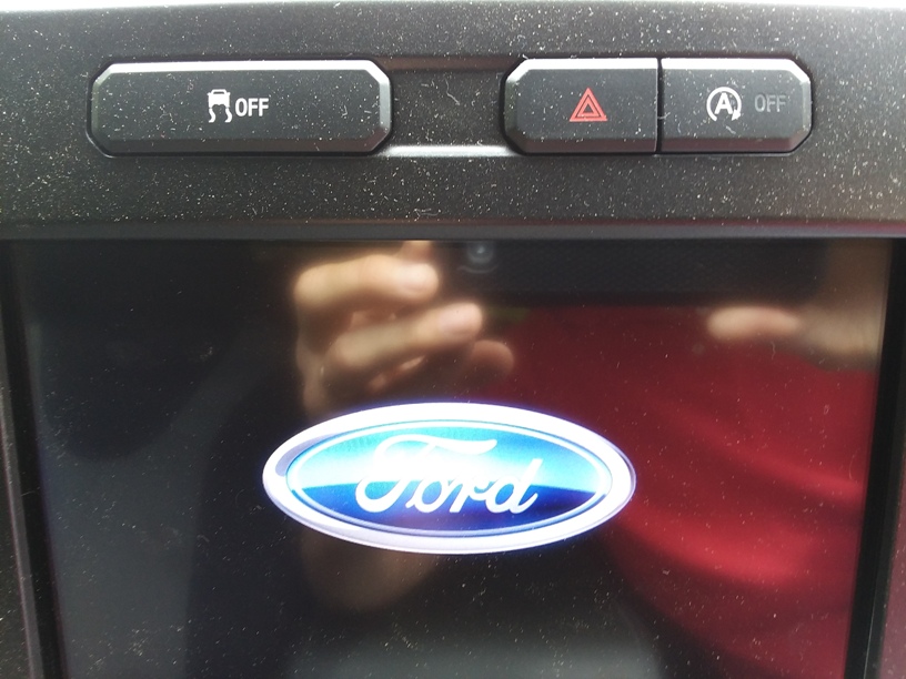

If you want the stop/start automatically off you have to go into the setup to default it off. However, you can just push the button the dash also.
