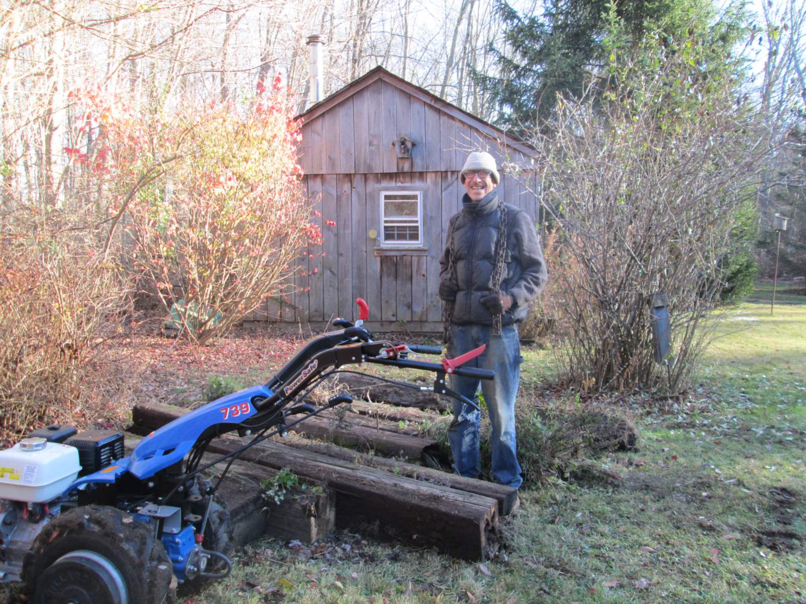

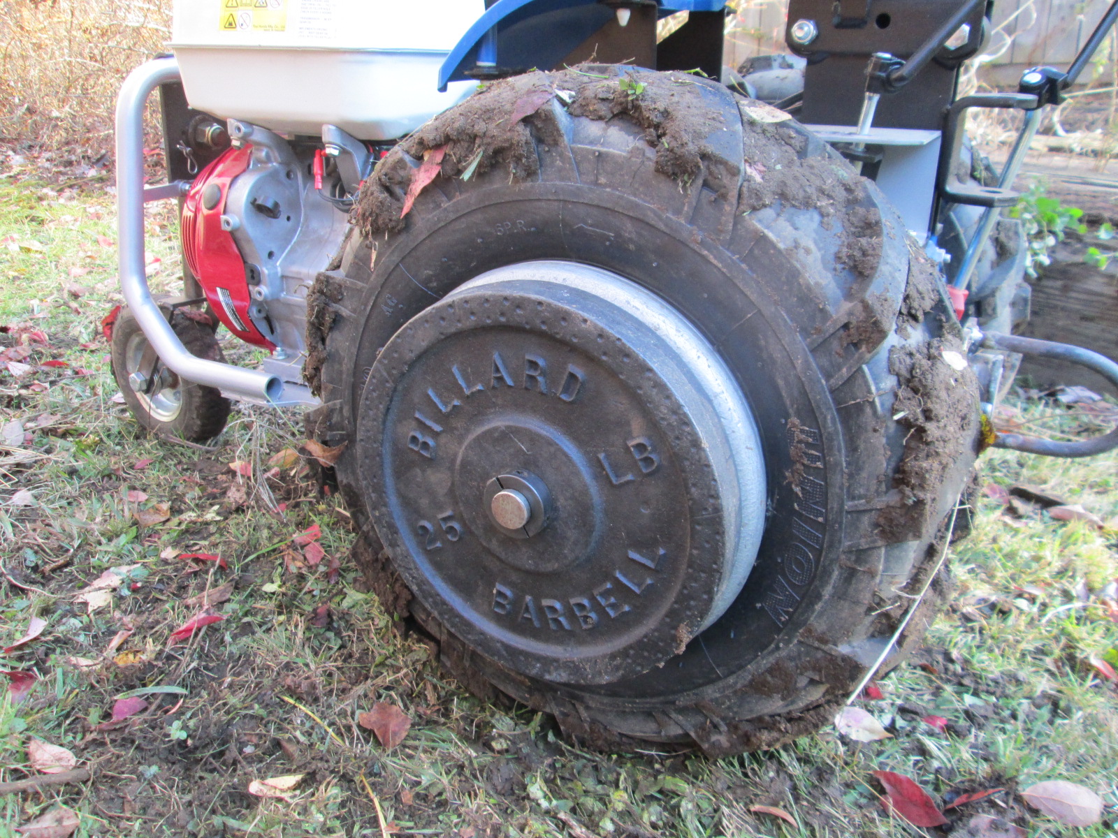

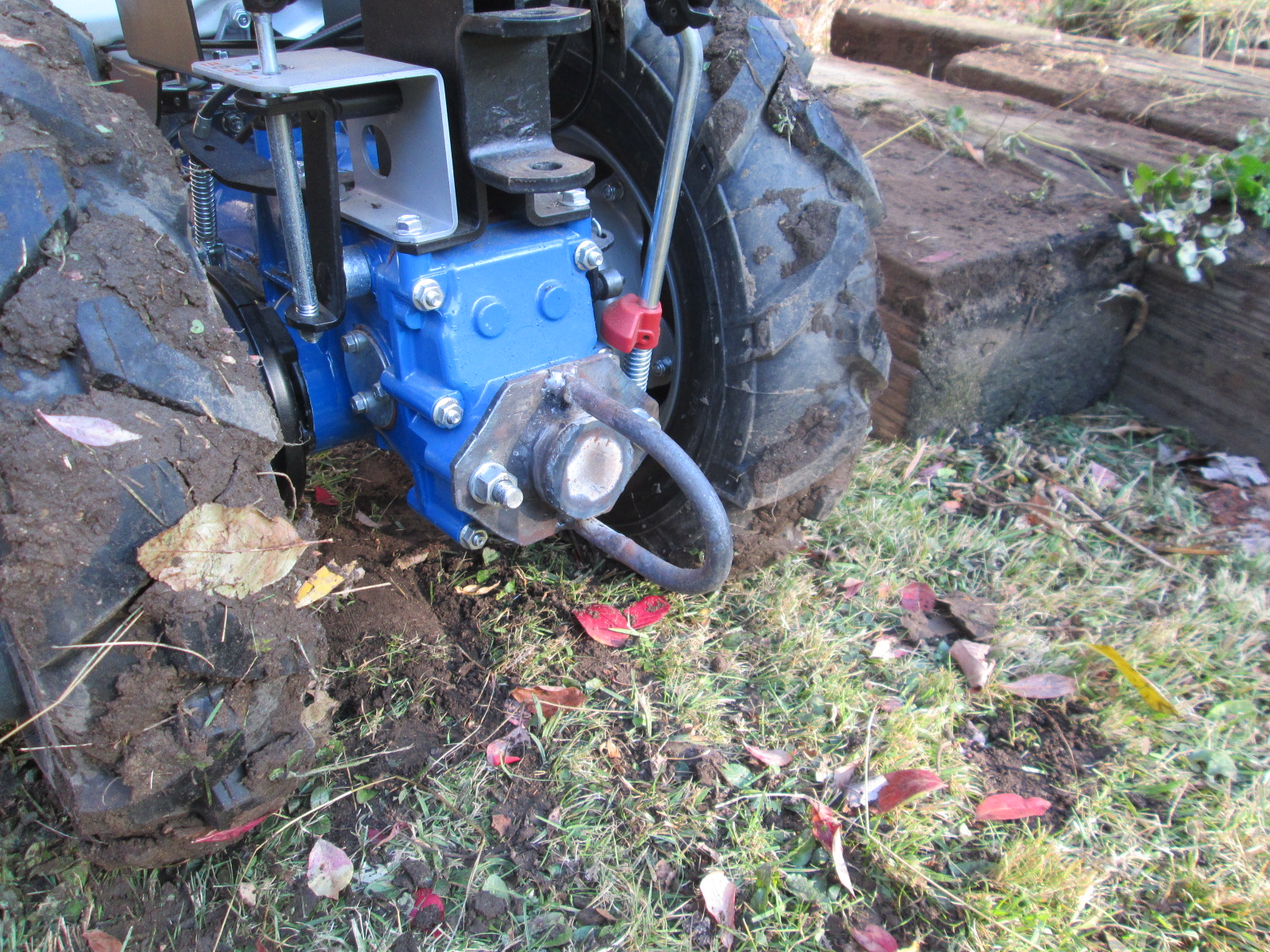

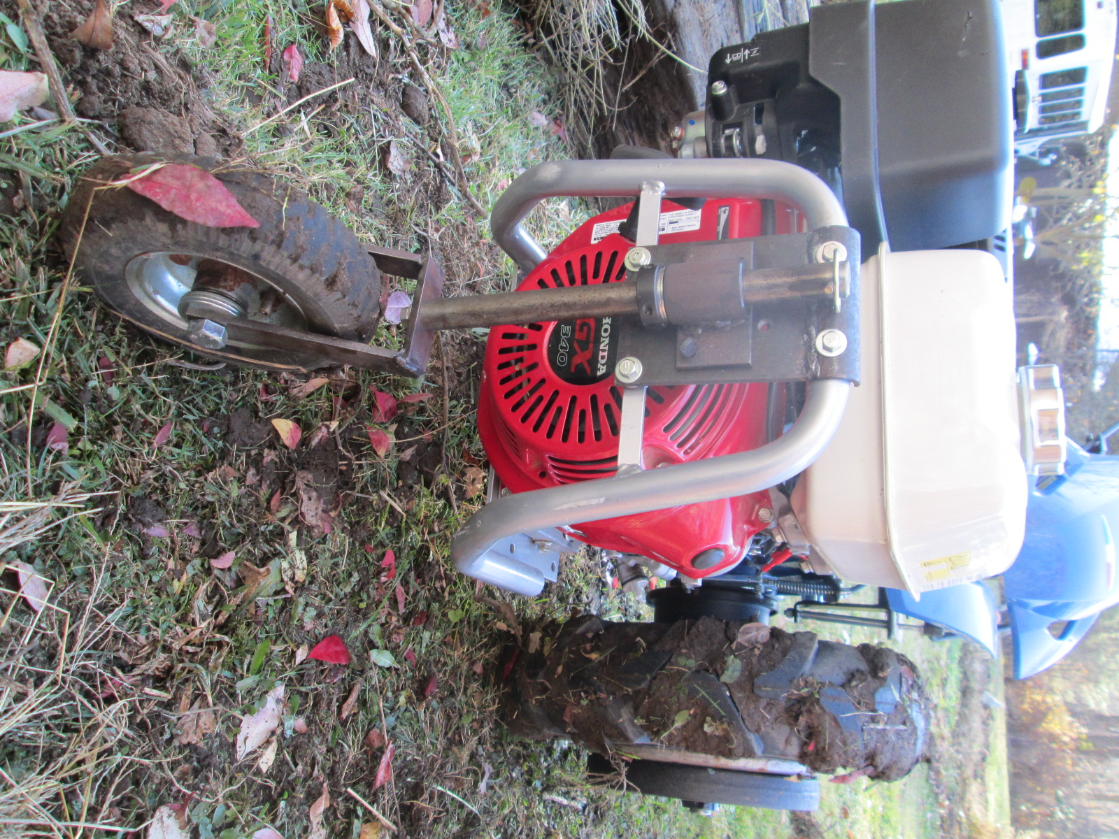

Here's a pullin' rig I made for my mule. Consists of a pull hook on the pto, 75lbs of weight on each wheel, and a transport wheel to support the motor end of the tractor. I used it to pull some heavy railroad ties out of the ground that had been soaking there for fifty years of so. This thing likes to do heavy work.

I like that idea. I was considering something similar for my 107d, but since the skid plate was only bolted to the engine, I was worried about the engine block taking the load and esspecially the shock.
