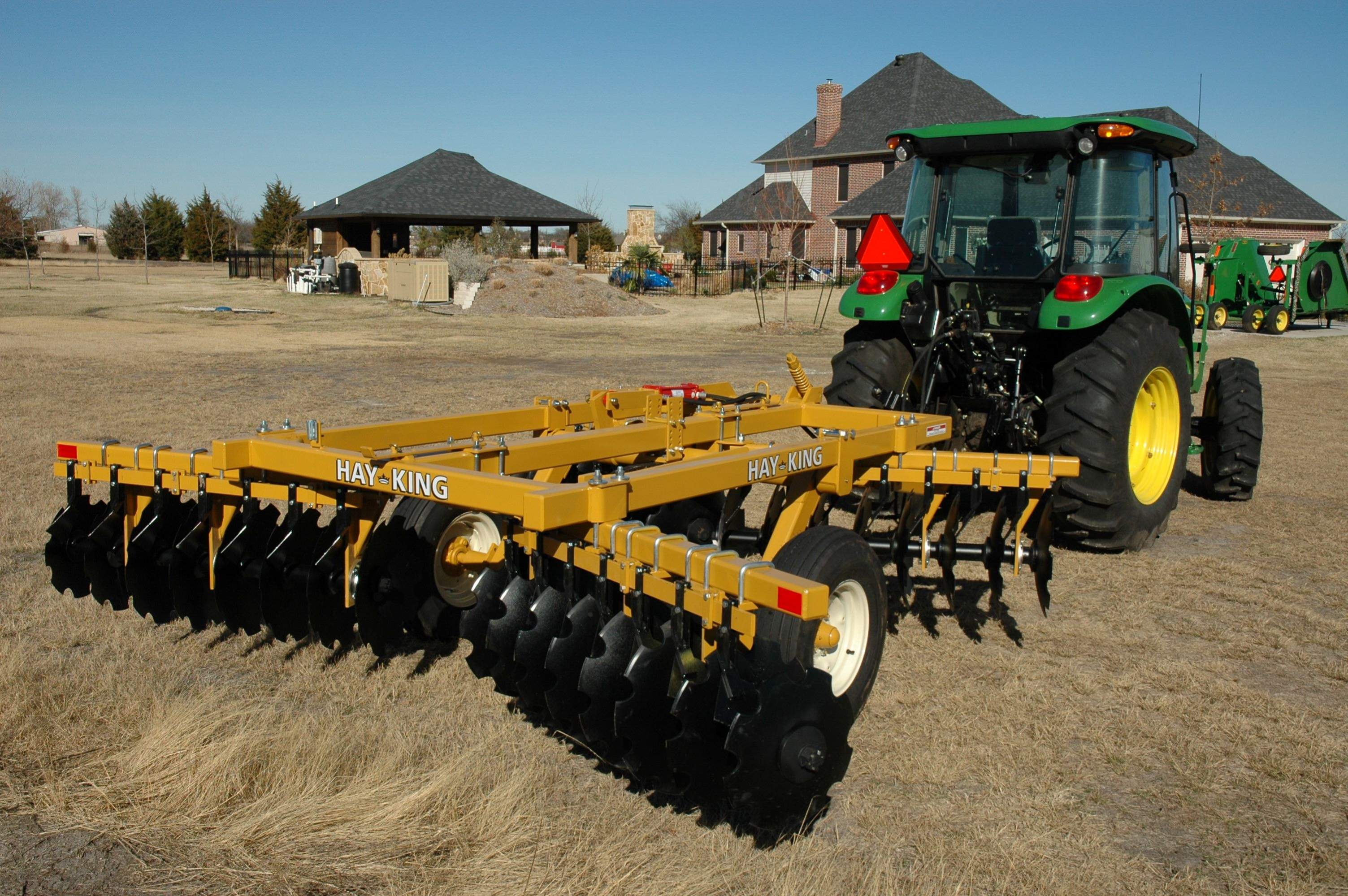

I am going to be discing up some pastures for a seedbed next year. I have a 12' 32-20 hay king that I will be pulling with a John Deere 5525 (75 PTO).
Any tips would be appreciated.

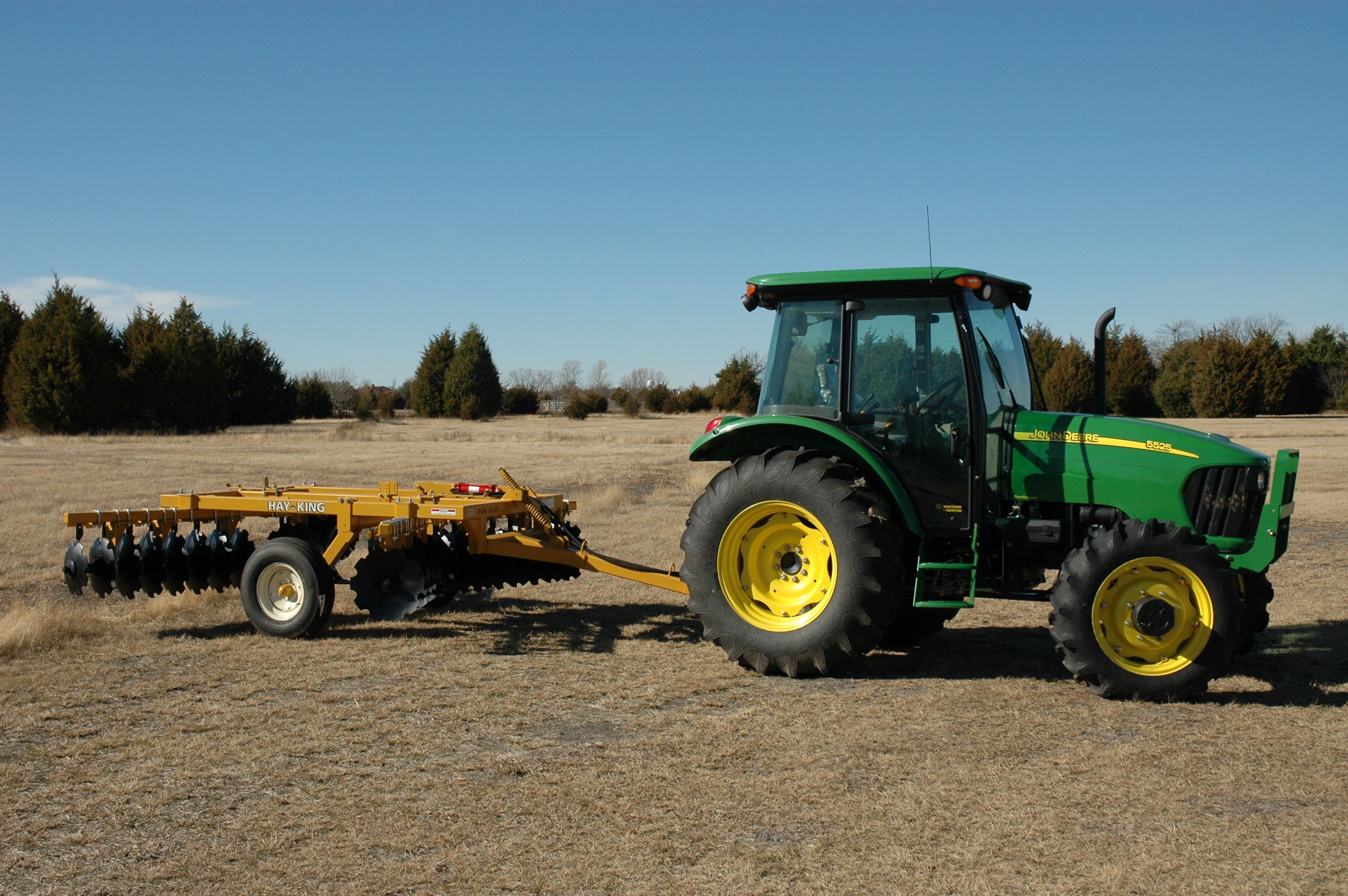

Pics of when I first bought the disc. Tractor without weights and FEL.
D.

As to speed you need to be able to roll the dirt over and get it to level. Too slow a speed and you don't tear up the roots or loosen the dirt that well. On my disk you also end up with a very unlevel job. You can run too fast but is not likely. Now if bouncing out of seat and can not make turns you are TOO fast. More than likely the first sign of running too fast is the disk is not sinking into the ground as much and thus cutting as deep as it should.
But a rule of thumb, on 4 speed two ranges trans it seems second gear in high range fits most of the time.

Here is a small 18 footer that I normally pull behind my Kioti 45:)
I think, as most responders have mentioned, soil conditions are critical for matching disc size to hp.
