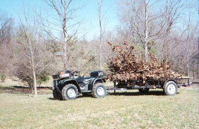

Is a BX1500 capable of pulling a 6x10 trailer loaded down with brush and small logs without damaging anything? The trailer is not too heavy and has a 3500# axle but is much beefier than your typical lumberyard special. I've pulled a small 4x6 with my BX1500 the 6x10 seems quite heavier.
   / Pulling a 6x10 trailer with a BX1500 #2
Does the trailer and brush look like my attachment? /forums/images/graemlins/wink.gif I cleared brush around the yard a few years ago with an identical trailer. My atv pulled the load with no problem at all, and the atv is lighter with less hp. I'd think the BX would handle it like a pro.
