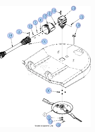

There's most likely a splined/keyed bar behind the disk and blades. Pull the blades off first then the disk should come off. The bar may need a puller to get off.
Apparently the Land Pride stump jumper disc is welded to the crossbar.
This diagram is from messicks.com

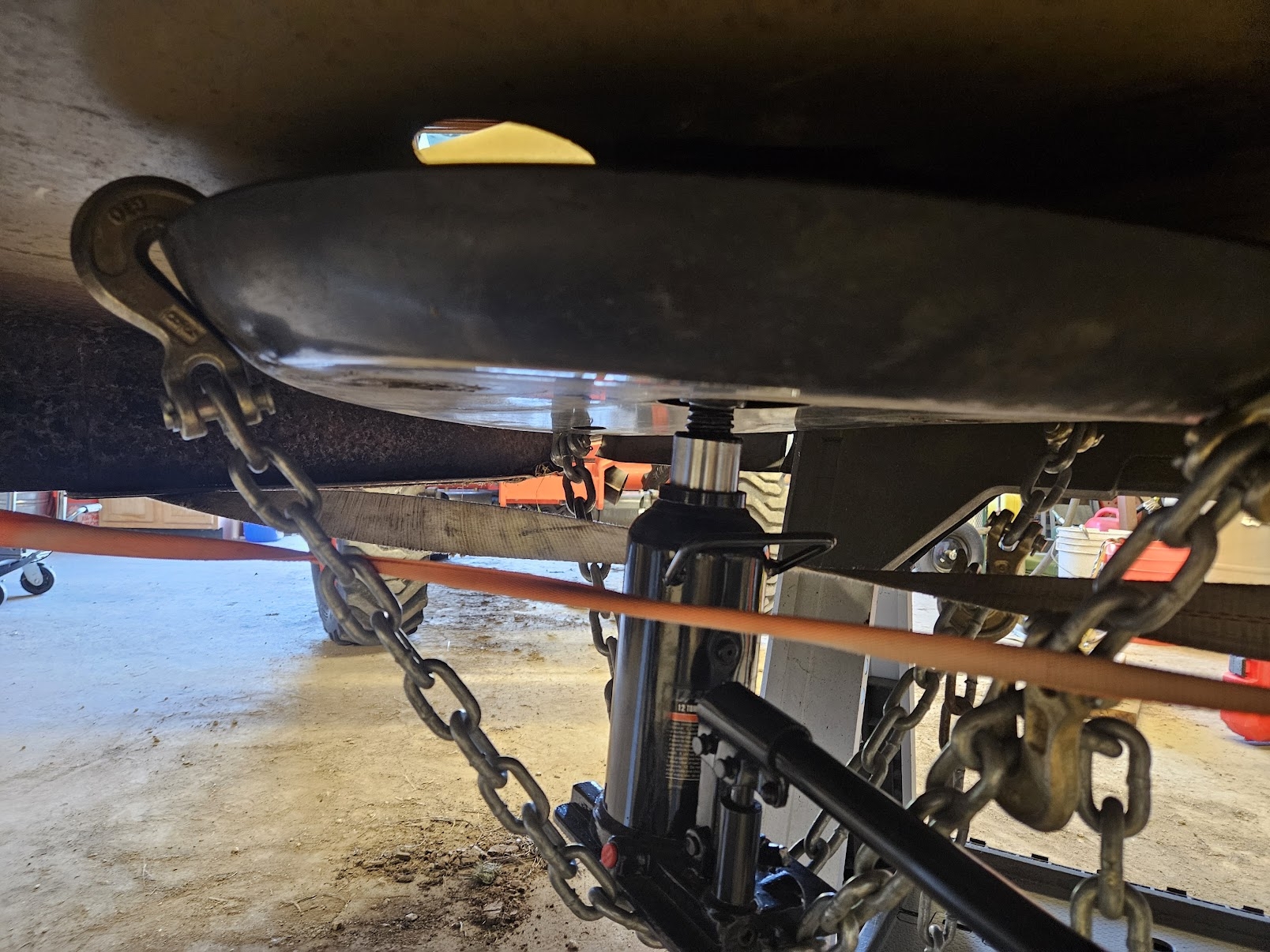

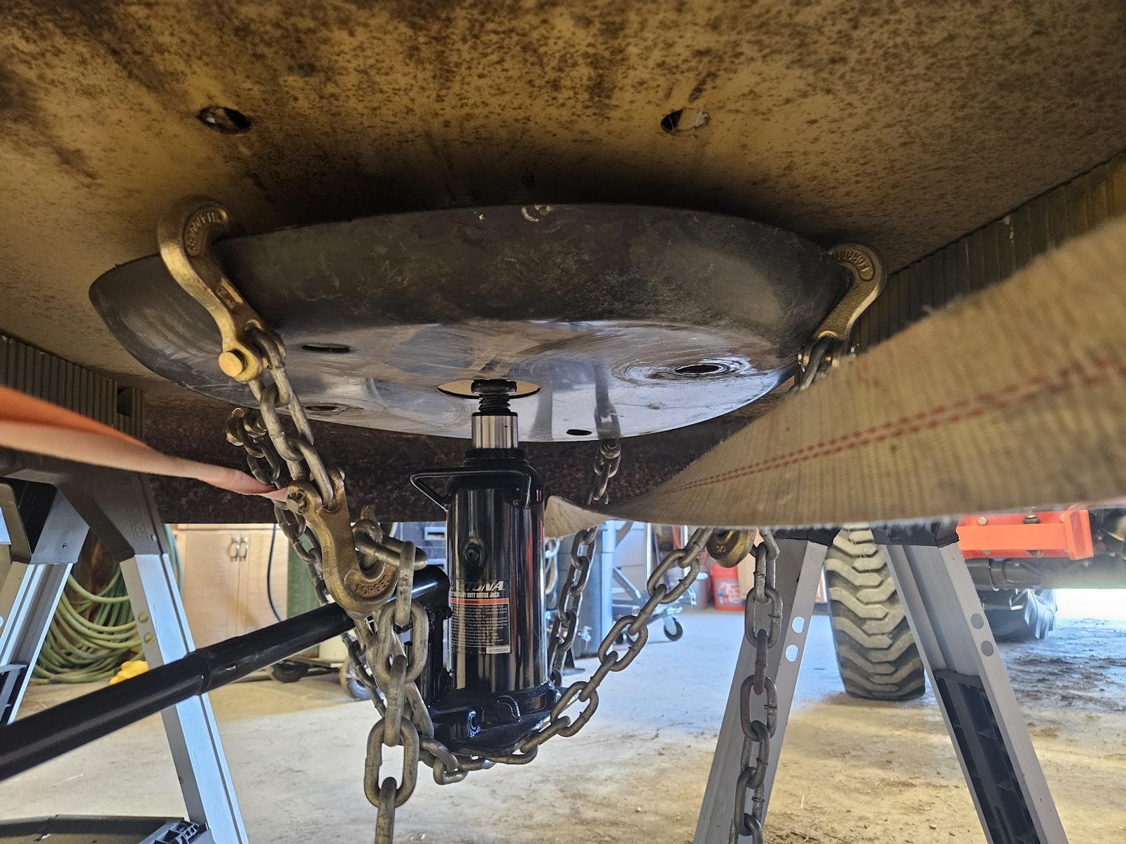

   / Pulling a stump jumper off a Land Pride rotary cutter? #15
I've got a LandPride 1860 rotary cutter with a leaky output shaft seal, possibly other gearbox issues. I got the castle nut off the bottom, but am not able to get the stump jumper off the gearbox. Crowbars, 7' tamping bar, propane torch heating up the outside of the splines, no luck. I can't get a great place to pry as the deck & pan on the stump jumper flex a lot. But I heated things up & was prying as best I could. Beat on theings with a hammer & some rebar as a drift. Flipped it right side up & pounded on the top of the stump jumper througth the big hole for accessing the bolts holding the blades to the stump jumper.
Any suggestions? Get a better torch than my little yellow bottle MAPP gas torch? Porta power that may get under the stump jumper to try & pry closer to the center of the stump jumper?
Sounds like you’ve thrown everything but the kitchen sink at it. At this point, I’d seriously consider stepping up your heat—those little yellow MAPP bottles just don’t put out enough for something like this. If you can get your hands on an oxy-acetylene or oxy-propane torch, heat the hub around the splines only and try to get it red-hot (but not the shaft). That expansion might be just enough to break the bond.
Also, if you have access to a porta power or even a bottle jack, try setting up a centered push from underneath—like through the blade bolt access hole—so you're not prying against the flexy parts of the stump jumper. Some guys also fab up a puller that bolts through the blade holes and pulls down evenly.
Worst case, you may have to cut the hub off, but I’d try heat + pressure before going there. Good luck, that’s a nasty job.
#16
New 3/4" drive socket from HF & an 8' pipe got the blades off.
Sketchy levels of force making the stump jumper look like a pringles chip was not successful on the stump jumper. No heat, gonna try & scrounge up a oxy acetylene torch for my next run.
I'm still not certain if the blade carrier is attached to the stump jumper. Taco levels of force seems to indicate it's welded together. Or at least the stump jumper is rusted & seized onto the blade carrier with the same levels of crud the blade carrier is attached to the shaft. The stump jumper didn't flex where that 1" thick bar stock or whatever makes the blade carrier was, only 90 degrees off.

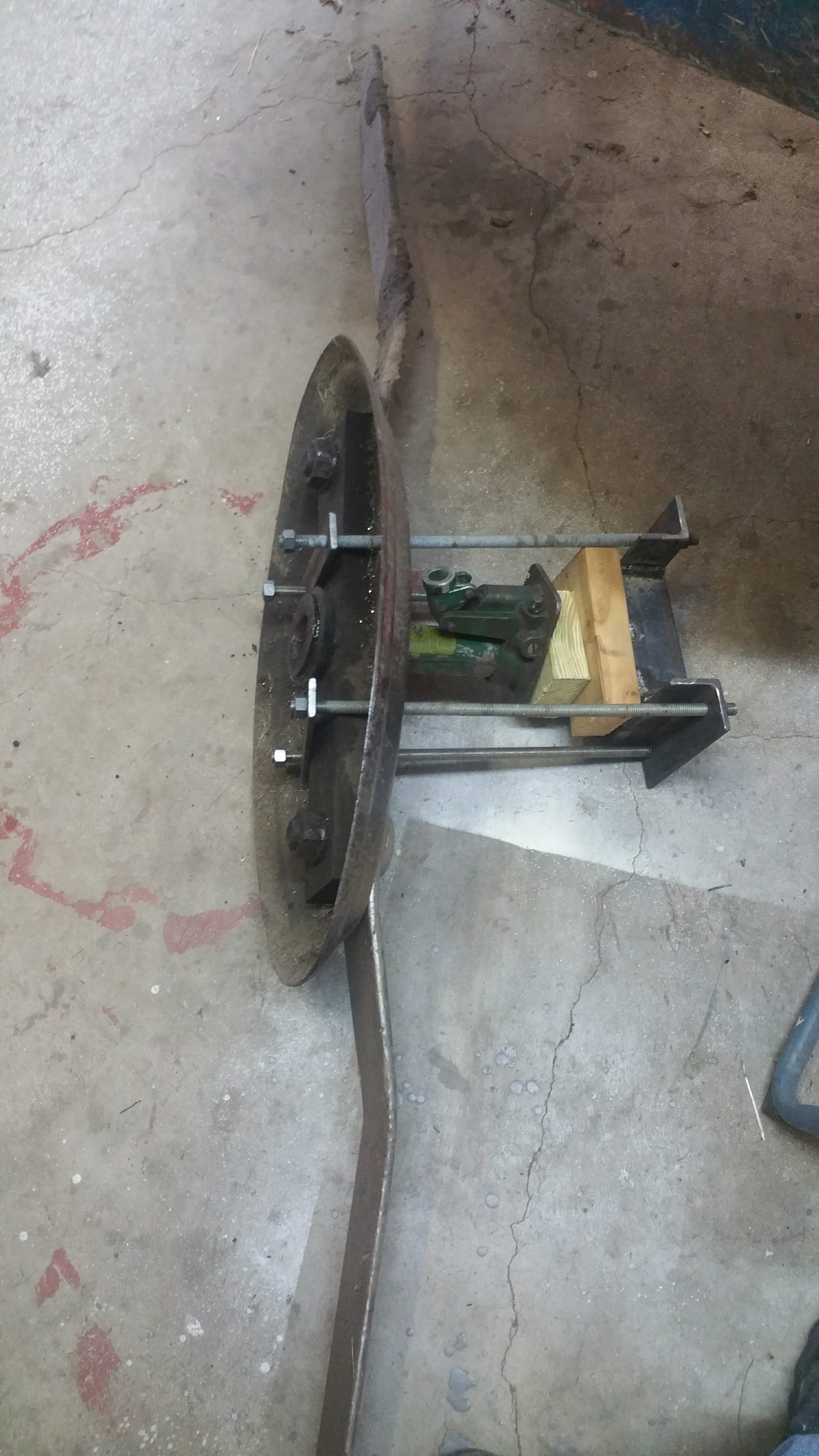

I built this puller to get a stump jumper off that had been on for 30 years. Used a 20 ton jack to break it loose and the 2 ton in the picture to finish. I drilled 4 holes through the pan to allow the all threads to connect to bars behind the rotor bar.
