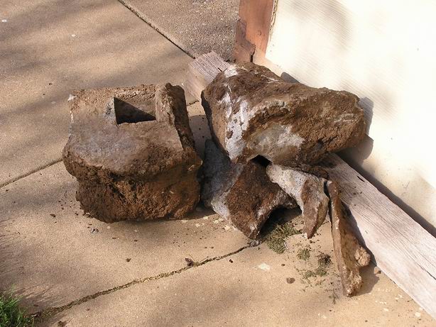

Ah, you are lucky my friend!
Every post I pull (in concrete), the post breaks off at the ground level, leaving me to dig out around it to place a chain on it, then use the jack.
Or do like I did yesterday--take a six foot pry bar and a 2x4 and go after it, prying it, usually in pieces, out of the ground. Yesterday's post was one I had some pros install ? years ago. They'd used their "fast" method: Auger a hole next to the existing concrete, pry the old concrete into the new hole, clean out the old hole, and set a new post.
Pic is about half of what came out the BIG hole I had to make--and it was near the base of an osage orange tree--so I figured I'd shear some bolts or get hung up with I augered it out. But I was lucky--went straight down and didn't hit anything significant.
After digging out one post yesterday, and setting two, I redid my bid sheet concerning post hole digging for my biz!
Ron
