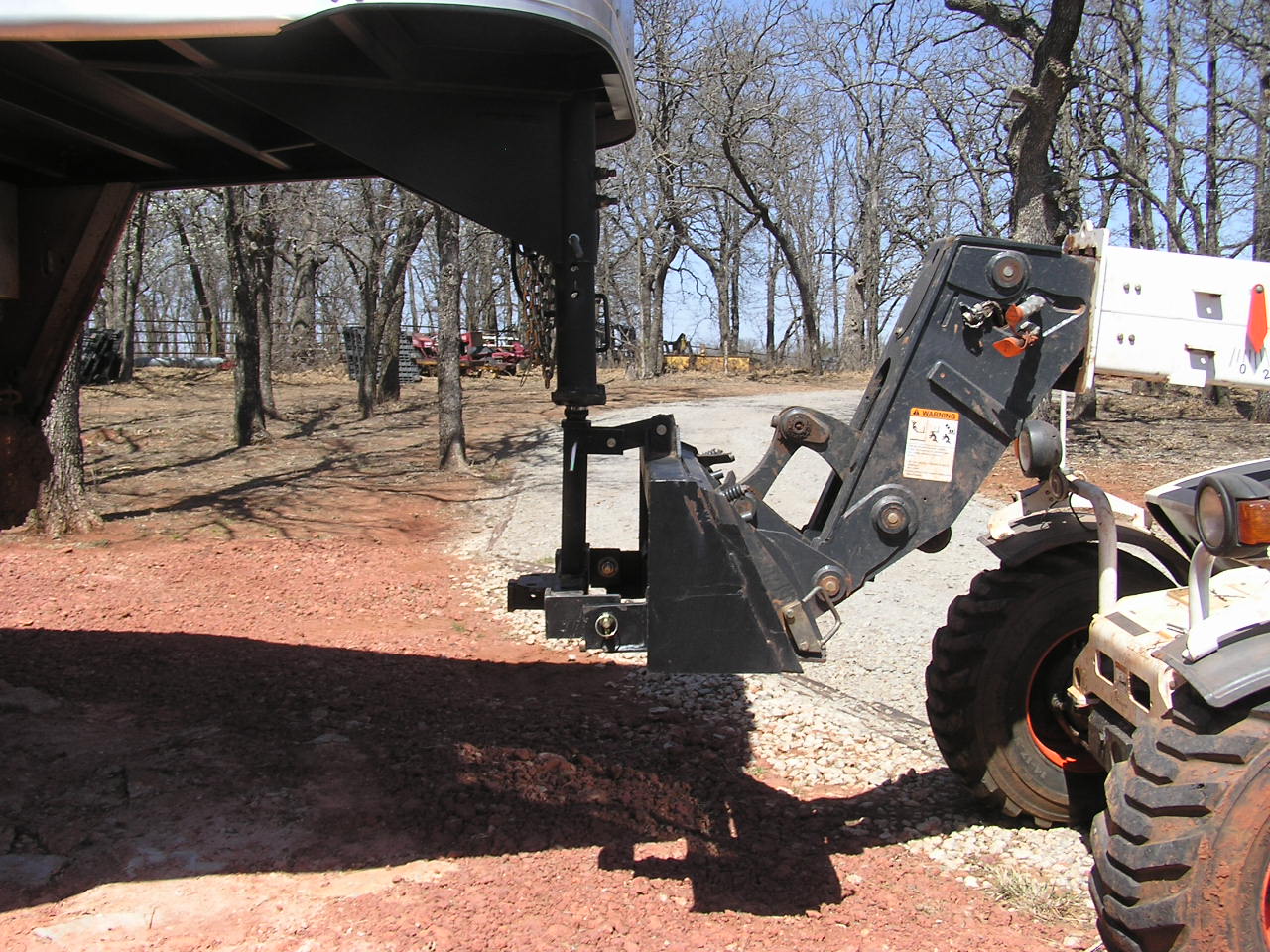

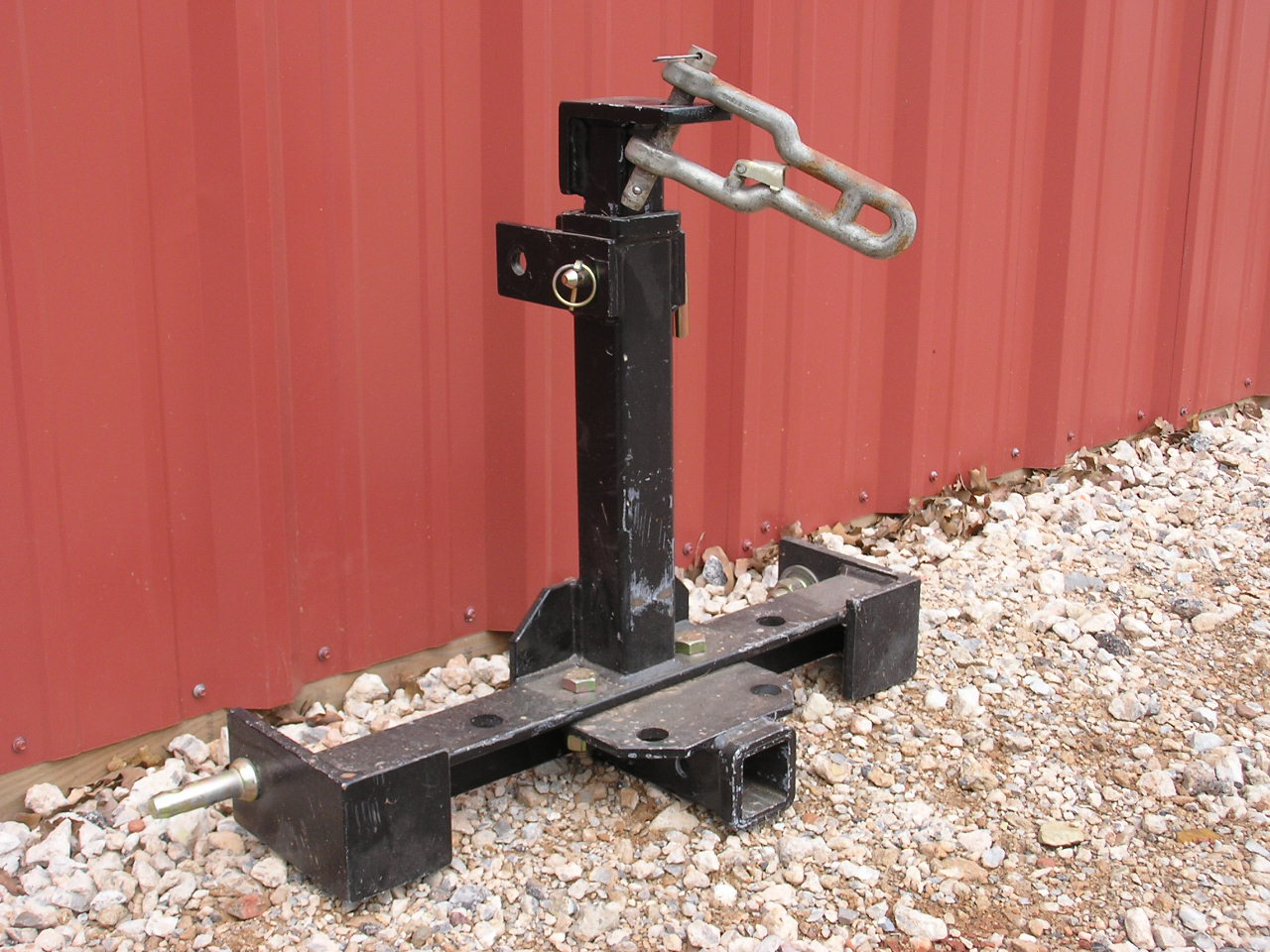

How do you hook up a goose neck trailer to the three point hitch? Do you drop down the adjustable goose neck all the way? Even still you would need a large tractor to be able to lift the 3 point 3 feet in the air to pick it up. No sure I would do this. That's a lot of weight on that 3 point hitch. How big is the tractor you are using? I would think it's over 100 hp. The other question is how fast can you stop the tractor and trailer with a full load?

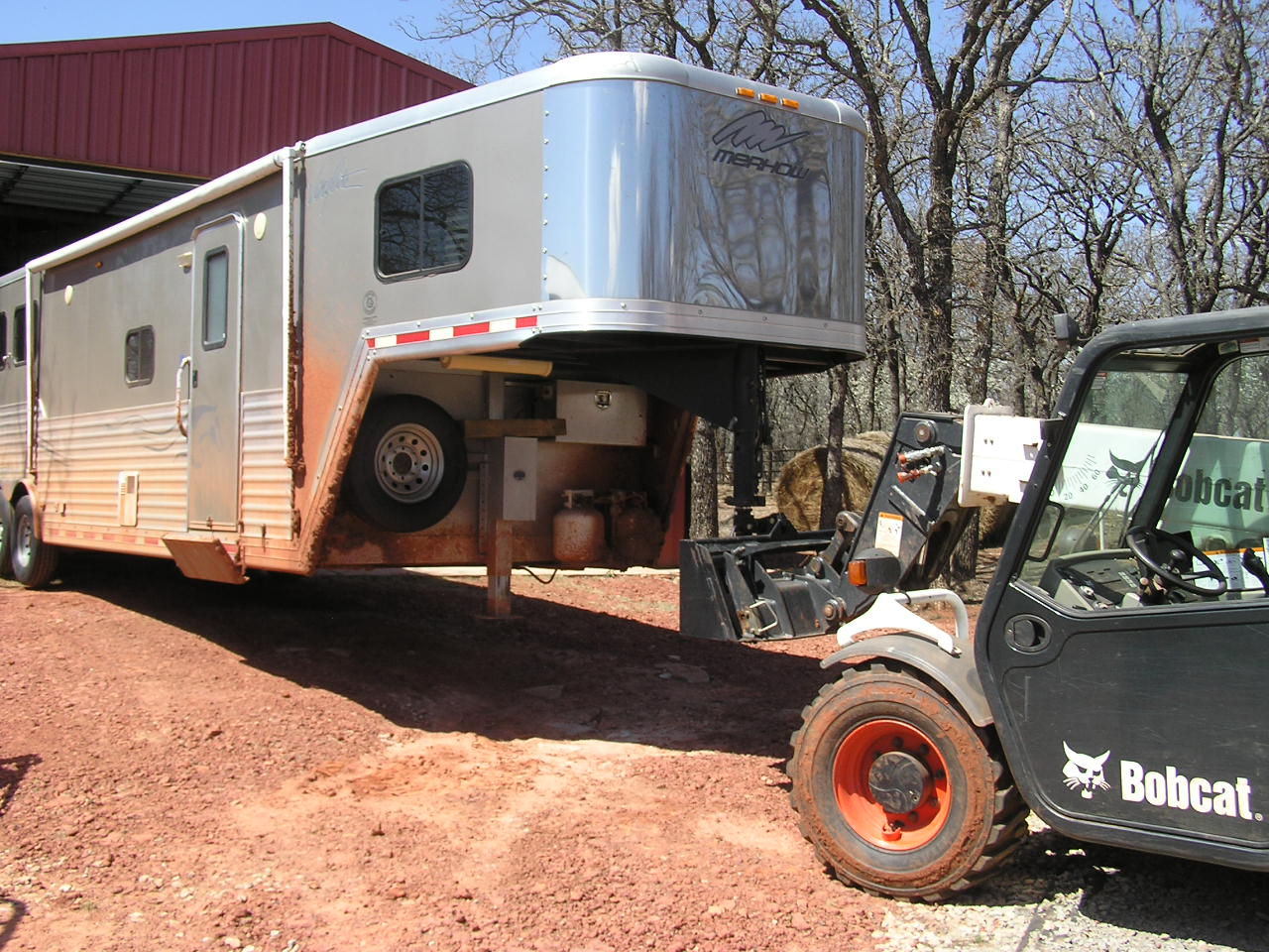

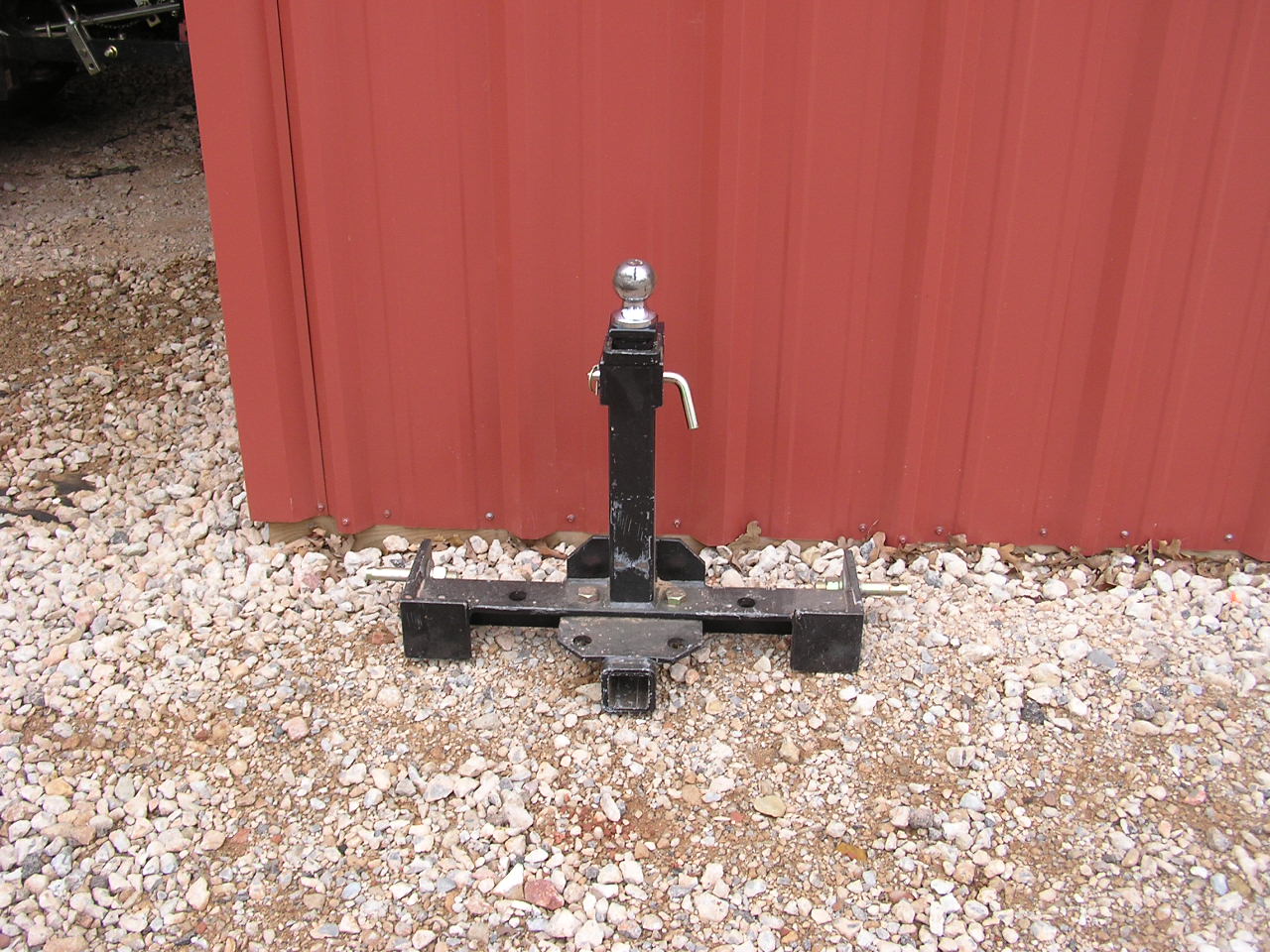

I use the Transformer from Omni: TRANSFORMER Quick Hitch Compatible Platform - OMNI Mfg LLC
3560 pounds on the ball, pulling the 10,480 pound horse trailer. :thumbsup:

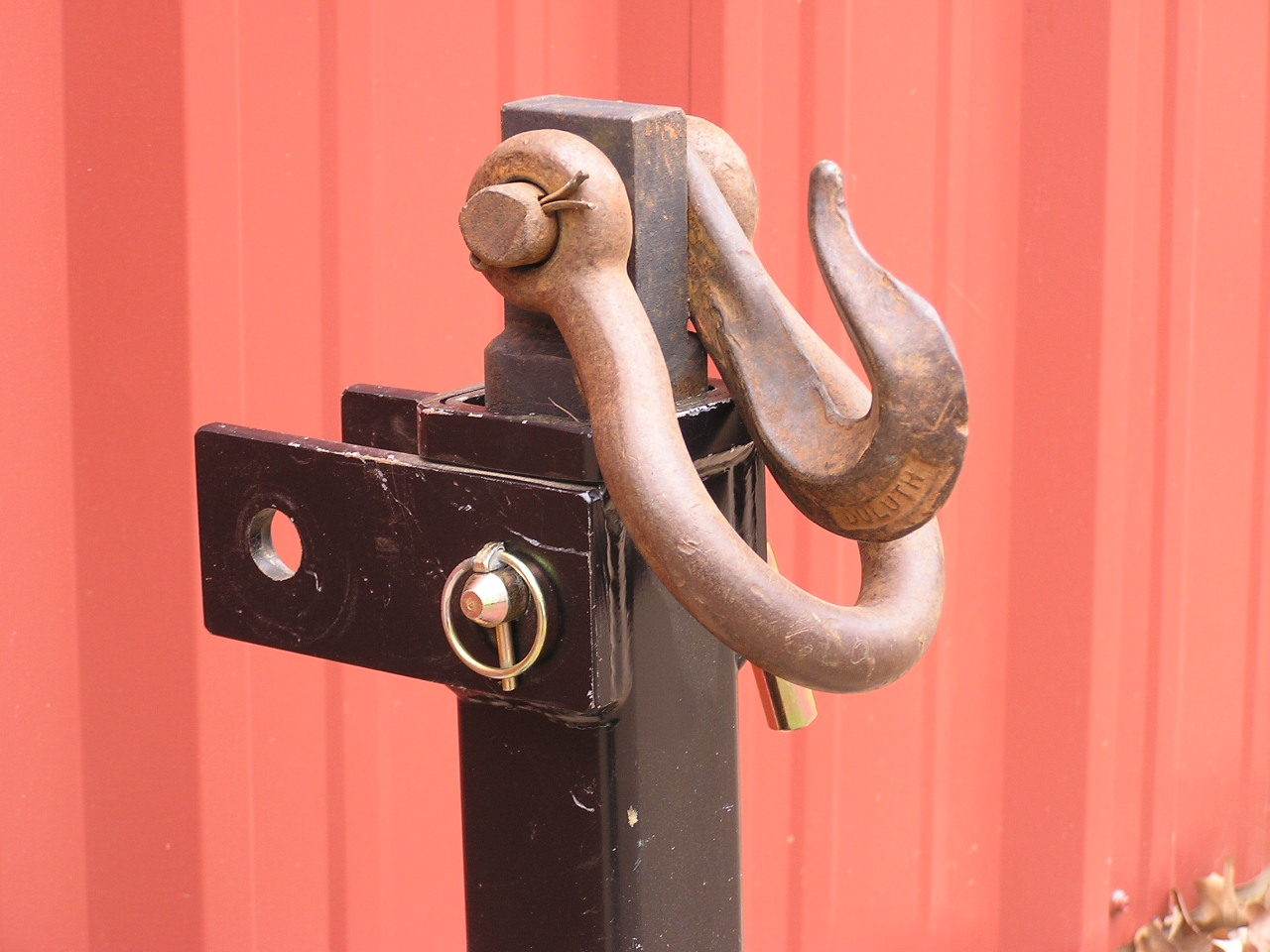

XFAXMAN - I like that mover, I was planning on one very similar using CatII clevis style on the lower pins. I want to use a quick hitch to push that GN away from back of tractor cab, this will give me better turning capability, knowing more weigh out farther requires more weigh on front end. (Tradeoff)
I planned on using 2-1/2 X 2-1/2 ID tubing so that my B&W turnover ball would drop in from the top. Will enforce top tubing to prevent spiting tube. Thank you for the link and the pictures
   / Pulling GN trailer with a Tractor #24
Yep your're welcome, it is a very versatile design.
B&W makes an offset ball, if you need even more clearance. :thumbsup:
