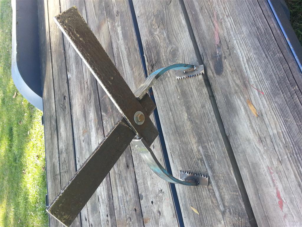

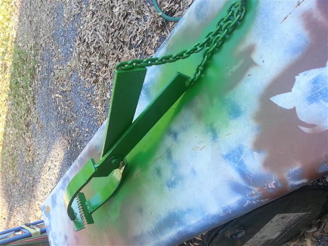

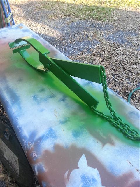

If you were closer I would let you use my home grown post puller.
I call them the Jaws of Joy. I am so joyful when I get the old rotted post out of the ground.

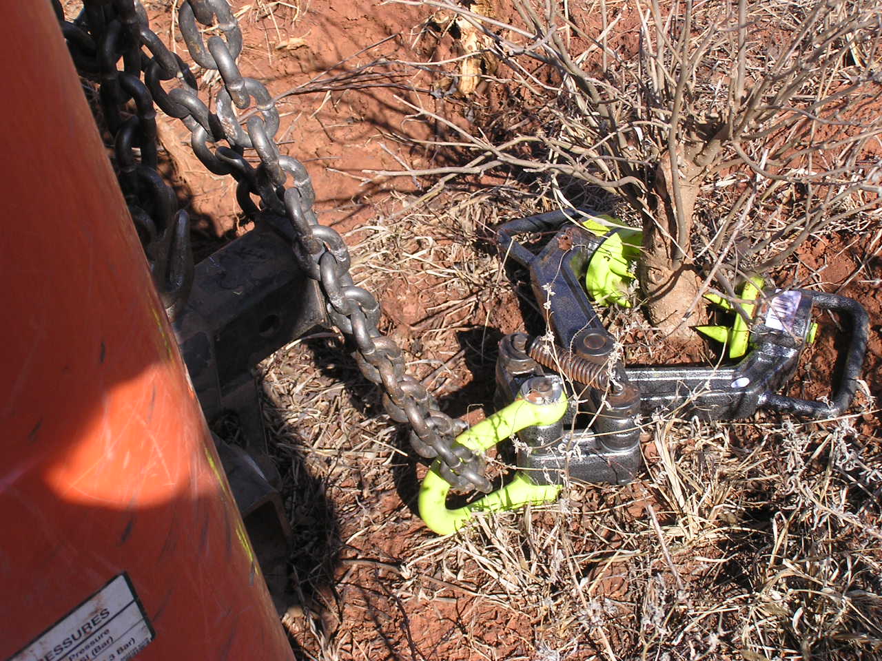

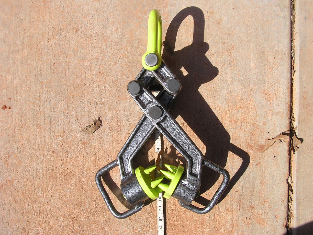

This would do it. The Brush Grubber Xtreme Plus, Model# BG-20.
Kinda pricey, unless you can use it alot in the future.
