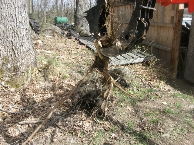

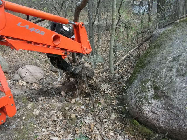

For the cleanest neatest job a excavator with a thumb would be the way to go, bull dozers and track loader's just make a royal mess.
The excavator can pull em up like a carrot, if the ground is dry the roots will come out clean meaning not a lot of dirt stuck to them.
good luck--J
