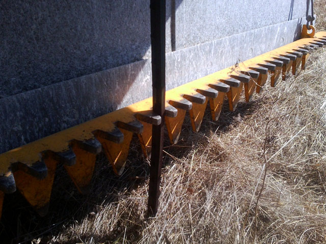

I use my Ratchet Rake. The first time I tried it I pulled over 60 posts as quick as I could move to the next post. Only bent up the first two getting the right angle.

Thanks for some good solutions. Most of these posts are in rock. I don't think holes were drilled for them but just driven into cracks between the rocks. Most are not pullable by hand no matter how much you wiggle them first. The bucket & chain is working OK for now but I do like bcp's idea. I just might waste too much time trying to get the post in the hole. My tractor's not a hydrostatic.
