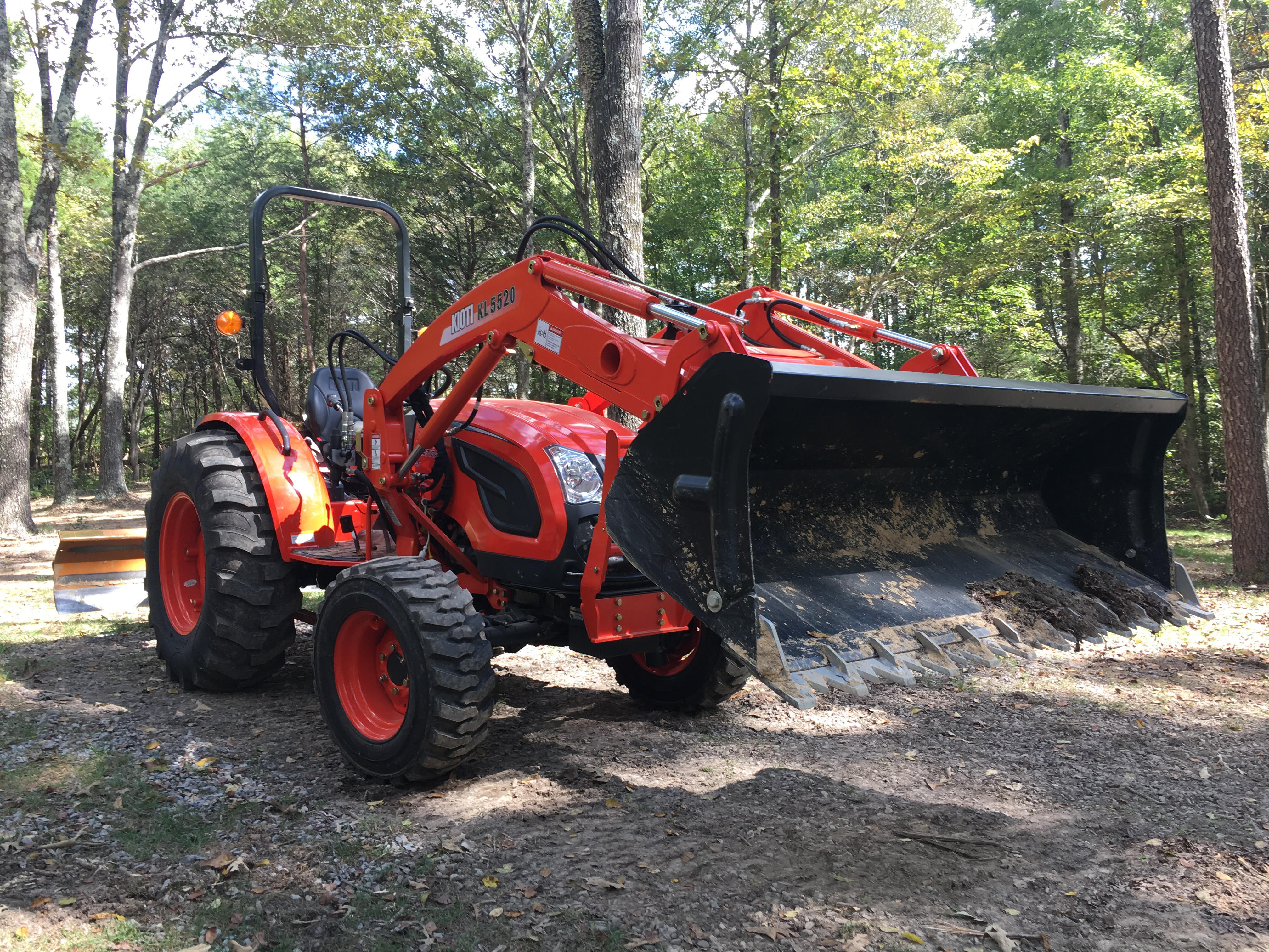

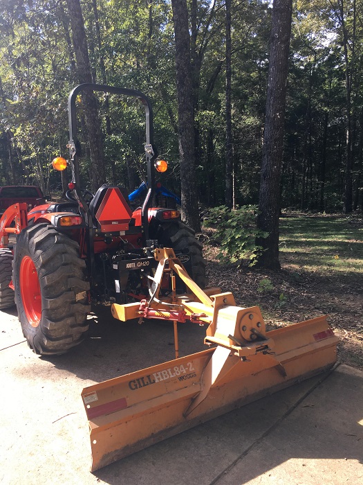

Now we need the proof....I mean pictures.
   / Pulling the TRIGGER: Narrowed Down To Two Tractors
#19
As requested
