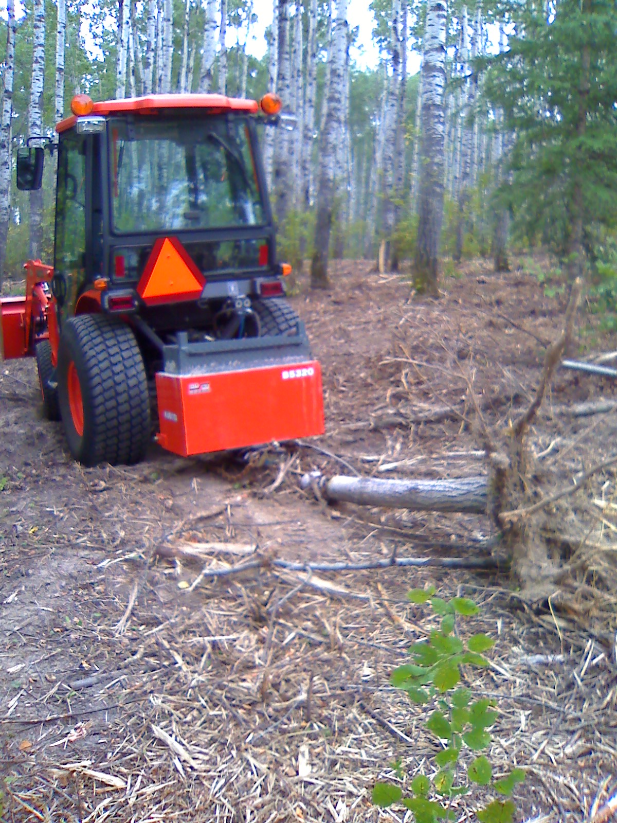

For smaller trees I cut them off about chest high, don't like to use the chainsaw higher than that, then two turns around near the top of the stump and onto a drawbar inserted in the hitch receiver on my ballast box. Leave the ballast box down low and drive slowly away. So far the trees have come out with no drama at all.
Not fast, lots of climbing on and off the tractor but will get the job done with time.
Cell phone photo, sorry for the poor quality.
