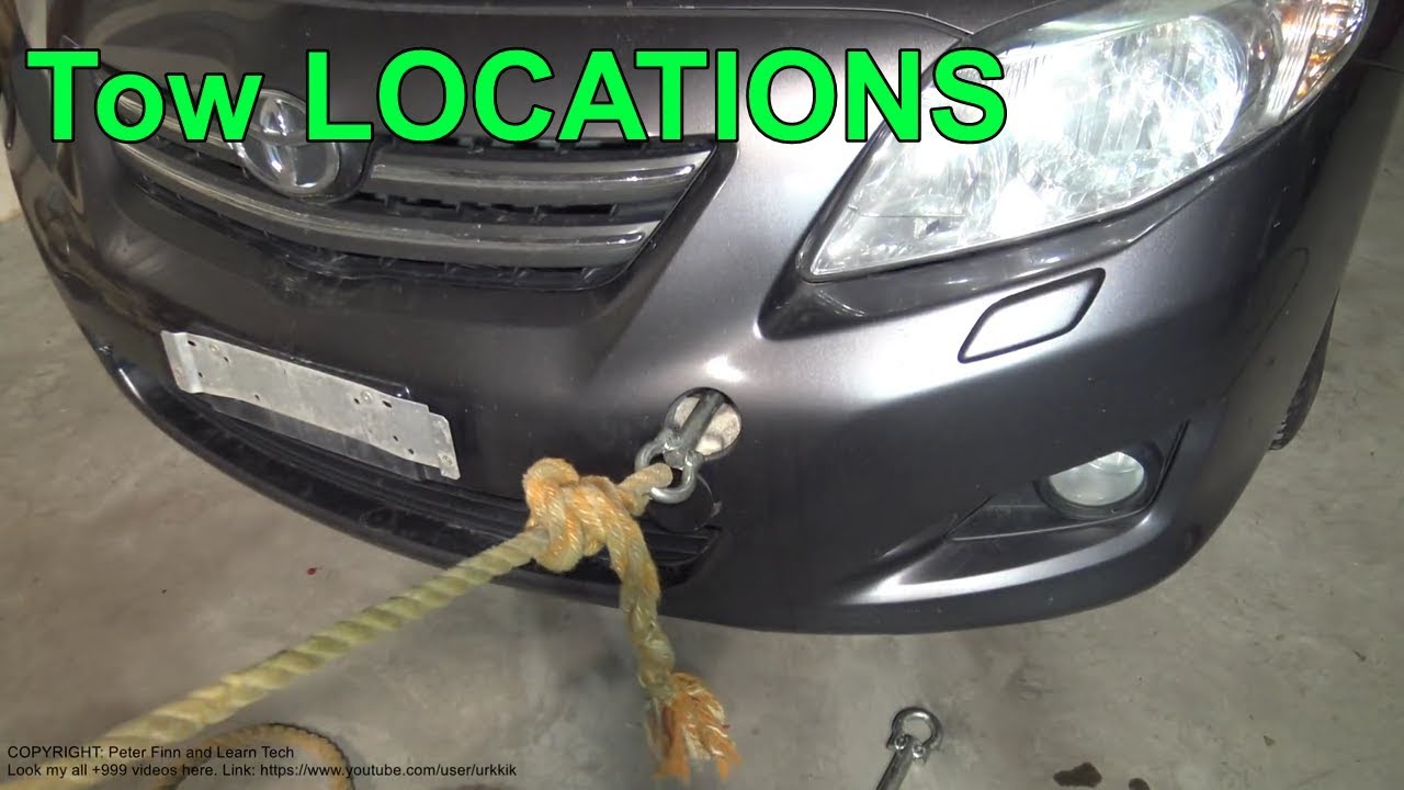

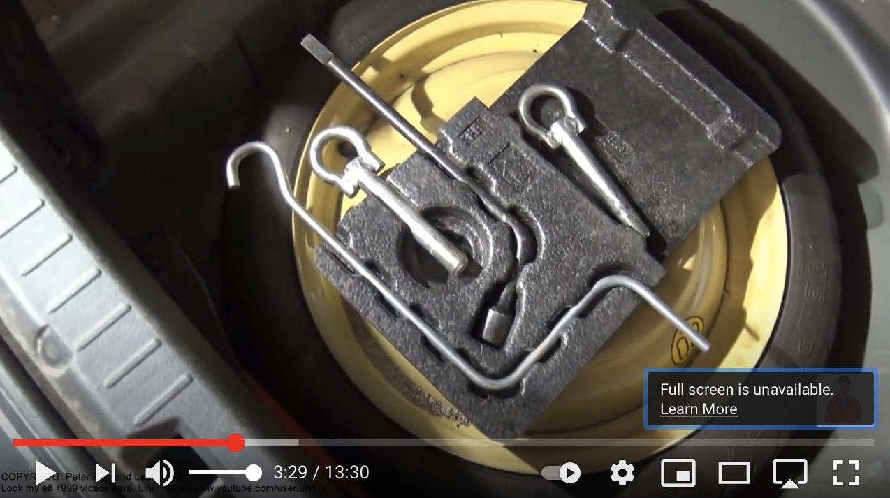

I think most of you may know this, but for those that don't, a lot of cars that don't appear to have tow hooks actually do have tow hooks. You ever see those little cap-looking places on bumpers? You can pop those cap/covers out. In there is a threaded hole. You go to the trunk, access the spare tire, find your tow hooks, screw them into the threaded hole, pull your car out.
4318D288-546E-49DA-8361-4FFC0A7342A5.jpeg 15C7751D-D30E-4232-845A-3E61CF2AB27E.jpeg

Interestingly, I have a 2013 Nissan Altima and it has that little plastic cover in the bumper. It also has a spot in the spare tire foam cover for the threaded hook thingy. But, it has neither a threaded hole behind the cover, nor the hook attachment. :confused3:

Does that car have CVT?
