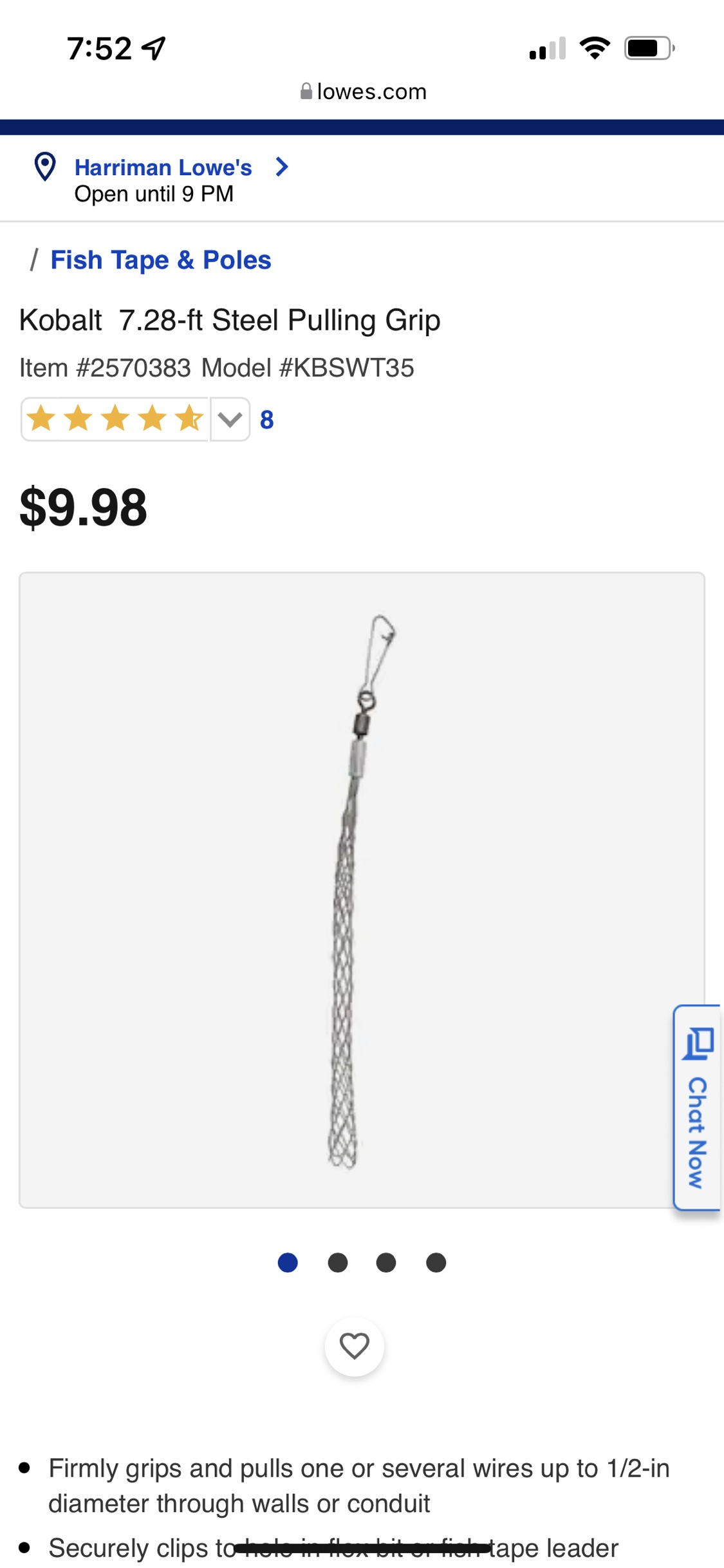

That sounds like a pretty miserable job especially if they’re short radius 90s but they make wire sleeves that go on the end of the wire and pinch it.

Another vote for @MossRoad's suggested method of connecting a rope or tape to the bundle. I don't trust the mesh for anything long or important, but I do use it.
