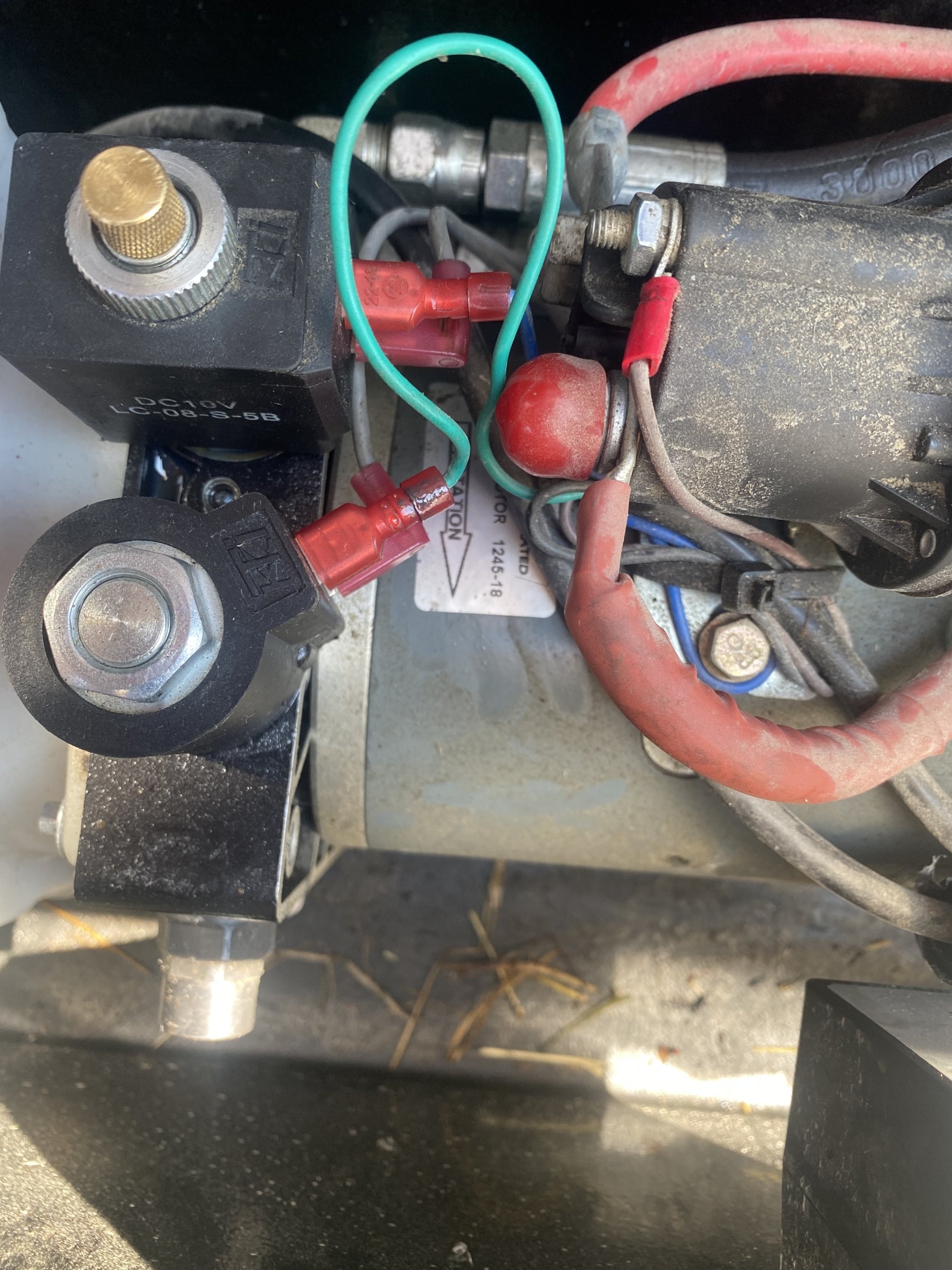

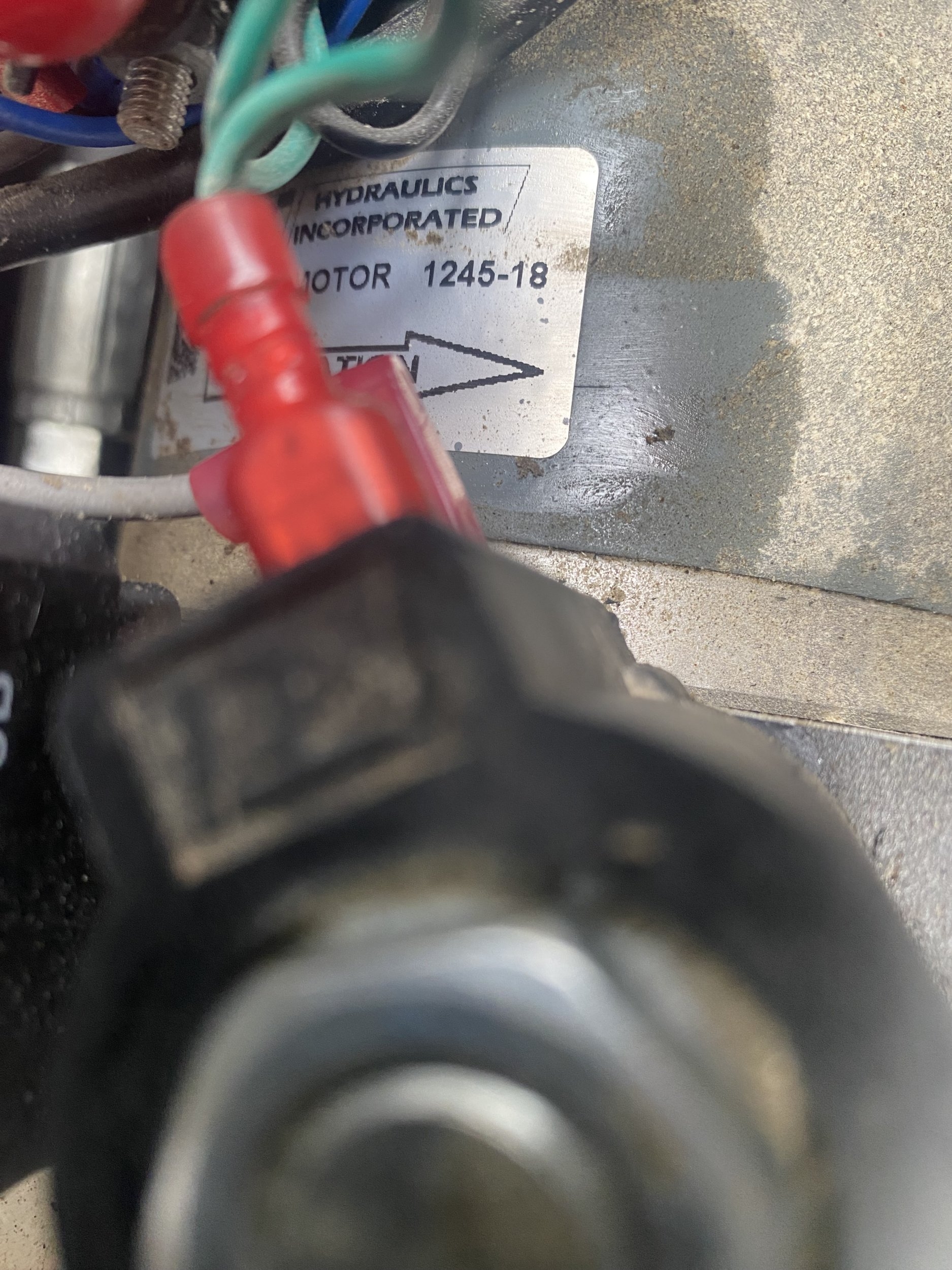

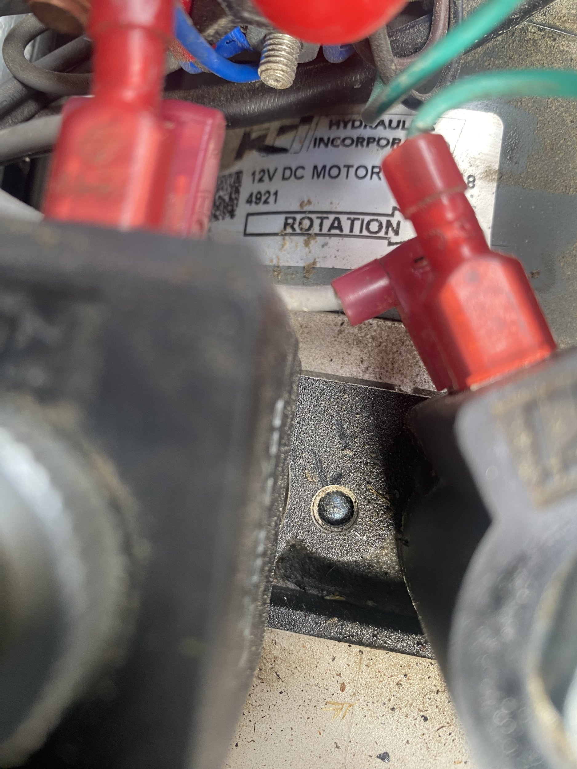

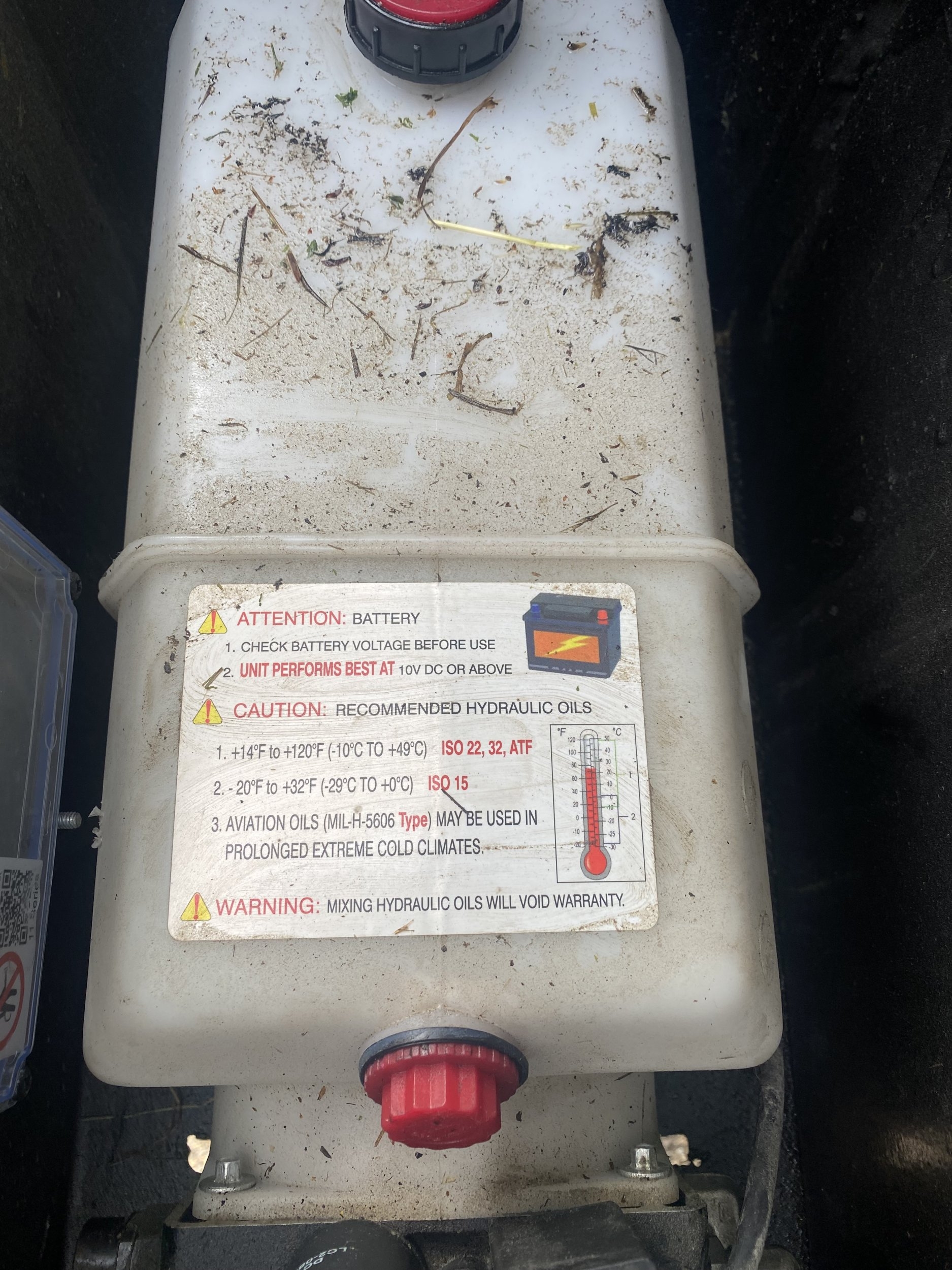

   / Pump upgrade for dump trailer #23
It’s a kti set up. Here are some pics of the tags
