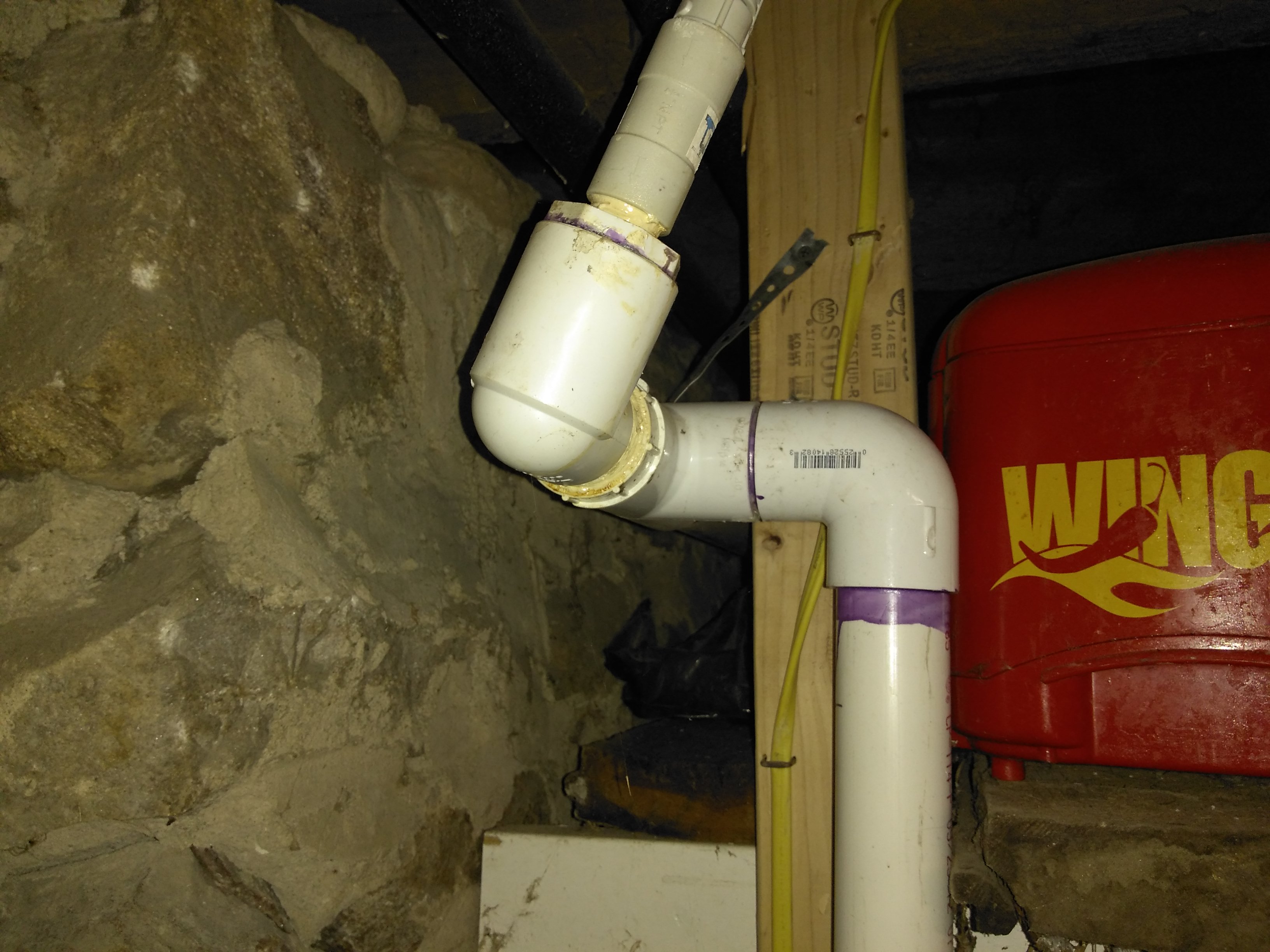

Here is what I did for our house. The end of the drain line is at or above the level of the sump pump so just putting a hole in the check valve wouldn't work. The line comes up off of the pump goes through the elbow, through the tee and outside. The well foot valve let's everything from the tee on drain down, but doesn't let water leak out.
Aaron Z
guess im missing something in the photo, can you explain this better?
yes in all situations the sump pump has to pump up hill at least 7-10 feet

   / Pump water above ground without freezing #13
The line from the pump comes up about 6 feet to where that picture is taken, from there it follows the wall for about 10 feet and then goes outside and down hill. That being the high spot, once the pump shuts off, the footvalve lets air in so that the water drains from there to the wall and makes sure that it doesn't freeze up where it goes out through the wall.
Aaron Z

   / Pump water above ground without freezing #16
Aaron Z
