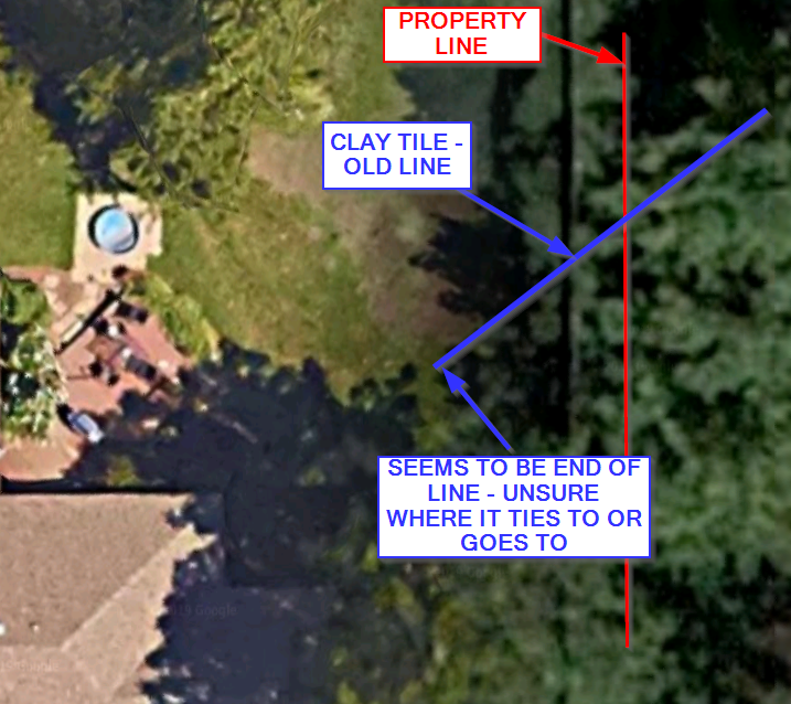

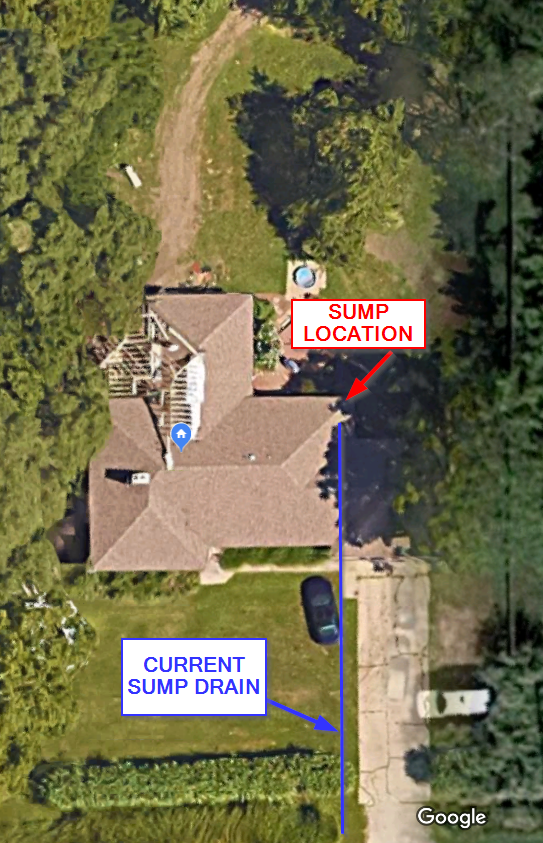

This was from 2015. Was making and addition to the house, that's the reason everything is all torn up.

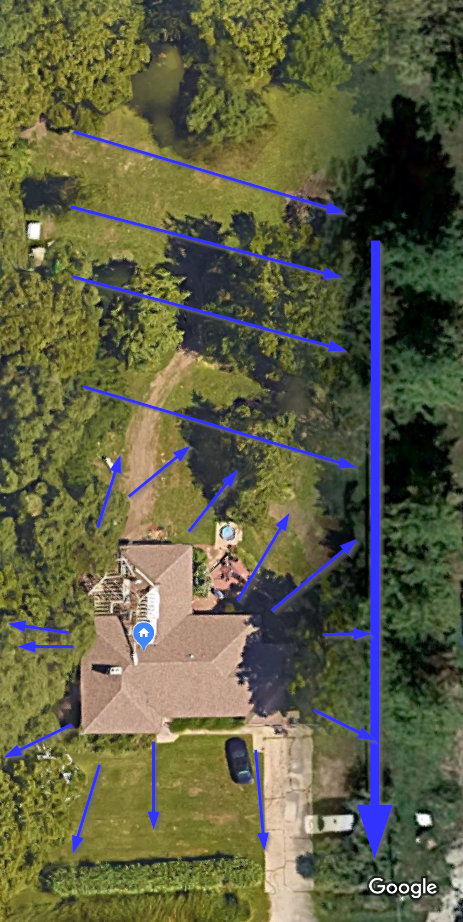

Nearly all the drainage from the lot goes from west to east (naturally) and basically between the properties I've made a path for the water to drain to the ditch. Works great. Like a darn river. I can make one on the north and the west and I'll have a moat during rainy season.

So the building, I would like to put on the north east corner. IFF a pond were to go in the only really okay spot would be on the north west. Pumping the water from the house sump to the pond does not seem favorable. With the pond on the west then I can drain the overflow to the ditch nice and slow. If I can get the flow to the new building site, then going from there to the pond seem more reasonable. However, I don't specifically want a pond, just a volume big enough to run a irrigation pump for 60-90 minutes a night (est. time)

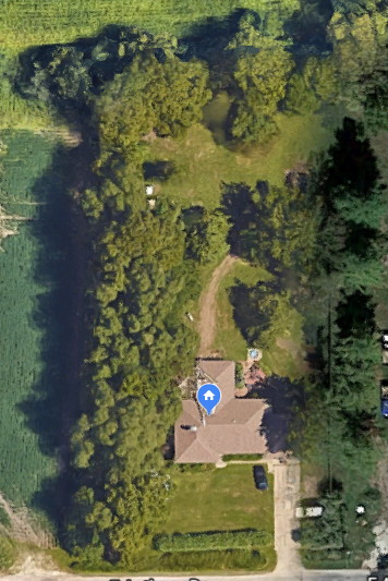

This lot is exactly 1 acre. I did capture some images from satellite last night. I値l get them on when I get a minute. For all you 妬mplausible posters. Fine. Just know I致e been a systems engineer including hydraulics for 25 years. Flow. Pressure. Pump sizing. Line sizing. That sort of thing. Numbers are my thing. BUT let痴 say I知 off by 1/2 just for fun. Now. I have 10k gal a day. What do I do with it?
