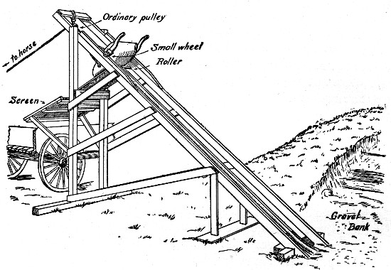

Now imagine with me for a second...if I have some sort of auger attached to the end of the gravel pipe. If I continue to feed gravel into that, it should, in theory force it's way all the way up the hill....no? I'm thinking basically an auger that would fit tightly (but still spin) inside the bottom of a 4" pipe.
Or would the auger need to extend all the way up the hill?
Honestly I would just bring it up in 5 gallon buckets but I can't climb up the hill and cary a bucket at the same time. LOL

Anybody have any idea what a 55 gallon drum full of gravel weighs? I might be able to clear a big enough area for some kind of track up the hill, a steel pipe or a peice of lumber, up which I could winch a drum full of gravel. **** maybe I could ride it too. :)
   / "Pumping" gravel uphill? #16
depend on the gravel and how wet it was also. Somewhere in the 350 plus range.
you could parbuckel it, I have parbuckeled drums of fuel up pretty steep hills with just a couple people.

could you make a skid (or trailer like cart) that is attached to a cable and then pull the skid/cart up the hill with your tractor on flat ground?
   / "Pumping" gravel uphill? #19
A little short of 1000 pounds. Gravel weighs roughly twice what water weighs. Gravel types vary density within a range so yould have to get more specific to close in on a closer weight.

There's a reason quarrys use conveyor belts and loaders. It almost seems like you'd want to look at the way they do mining cars on tracks and maybe figure out something from that. The problem with a 55 gallon drum is loading it on end, turning it over when it's full, and rolling it.
