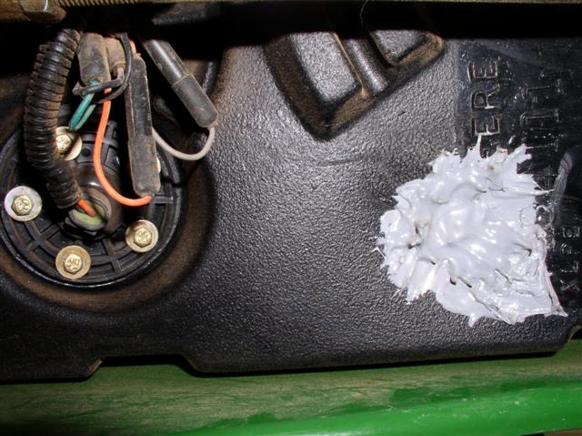

Chris,
The hole is just about as low in the fuel tank as you can get. I removed the petcock you can see in the previous photos and maybe a few ounces of fuel came out.
Attached here is a photo of the repair I made yesterday afternoon. I used Permatex Cold Weld and followed the instructions precisely. I blew out the tank with compressed air until all fuel stopped leaking from the hole. I then roughed up the surrounding surface with sand paper and a wire brush. I cleaned the area with alcohol several times and made sure it stayed dry. I mixed up a batch of epoxy and applied it and let it set. I did this for three applications and let it sit for 16 hours per the instructions.

Here is another shot. Note the better picture quality in these last two photos. It's a lot easier to get a good shot without diesel fuel dripping on you and the camera. /forums/images/graemlins/smirk.gif
I don't know if this repair will hold up or not. We shall see. For now, I'm only going to run with about 5 gallons of fuel at a time and refill more frequently until I am confident it will hold.

I'll add here that the Deere dealer said NO-GO on the warranty replacement for a puncture. Maybe I'll send these photos to Deere and maybe they will armor the fuel tank, pump and other vulnerable items in the future so maybe this won't happen to someone else.
Apparently this is not too common according to my dealer. He said there are no service bulletins and only one other reported incident on the dealers web access page, in which Deere recommended a repair kit they sell for $30.00.
Oh well, live and learn.

As for a repair, JB Weld would be your best bet.
