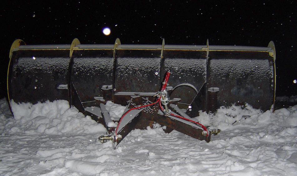

I'm figuring on a rear blade to help clear the driveway (600 feet - plus, gravel), but my bride might have a bird (no offense Bird!) if she see's me spend much more right now, so I'm trying to re-use the old plow trucks snow plow - SEE ATTACHMENT.
I grabbed some category 1 three point hitch hardware; lower link pins and clips, etc. The lower link pins were a snap, and the part of the plow frame that is attached to the plow itself has holes ready to use - abut 25 inches apart, the pins bolted up easily and the tractors' lower links were soon connected to them.
But the upper link can't just connect to the plows chain, this would only tilt the blade - not lift it. So I tried to use a couple of pieces of flat steel to make the triangular frame that appears on most 3PH attachments. After some fooling around, the plow actually lifted off the ground, but the material wasn't thick enough and my triangle now has more than three corners /forums/images/graemlins/blush.gif I didn't think it'd be strong enough - now I know! /forums/images/graemlins/tongue.gif I'll try using angle iron next time.
Decided to pull the thing around as it was, just to see what it felt like: We only had a light dusting on the driveway today, and even the snow in the yard/field is nothing much, but it looked promising. No doubt about it - it is a beast, but I wonder if maybe the weight might actually be helpful/a good thing... Anyway, I dropped it were it wouldn't be in the way and might try again next weekend...

Excellent purchase Bruce, and I like those rear R1s. PoleClimber has the set up for his plow, and maybe he will post some pictures as to how he mounted his. /forums/images/graemlins/grin.gif The QA bucket is a good suggestion.

Any suggestions with the plow would be appreciated. The local hardware store had upper links for $12.40, I was thinking of picking up a pair with some threaded pins and use them to form the frame (the ball-joint ends allow the needed bends). But I think setup that way, they might twist under compression and cause other problems - not to mention cost. I'm currently leaning towards hacking up a piece of angle iron...

Bruce, sent Poleclimber a PM, I'm sure he will respond with a few pics of his setup. I was using the TC48 this weekend, and I too have to fiddle with the clutch, and rock it a bit to go between 2wd, and 4wd, as well as the ranges. maybe due to low hours, and the fluid being a bit cool. I usually keep mine in 2wd, unless I need 4 wd. I seriously don't think you will get windup unless on a very hard surface, or pavement. I believe there is enough slip for your's not to wind up from your pictures on the snow, and ice. /forums/images/graemlins/laugh.gif
