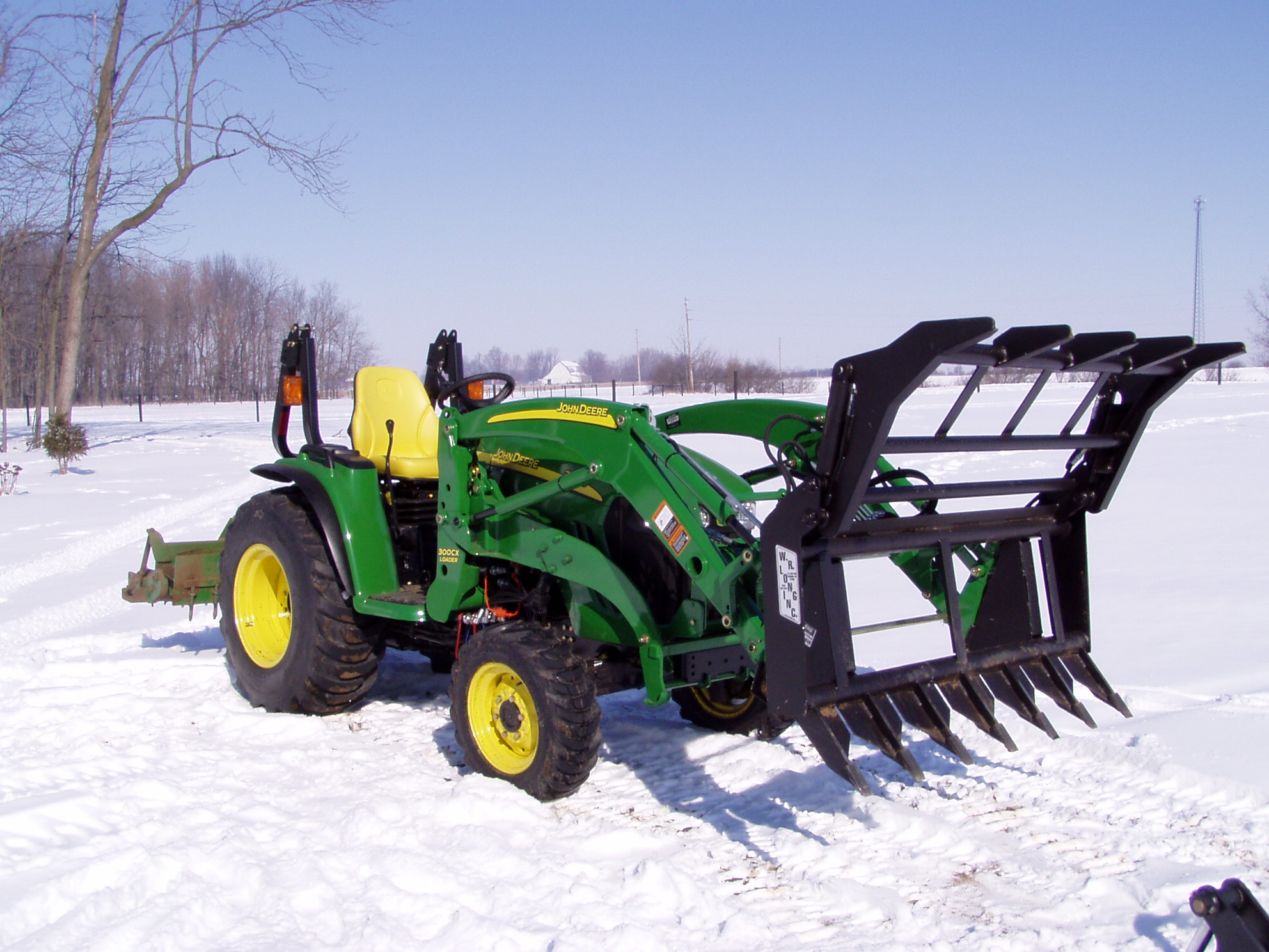

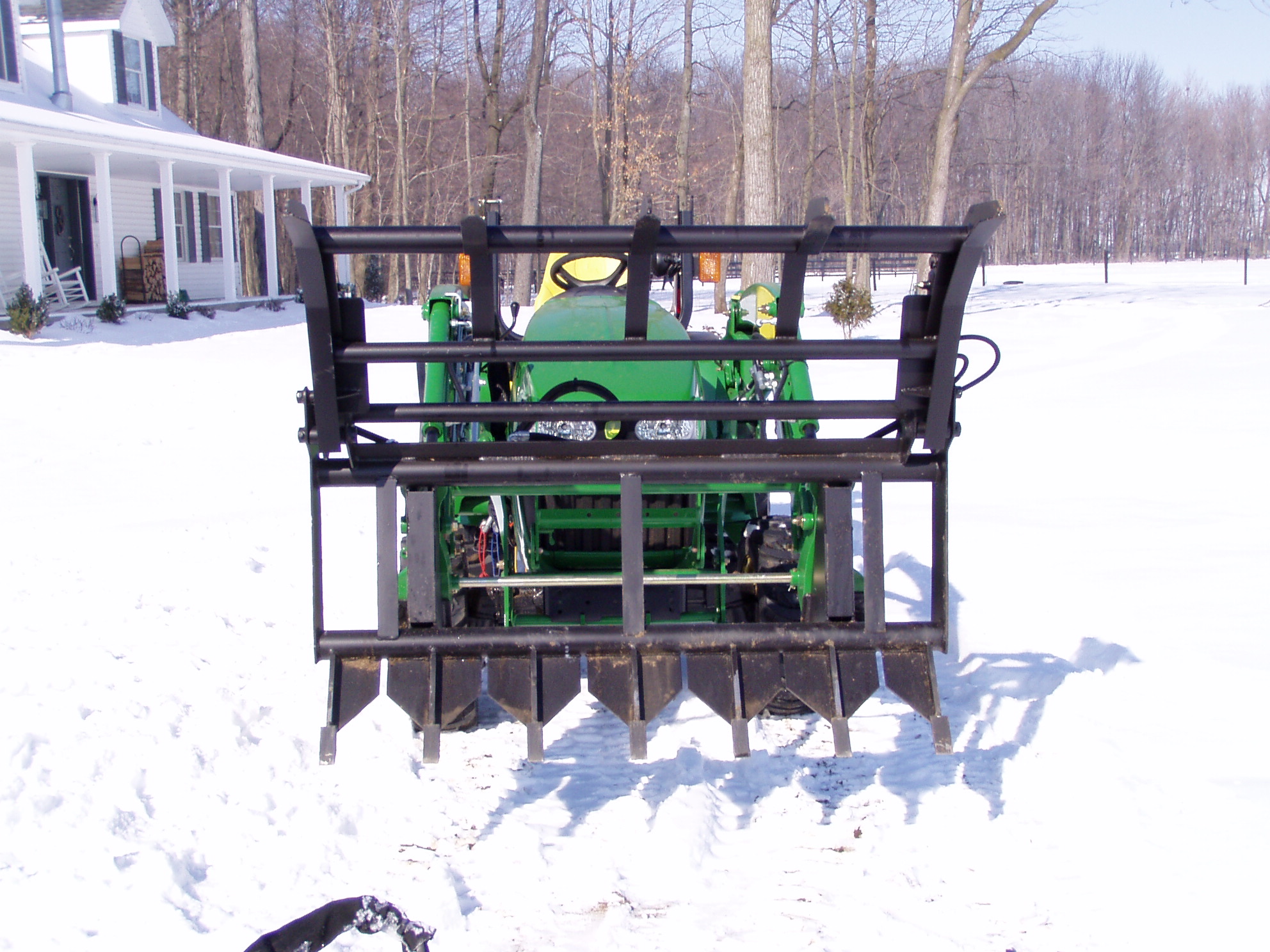

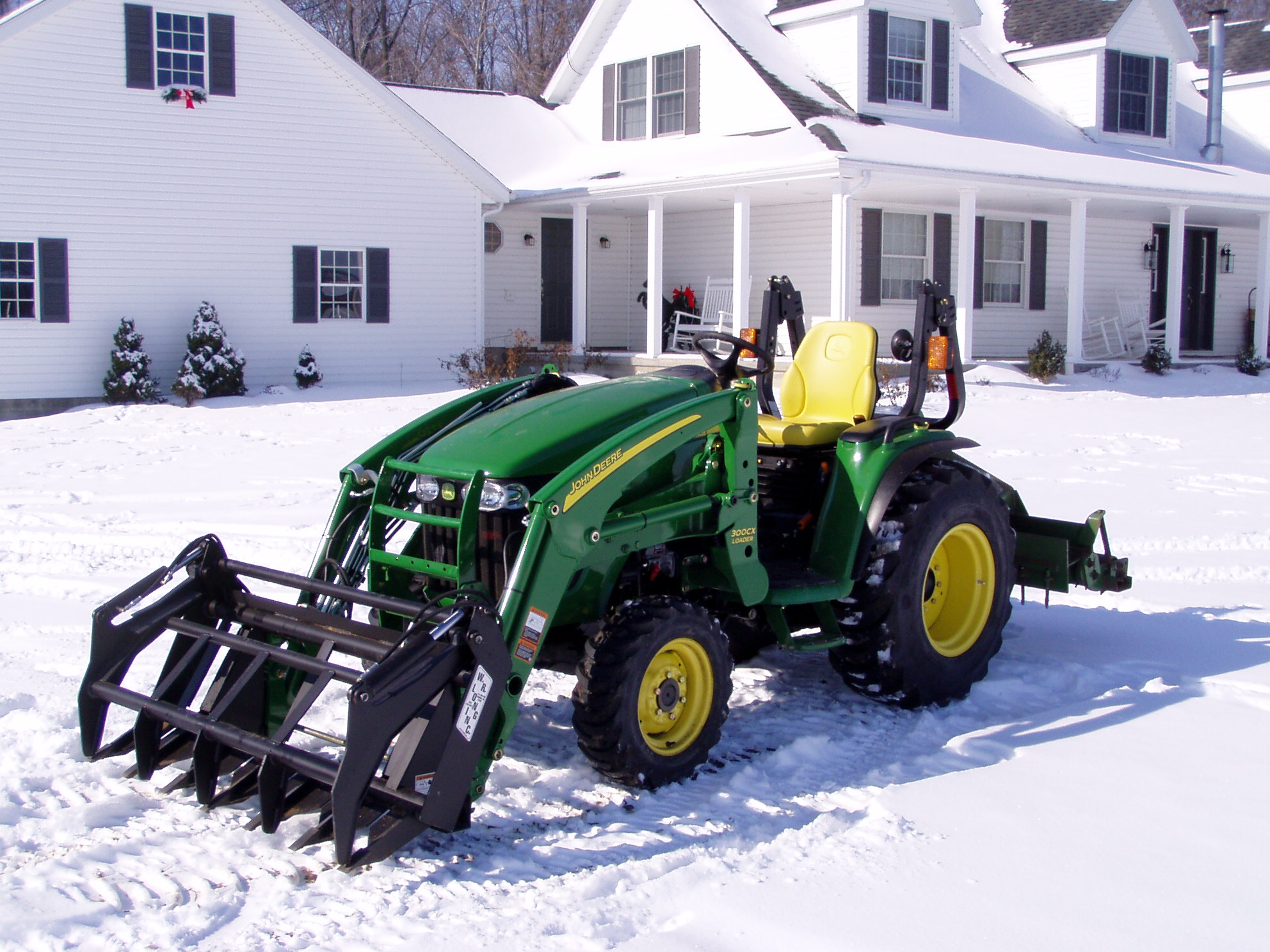

Some pictures of the WR LONG RBG2 60" model I picked up last weekend. The unit is very light at 365 lbs. I can't believe the difference in manuverablity & use from my 4 in 1 bucket.

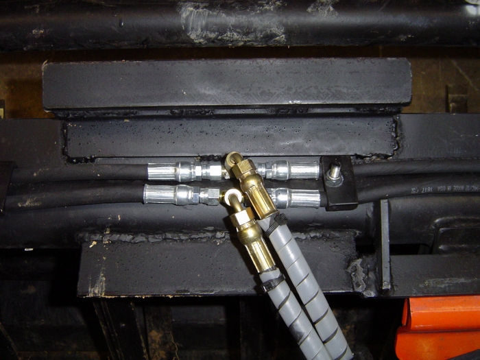

Hi Claykin,
After RPK mentioned about some limbs poking through and bending up part of the T where the hoses link to the grapple, I was sensitive about that spot. While using it, I noticed it was vulnerable, too. I did like he did, and welded a little angle iron on the area to protect it more. Something to think about... Here's a pic of what I did...

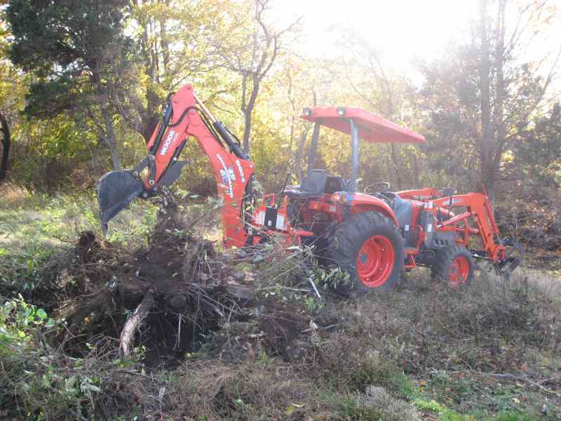

I also have a backhoe. I use the grapple to get any stumps/trees I can as it is much faster than using the backhoe. When I run up against a tree/stump I cannot handle with the grapple alone I use the backhoe to dig it out and then use the grapple to cart it away. The backhoe makes a dandy counterweight when carrying big stumps.
