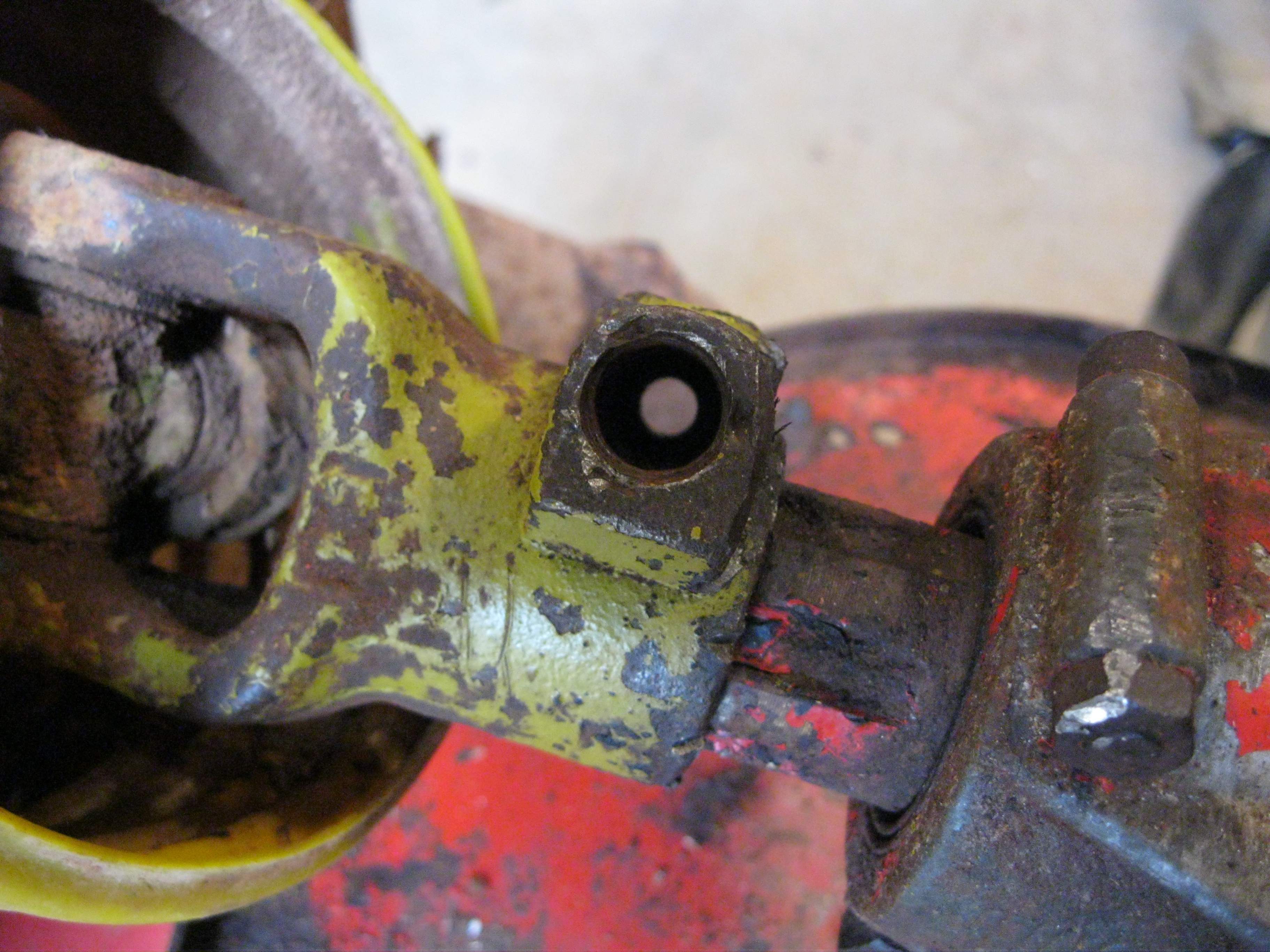

I am still having trouble removing this from pto spline. I punched out the push button, (ws just trying to push in but had to hit with hammer and it all came out). Should this just come off the spline now?? (other than just being very old and rusted on)

Soak the pto shaft with a good rust release while turning the shaft by hand, let it set at least 24 hours, spray it again and start trying to tap it back (and forth) with a smaller hammer (it is kinda tuff in that small area). If it doesn't start moving, soak her again and let her sit, try tapping another day.
Sooner or later, the rust release will get to where it need to be and you will be able to tap it back enough to break it free.
Looks like you may need to replace the U-joint also

Don't hit to hard or you will need to replace the yoke as well. A soft face hammer would help. Ed

It definitely should come apart now that the locking shaft (pin) is gone. Once it moves just the slightest it should come loose. Soaking it with penetrating oil of some sort is a good idea as already mentioned.
Other things to try.
>Tap all around the female joint to try to break the rust bond.
>Use Ed's Red to soak. (1/3 part of each...ATF fluid, acetone, solvent of any kind)
>Sometimes heat, like an A/C torch, will break the rust. Rinse off the petroleum-based soaking solution with soap & water first. Try to keep the heat away from the tractor-side PTO shaft to not damage the seal.
>A crowbar wedged between the tractor and the joint might be used. Be careful.
>A chain around the yoke and a come-along can put enough separation stress on the rust so that tapping will slightly move the yoke on the splines. It will then come off.

The buttons on mine (3) are held in by a slightly oversized lip on the button. Basically, a press fit that taps into the button bore. I made a new button for one of the yokes and the lip diameter was critical. Your button should tap back in ok. I've seen some with a clip or small cotter pin on the end of the spring plunger too.
And yes, the yoke should come off with the button removed. Don't try to hammer it off or you'll blow the shaft bearings. If need be, remove the cross from the yoke and use a screw-type claw or bearing puller. Keep soaking!
Added: I hope you bought the tractor that way because that is total neglect to let it freeze on the PTO shaft.

Sometimes it is not all rust. It can be a combination of grease and dirt on the spline and the PTO shaft. I have had luck separating the shaft so you have something smaller to work with. Soak down the connection for a day or two then tap the shaft toward the tractor. Once you get it moving, re coat the spline and see if you can work it loose. Make sure you clean everything afterward so you don't get to do this again next time.
/ push button release yoke #20
Check to see if the push-pin is bent. If the PTO shat is too long, then it will psh the yoke into the tractor which can cause the pin to bend. Then it won't back off without jamming.
From the pictures, though, it looks like a high crud factor from rust, dried grease, and dirt mixed with leaking transmission oil has caused your problem.
