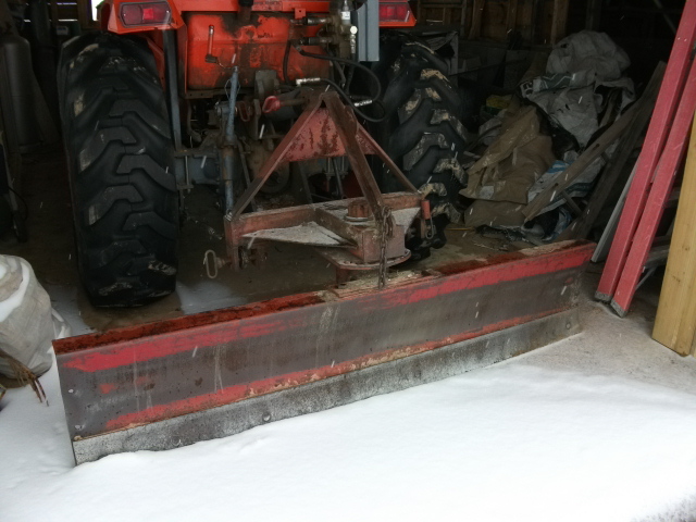

I find incredible efficiency moving snow with my FEL going forward and 3PH blade going backward. The 3PH blade clears better in reverse.
I am more careful when plowing in reverse if only because I am struggling to look behind me.

I push with my back blade in reverse. Keeping from packing the snow down with the tires ahead of it.

The bottom line, is the 3 ph arms are not designed for "pushing" although many get by doing it.
They would be designed differently (IMO) if meant for pushing, and would be built more like the boxed beams of the FEL.
So, it is a risk to the user, thus the good word "caution" is mentioned several times. That means, IMO, if it breaks, you just were not cautious enough. :D

Thirty years ago I ran a blade service with a Ford Jubilee w/7' rear blade and a Ford 861 w/8' rear blade. I kept extra lower arms for each. Broke at least two per tractor each winter. Would break them at the bolt hole where the lift link attaches to them.
When you have pushed out twenty or thirty strange driveways and a dozen business drives over a period of 10-12 hours "caution" kinda goes away. :)

Like BigDad, I often push snow in reverse using the convex side of the rear blade. Half the driveways I do are gravel and pushing with the backside of the blade is much easier on them. If I hit a half-buried stone, the blade rides up over it without transmitting a big shock to the tractor.
The other thing that I do that helps (I think), is to tighten the turnbuckles on the lower lift-arm stabilizers as much as possible. This takes all the slack out of the 3PH mechanism and does not allow the blade to shift side-to-side even slightly. The intent is to make sure that both sides of the 3PH bear some of the shock from an inpact when pushing, rather than to have it concentrated on one side alone. This may or may not be helping as I'm fairly cautious when pushing in reverse and have yet to break anything.

Exactly. This is a compression buckling weakness of thru drilled lift arms made from stap iron as they seem to be these days. However 50 yrs ago at least some of them were made from undrilled box section tubing. Virtually indestructible in either direction. - - There you want to look for adequate strength at the tractor pinned connection. My 2010 has telescoping lift arms so constructed.

I hadn't thought about it before, but my back blade (using it now for snow because of angling vs box blade- snow too deep) has a few pins in strategic locations.
One of the pins holds the rotation position of the blade and I've sheared off the old one, a "new" old pin, and bent a bolt used in its place.
All happened in a few moments when hitting something in the snow. A concrete pad, an unexpected bank (dirt, not the $$ kind), etc.
I also remember from years back we would use an extra set of flat bars on the bottom pins when hooking up discs and plows. I always thought it was primarily to control the sway, but would absolutely add strength to the lower arms.

Yep, all the little Fords used them. Their intent was to control sway of an attachment such as a 3pt planter, kept it inline with the tractor. I used them when pushing snow to control side sway of the rear blade. Still broke 3pt arms and bent the sway bar.
