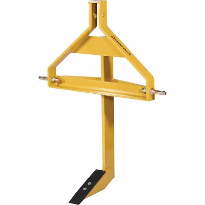

We recently got a single tooth ripper/subsoiler which does good of ripping out tree stumps.
It had no problems with 4" stumps (or 2" roots on larger stumps) when pulled behind our L3830.
CountyLine Subsoiler at Tractor Supply Co.
We did have to replace the lower link pins as the sleeves slid up and were sloppy.

Not sure the lay of your land but I would thing some kind of ripper would do better...be gone once and for all... just go slow.

If you had left 6 inches to a foot of stump sticking up the attachment* I made for my grapple would pull/lever them out in seconds all from the comfort of your tractor seat. No getting off to hook up brushgrabbers or 2nd person needed. BUT since they are flush with the ground, you are going to need something to get them up out of the ground. ripper/tooth, potato plow. something.
