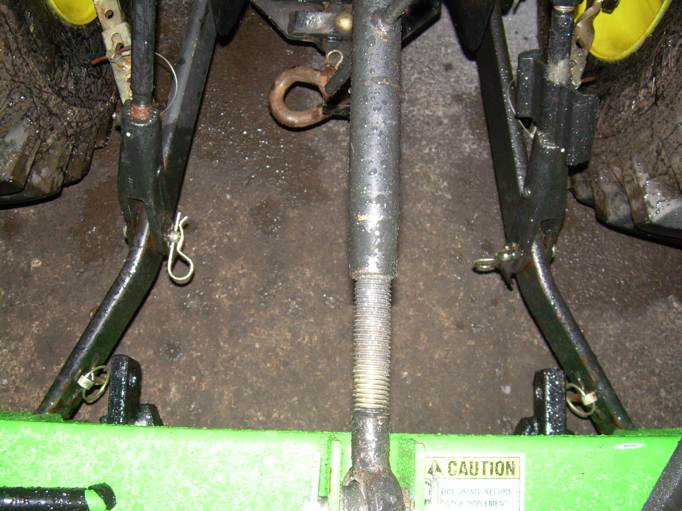

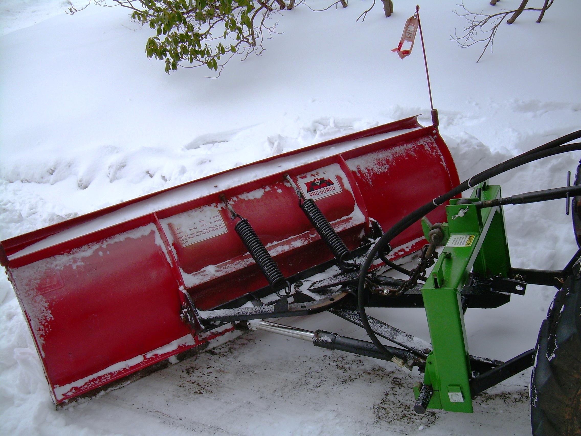

It really is just the lift arms or draft arms, what ever the proper term is for them, that are the weak link. There should be a way to make them capable of pushing what ever the tractor can throw at them. something like a trucks front plow frame.
Many of these implements are designed to be used in reverse, so no one can say you should never push with your 3 pt. I agree with the snow blower it's kinda pulling itself with the auger, but boxes and blades are designed to push as well as pull the tractors 3 pt systems should be built to handle it.
The rear of the tractor is known to be the heaviest, seems like all that's needed is to make the arms a little heavier.
I installed a truck plow on my 3 pt this year, and as great as it worked I couldn't recommend it to others here in good confidence for 2 reasons.
First, I think I did bend one of my arms a tad, almost not perceivable, but I was ramming snow banks with it, something I said I was not going to do. The rear plow was originally supposed to just be for cleanup after the front loader but it became apparent the the plow was so much quicker and I just used the loader to manage the banks and piles made by the plow.
Second, I thought I might take some heat for making such a recommendation that many here believe to be unorthodox or destructive.
So I won't recommend it to others but I will keep pushing with mine, My lift arms are pre bent right at a critical point making them vulnerable to further bending, just may reinforce my lift arms and be a little more respectful of the geometry.
JB.

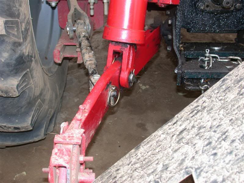

I personally don't move snow but do a lot of ground engaging dirt moving with my box blade. I've learned to be careful and try to push already loosened dirt by pushing in reverse. When I pushed really hard dirt and boulders, I bent those links. Here are a couple photos of the designed bends in the links on my tractor, and also of the bent ones.
Since I really wanted to use the pushing in reverse feature, I ended up reinforcing my drag links. I used a couple old 3/4" thick scarifiers and welded them to the bottoms of the drag links once I straightened them out. they are welded with heavy gussets and now the links form a "T" with the reinforcement on them. They are much stronger now. I do a lot of bulldozing in reverse and since this modification, I've had no problems of bending, nor has the tractor mount (for the links) suffered any damage. I still try to watch how much force I use pushing in reverse since my tractor is 55hp and weighs about 8,000lbs loaded. I still advocate using the implements in reverse since there are great benefits from such use. Just be sure you have the reinforcement and watch what you are doing and never slam into your object pile. That goes for going forward or reverse and for FEL use as well.
I know I'd seen that type of reinforcement before, don't know if it was yours or someone else's but that looks like the best way to strengthen those arms without interfering with the range of movement or accessory placement on the 3pt or PTO.
I'm gonna do the same thing.
Rob-
Rob - nice work!
We all do it (reverse plowing, etc.). It's really a matter of being sensible about what you're doing.
And as mentioned - you can cause damage to implements going in a forward direction, too. I bent the vertical lift arm on the draft link while using my 7' rear blade. I was down in a road ditch with narrow shoulders and caught the right corner of the blade on the shoulder while moving forward. The momentum of the tractor and the leverage of the blade "pretzled" the opposite lift arm. :( Lesson learned.
The great thing about this site is the opportunity to learn from the experiences of others.
P.S. Are the gussets meant to allow contraction/expansion of the shank during the welding process instead of causing distortions to the 3pt arm? Thanks.

Thanks AK,
Regarding your question, I re-read what I wrote and saw it was misleading.
What I meant to say was the weld was laid down in many passes so the weld itself ended up like a 1" wide gusset.
I merely tacked the reinforcing steel several places before running my first set of passes. I ran several passes and let the links cool down slowly...no special treatment after that. I guess I could have stress annealed them after welding but elected not to do that. One thing for sure, they came out very very heavy duty.

Question for 3RRL..... I notice you have top-n-tilt with tilt on BOTH sides. I was reading the CCM website and it was saying that it's not good to have tilt on both sides. The reason they gave was that you could possibly apply downpressure on both sides thus lifting the rearwheels off the ground and upsetting the machine or possibly causing something else bad to happen. Have you ever given that any thought??
/ Pushing with a 3pt hitch... #17
Good question kebo,
I don't want to deviate to much from Max's thread about pushing with the 3pt, so forgive me...
I purposely used 8" stroke very big 3-1/2" cylinders with 1-1/2" rods for the side links. I was trying to get the set up to apply down pressure with the box blade when fully extended. Well, I miscalculated and even fully extended there is still about 1" gap when fully extended on both sides. What it does do successfully is allow me to cut gutters easily that way since the box is shoved down into the ditch pretty good. To me, that is a good thing. Again, you just need to be aware that it can lift the tractor up a little and use your head when doing work with it.
Here is a video. When fully tilted, you can see the cylinder just starting to lift the tractor rear tire.
Rob-
