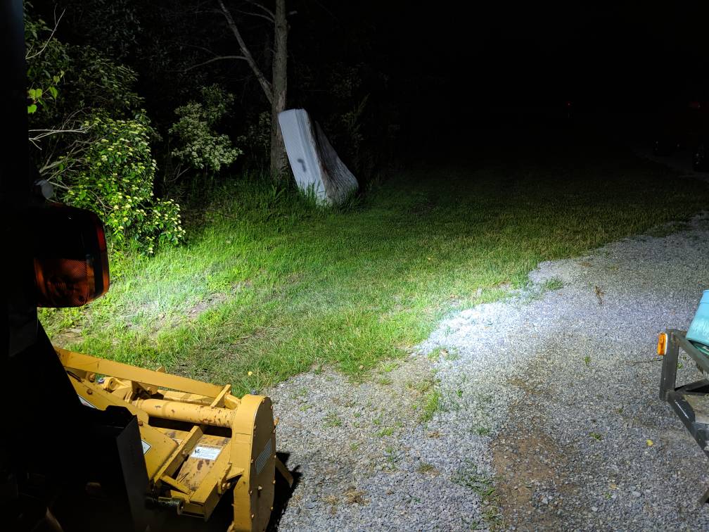

I was lucky enough to find what has been a real nice set of work lights that have been taking a beating on my ROPS all summer.

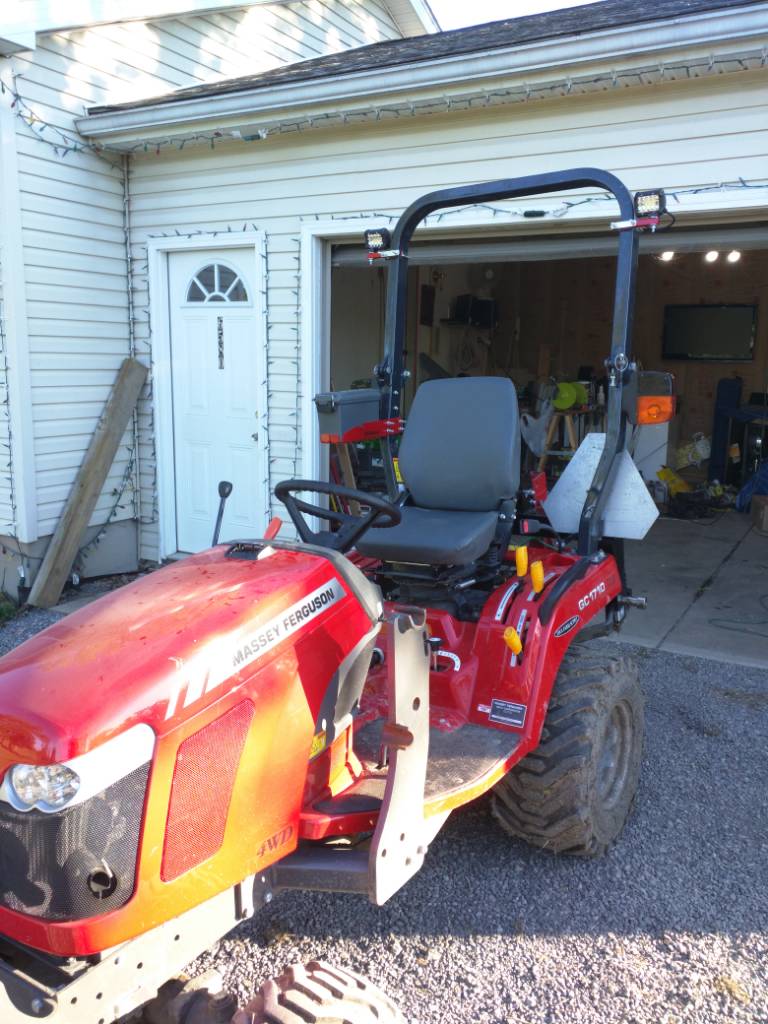

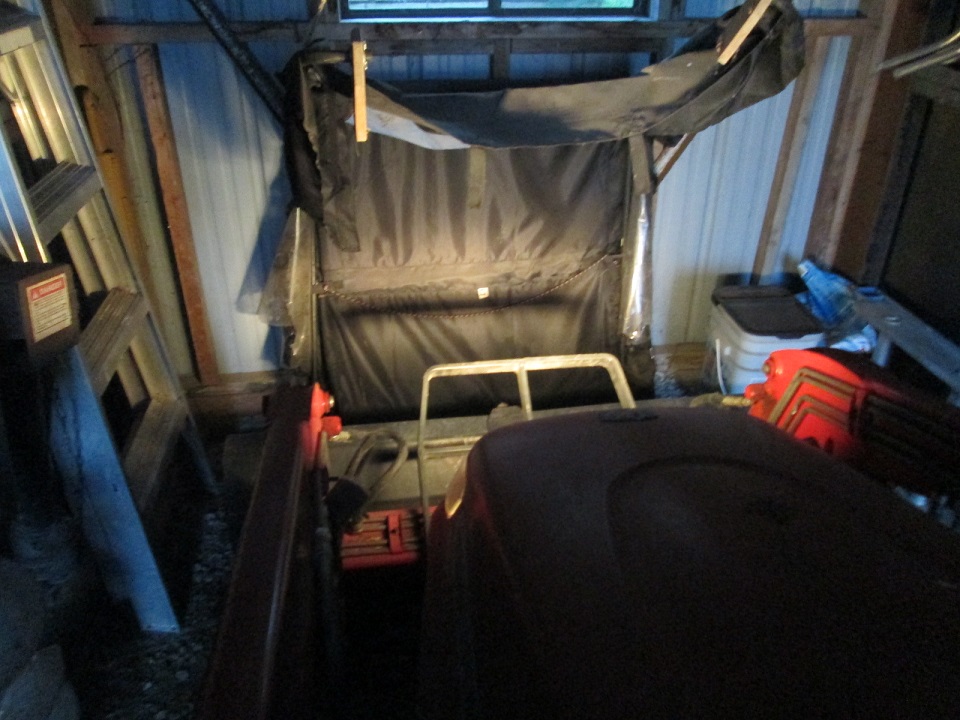

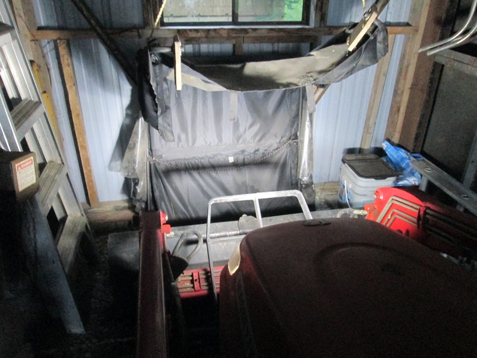

LED Pods,NAO LED Work Light Bar Bulb Spot Flood Lights for Trucks 4inch Led Fog Light Bar for Offroad Town Truck Car ATV Boat SUV 2PCS 140W Triple Row,12-month Warranty https://www.amazon.com/dp/B078HYKT61/ref=cm_sw_r_sms_apa_i_QjQIDbS1YB1FFIMG_20190623_220432.jpg1561342361010_IMG_20190623_220352.jpgIMG_20190623_192433.jpg

Have these leaked at all, I see a lot of these with complaints of moisture after any rain/washing?
Thanks for the pictures, given me some ideas for mounting them.
   / Put new LED headlights in #30
I haven't had any water/moisture issues. I store my machine inside a non climate controlled garage and it's been power washed and rained on over the summer without any ill effects thus far.
