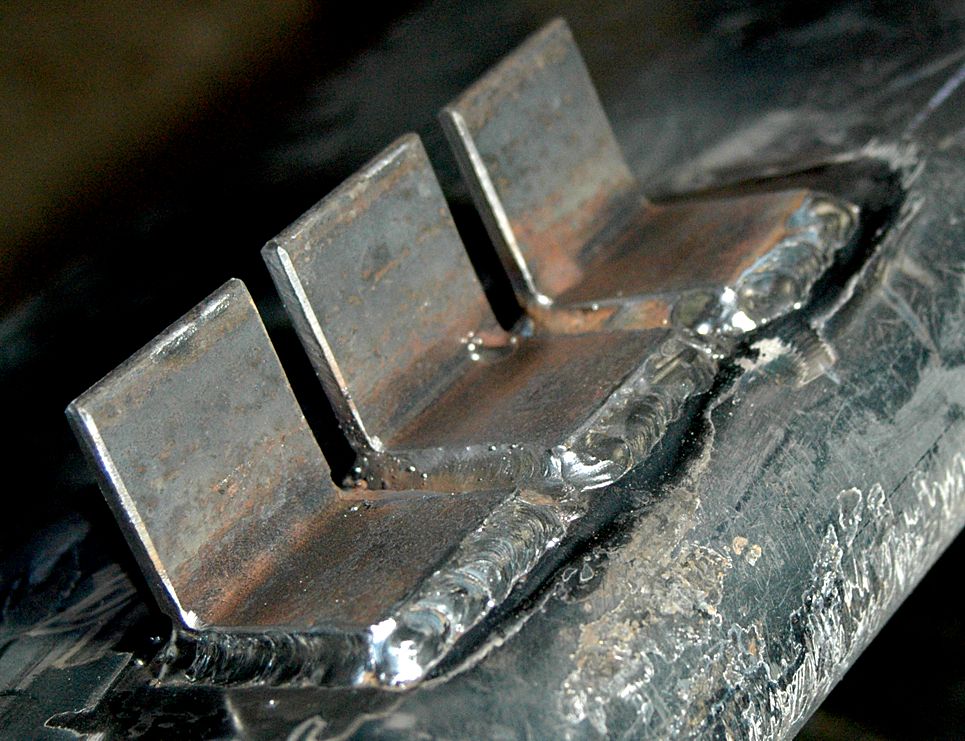

Chain slots allow the chain to go forward or behind the bucket for more lift ability.
https://www.tractorbynet.com/forums/customization/376751-chain-slots.html

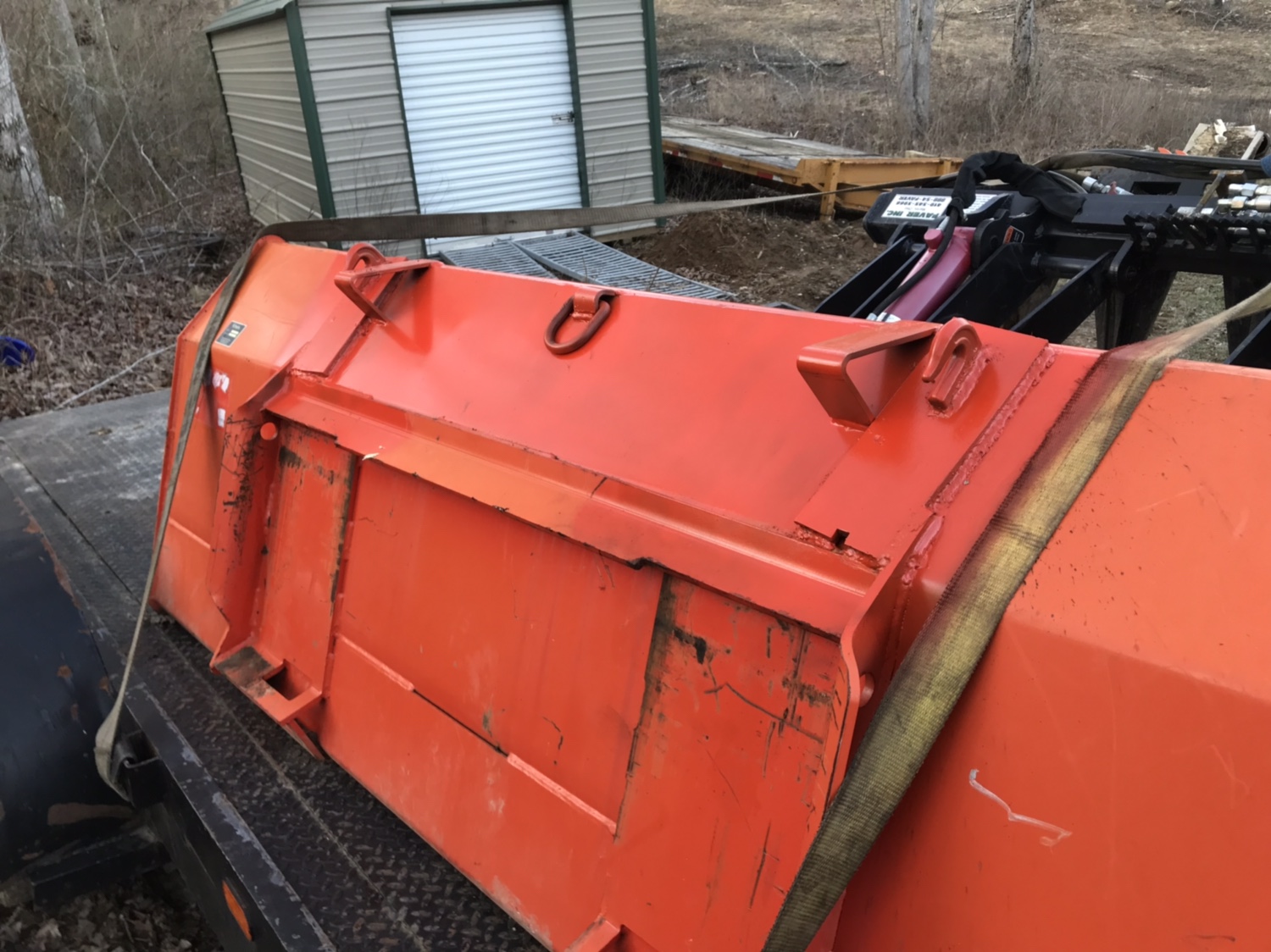

   / Put some shackles on the bucket #15
I don’t see the desire for shackles. On the rare occasion I need a chain I almost always need it shorter than it is. I weld hooks on every bucket I’ve had. I did weld a D ring in the middle of the bucket to hook a rope if I ever needed to. IMG_8368.JPG
   / Put some shackles on the bucket #16
I have hooks, but I suppose if you have shackles, you can always attach hook to them if you so desire.

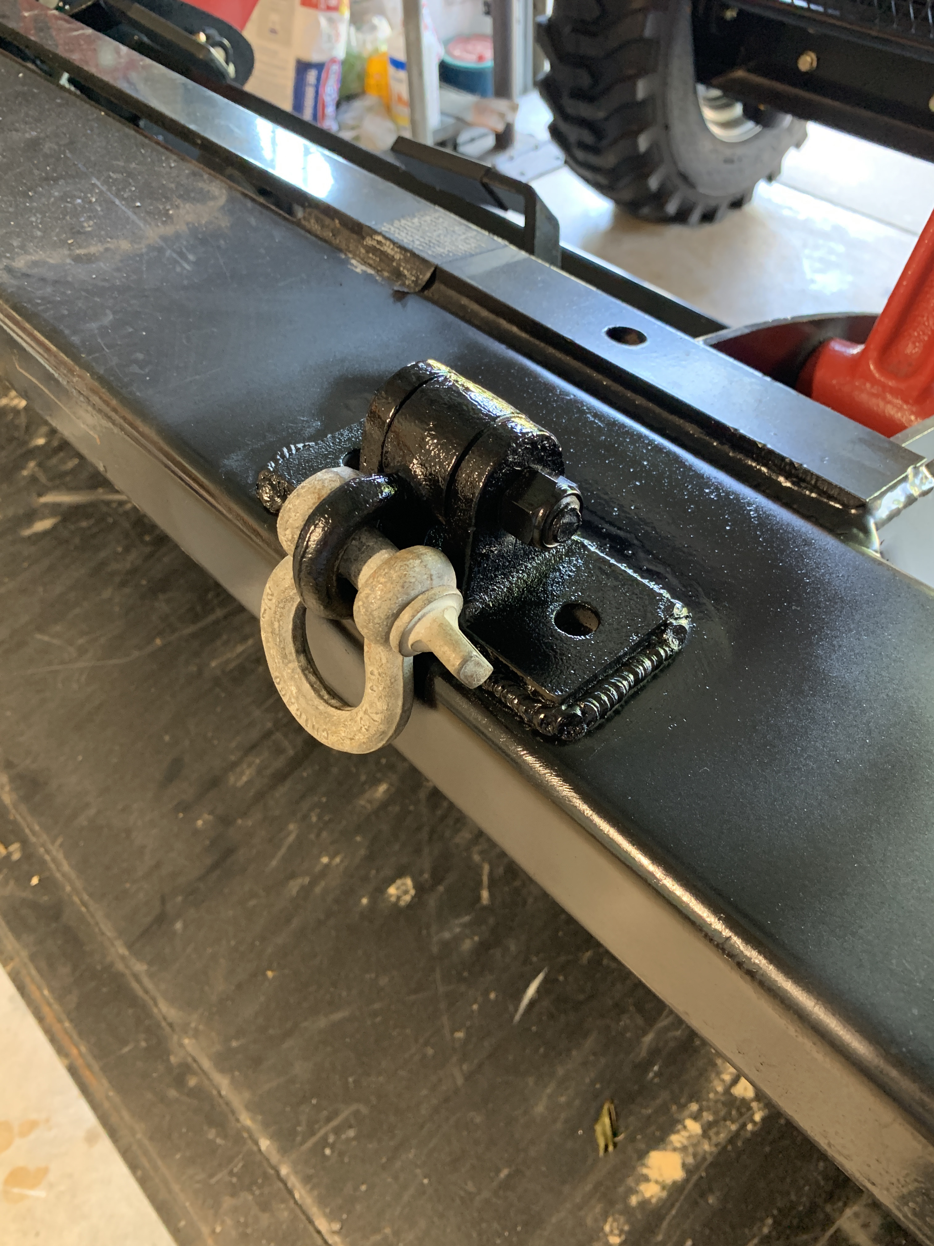

   / Put some shackles on the bucket #17
Nice Weld!! I have experienced the loss of too many shackle bolts due to hours of vibration: Suggest a good tight bolt with Locktite and extra vigilante inspection over the coming years.....
#18
The shackles came from an old swing set / playground set. The idea was to use them to swap out shackles for hooks when or if needed.
