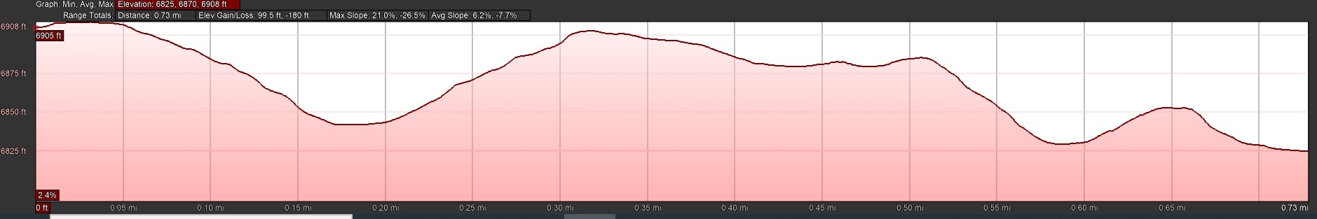

No blade attachment will cure 'roller coaster' terrain.
Hire in a capable guy with a small dozer to plane off high areas.
My road follows the contour of the earth, which is like a giant roller coaster. I think the steepest section drops 50ft in elevation over a distance of 350ft. Then it goes back up about 40ft and then back down etc. Underneath is sand stone in some places.
For the most part, the road needs to be the way it is to allow me to get places and not be 25ft below grade when I get there lol.

Here's a profile of one section of road that's 3/4 mile long. For scale, there's about 50ft in elevation change from the highest to the lowest point.
