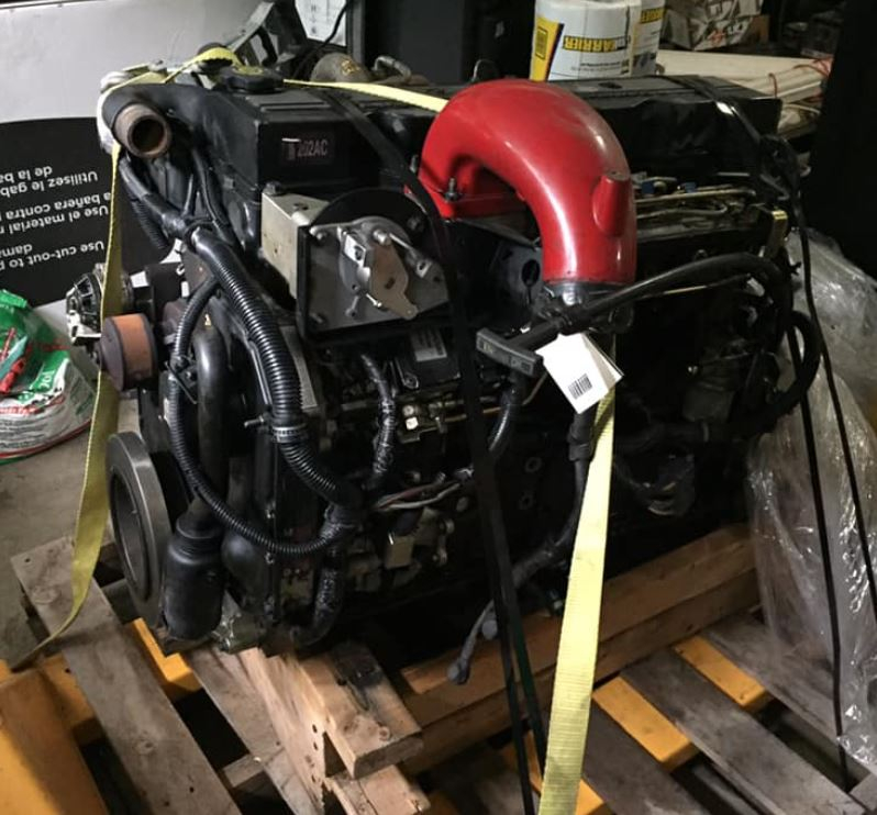

This project has been on the slow train for some time because of the difficulty I have experienced in getting the donor 5.9 engine worked on in a machine shop, but finally after more than a year it seems things might finally start moving....
This story starts in late 2010 when I bought a 2008 F250 down in Texas. Pretty close to where Eddie Walker lives. Got it with 70k miles and no snow or salt exposure. Over the following several years I babied the thing because I know the reputation of the Navistar 6.4 engine, but then 2 years ago while doing a 3 mile trip to a storage place the oil seals on one of the turbos failed and dumped about half the engine oil into the exhaust system. The odo was on 117k miles. I laid down a smoke screen that any battleship would have been proud of. Got it towed to an independent diesel shop because I already knew how backed up the Ford dealerships in the area were, seems a perpetual situation.
They took a look at it and said that if they pulled the cab and replaced only what was absolutely needed for the turbo job, the bill was going to be about $6500 and there were several other known weaknesses on the engine that could fail at any time, thus I would not be getting a reliable engine unless those were addressed. If I started adding on the extra issues the bill was quickly going to balloon to $17k. I said NO. I asked them what they would give me for the engine as a low mileage core, they gave me $3500 and I said "pull the engine". I took the $3500 budget and bought a 2001 model Cummins 24V VP44 engine from Colorado. I figured the engine must have about 200k miles on it so I would freshen it up before putting it into my truck and get rid of the VP-44. I did not have the cummins injection pump controller for the VP-44 and those are really expensive (~$2000) and the VP-44 often fails because the vehicle has a poor lift pump that with time flows too little fuel causing the pump and its embedded electronics to overheat and fail.
Picture of the donor engine. Hard to believe how much wiring is on such an early (20 year old) diesel engine...

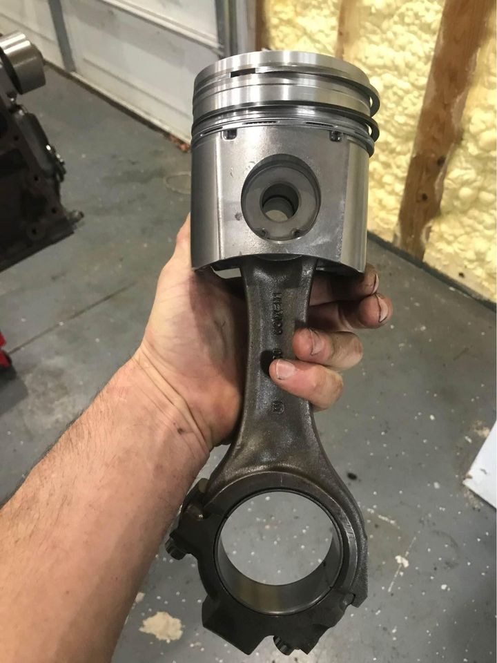

I pulled apart the engine and took it to the first machine shop where there were something like 26 engines in front of mine for processing. 3 months later I went and picked it up, untouched and took it to a second machine shop about a 90 minute drive away, they had said that they should be able to work through it in the next 2 months. As of today that's about 9 months ago, its now mid winter but they finally have cleared their backlog and we worked through the machining quote today. Basically $3500 for all the machine shop work, which includes re-surfacing the head, new valve guides, re-cutting the valve seats, pressure test, boring the block 0.020" over, re-decking the block, new cam bearings, re-facing the valve lifters, grinding main and big end crank journals. So that absorbs all of what I got for the Navistar core engine, so thus far I am out of pocket about $1500 for the donor engine and another $1000 for a Mahle rebuild kit that has pistons, rings and bearings together with a gasket set.
