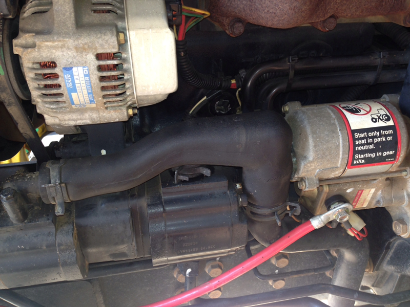

Here's a pic of the hose that I mentioned.
I will only be able to get to the plug with a straight 1/2" extension after I take the hose off. I tried going around the hose using a 1/2" u joint ratchet but I've got some hydraulic lines in the way.

Yes, the plug in the front and behind the hydraulic suction line manifold. (rubber thingy)
I loosened all three clamps on the suction manifold and lifted it only enough to slide a 1/2" extension under it. It did not come clean off the suction pipe but it did come off of the rear most hydraulic pump and almost off of the front pump but they easily slid back in place.

I guess my only question now is how much, if any, hydraulic fluid am I going to lose if I loosen up/take off the manifold. Does the fluid drain back down into the transmission when you shut off the tractor or does it stay in the lines? Would it be under pressure?
I thought about draining some of the hydraulic fluid out (although I'm not sure where from) and then pouring it back in after I'm done but I'm not sure if that would even drain the fluid from the manifold.

Likely not much oil or pressure in the return line. But then I've not pulled one off.
For the location of things, I'd suggest you getting a CD of the tech manual that covers the 4310. It is great to have when working on your tractor.
Drain plug for hydraulic should be the low point just under the tranny and include a filter showing just in front of the tranny with the return line close to there as well. Also a screen to remove and clean if changing hyd. fluid. Unless you know when it was changed last, it would be on my list to getRdun at the same time.

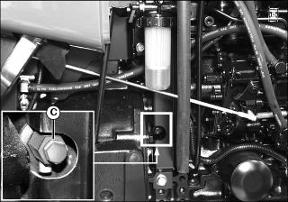

I did learn something though when reading through the owners manual again. On the right side of the engine, below the fuel filter, is an "Engine block drain Plug". I guess I just assumed that the only way to drain the block was to remove the plug where the block heater would go.
Anyway here's a pic of the drain if it shows up
8. Position drain pan under engine block drain plug (C) at right side of engine. Remove drain plug and allow all coolant to drain.

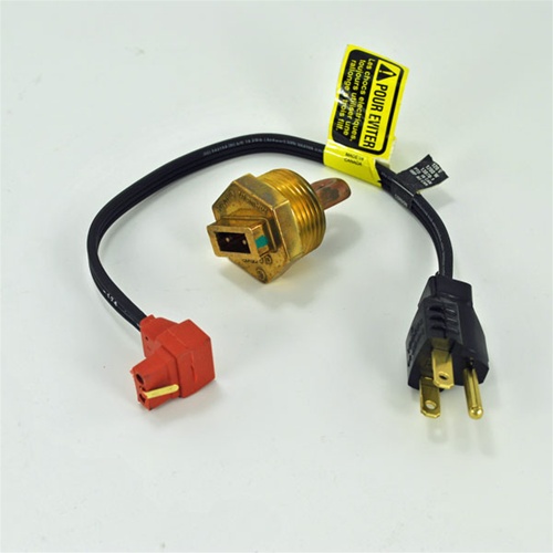

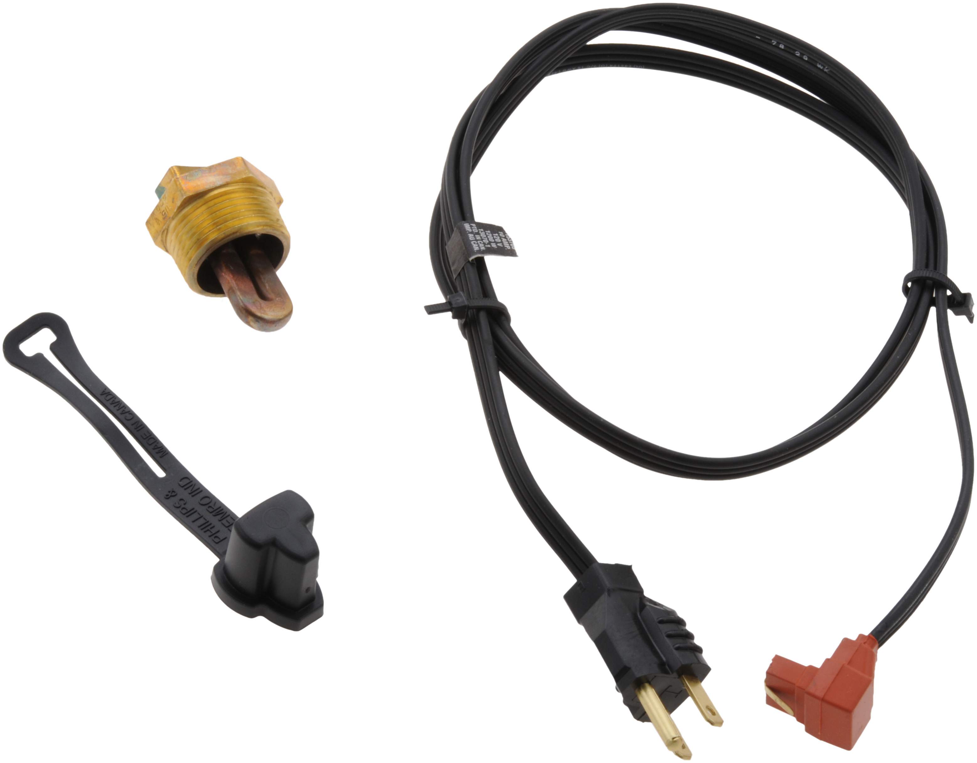

I may have hit a snag. I emailed the company selling the heater to see if it would fit and here's what I got back:
"Yanmar 3TNE84 is not listed in our application guide. If there is a 1 NPT port available, Zerostart 3100003 might work (it fits most of the other Yanmar 3 cylinder engines) but we cannot guarantee a fit. (FYI - if the heater fits into the engineç—´ water jacket without hitting any obstructions, it should work).
We recommend you use one of the silicone pad heaters instead. See attached flyer or look in our 2014 catalog on page 79."
Reading between the lines, it sounds like they're saying it will fit but the JD 4310 isn't listed on their paperwork so they can't say 100% that it will. At least that is my take on it.
I've looked at a pic of the OEM heater on a website John Deere Heater Kit AR87167and it looks identical but it's hard to tell from just a picture.
Any thoughts?
OEM heater:
Zero Start heater:
   / Putting block heater in 4310.....questions #9
The Deere heater is in all probability a re badgered Zero Start or Carter anyway.
Let price guide you.
   / Putting block heater in 4310.....questions #10
Remove the plug and double check that it is 1" NPT and that there are no obstructions. If that checks out, then seems you are good to go.
