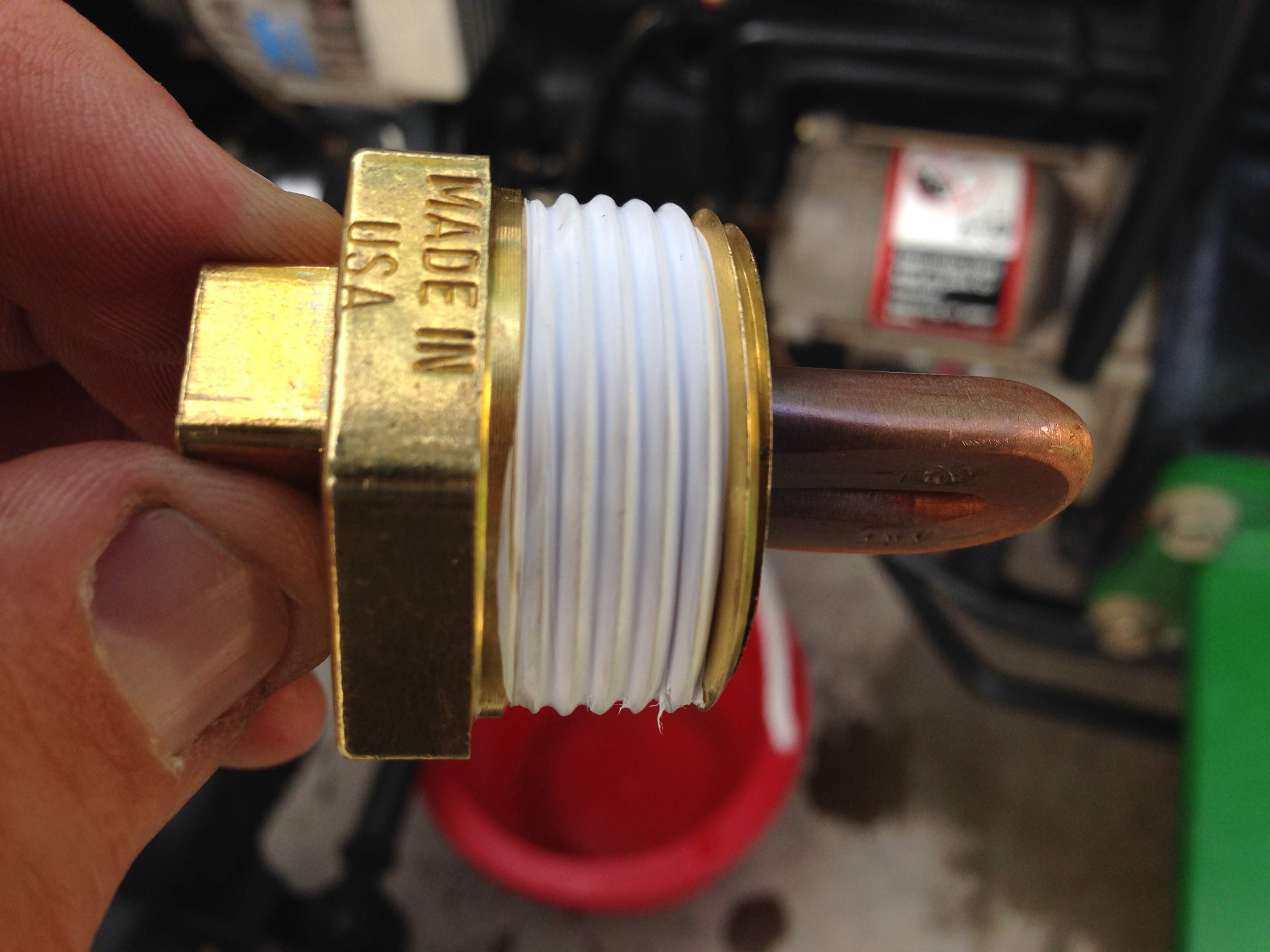

As it is water, and not hyd. fluid, use either the teflon or the paste. Use paste if for hydraulic fitting as the teflon may peel off and get into the system... so they say.
   / Putting block heater in 4310.....questions #13
Yeah, I agree it will likely fit, my engine wasn't listed either. Use teflon tape, that's what I did. Sounds like you have all the tools you need, the impact wrench will definitely make the job easier!

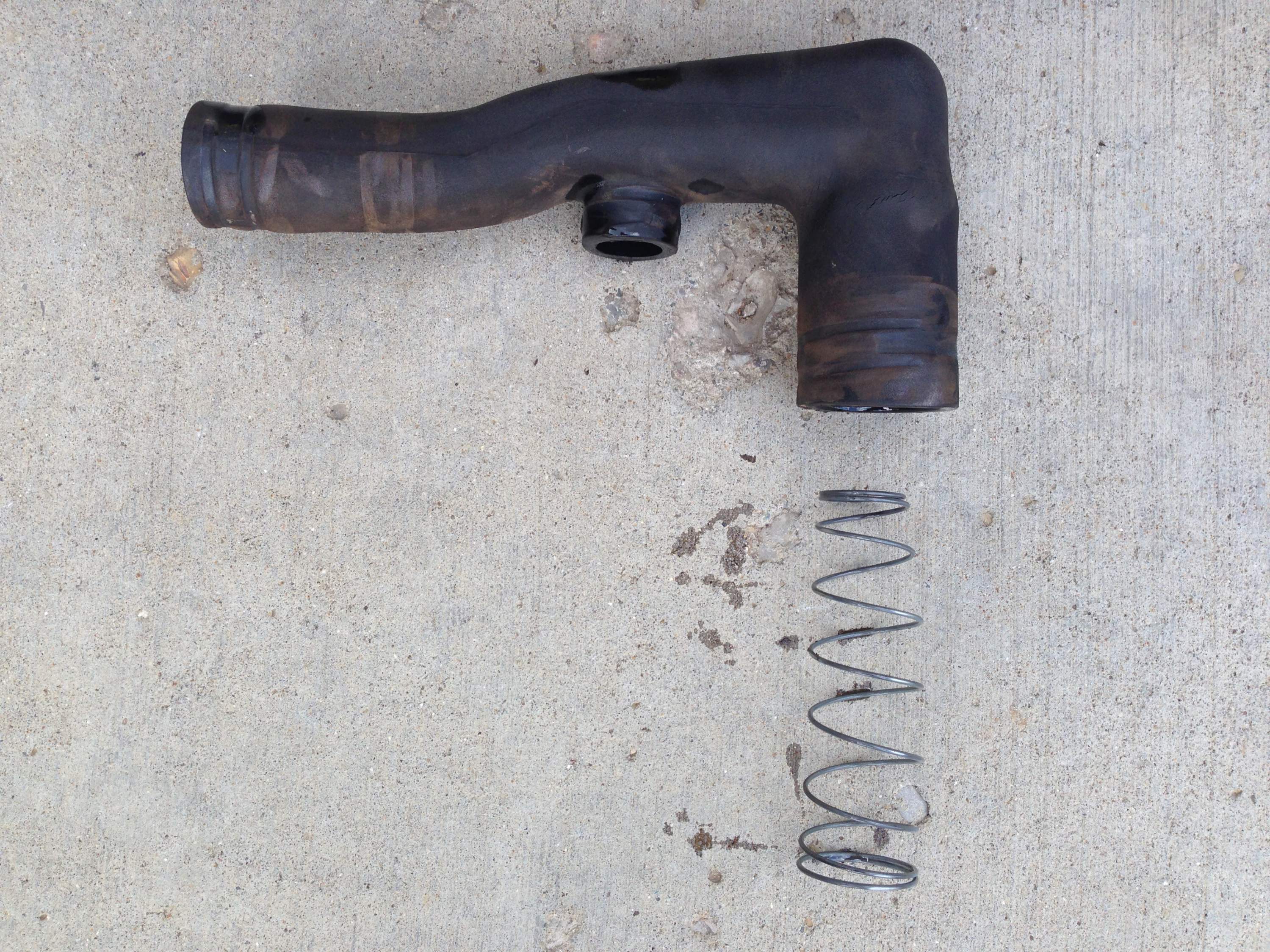

The first thing I did was drain the antifreeze from the radiator and the block. Then I took off the rubber suction manifold. It came off without even hardly trying. For the most part it is empty of hydraulic fluid when the tractor is turned off. I think maybe I lost a few tablespoons full. There was a spring inside of mine which I was not anticipating. It appears to be used to keep the rubber collapsing on itself. If you look at the picture, the spring will go up into the manifold and make a 90 degree turn and set in the long part of it. I got it out without any tools, I used a screw driver to make the bend when I put it into the new one. You'll figure it out.
Here's a pic of the old manifold:

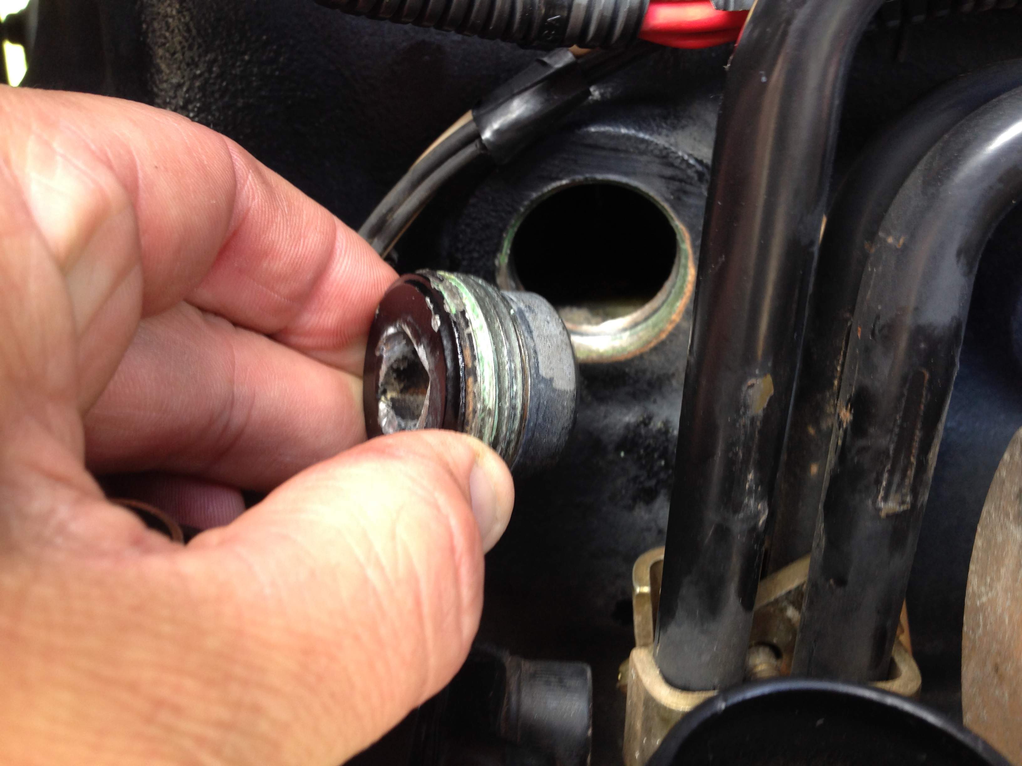

Next I took the plug out of the engine block. I was anticipating the worst, my tractor is 10 years old and has 2000 hours, but I had no trouble at all. I used a 2 foot breaker bar and a 6 inch 1/2" drive extension. The 1/2" drive fits right into the plug. I had my propane torch and cheater pipe at the ready but I thought that I would try with just the breaker bar first. I used medium force and heard the plug make a little crack sound telling me that it had broke loose. I did loosen up and lower the gold colored hydraulic line keepers to give me a little more room.
Here's the plug:
Next I put teflon tape on the block heater. The heater is even made in the USA!! Bonus

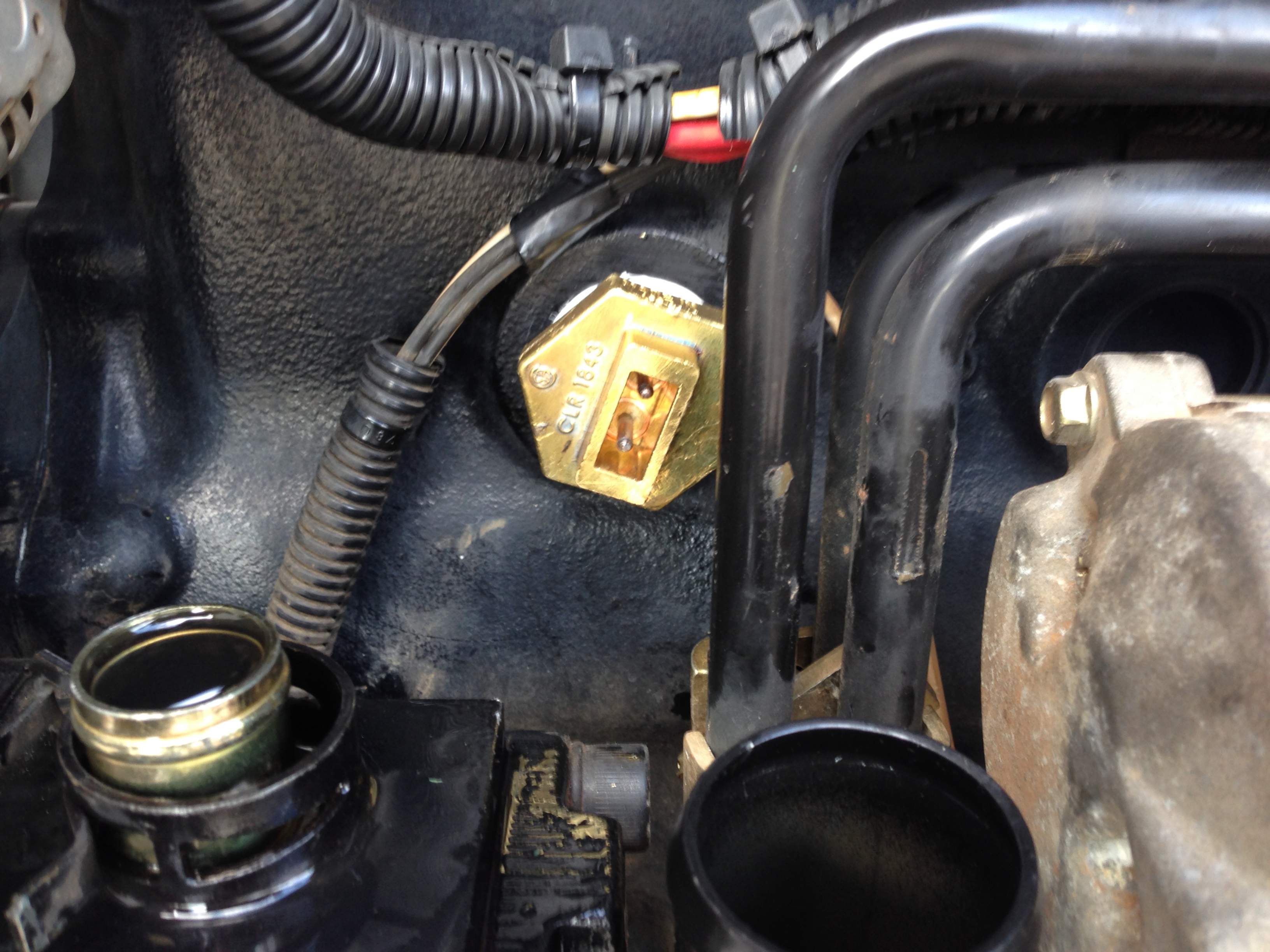

I put the heater in the hole and tightened it up as much as I could with a channel lock wrench. I had to hold the wrench perpendicular to the bolt part of the heater because there is no room to work. A socket won't work because of the hydraulic lines being in the way. I drove it around the yard when I finished and it's not leaking but I would like to get it about a half turn tighter. I think a crow foot wrench (which I don't have yet) should be able to get in there and allow me to get some leverage.
Heater installed:
and here's the finished project:
