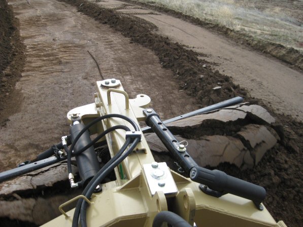

You might also consider getting one of the land plane grader blades. Indispensable for maintaining a road of the length that you are going to have.

I have thought a lot about a land plane but I didn't consider buying one until either A) a ridiculously good deal came along or B) I was finished with my driveway and ready to simply 'maintain' it. Would a land plane help in the initial stages or is it simply for maintaining? Also, don't go talking me into a land plane before you get my money for the top n tilt system :laughing::laughing: (side note-I have my FINAL order complete for the step 1 of my valve install!)

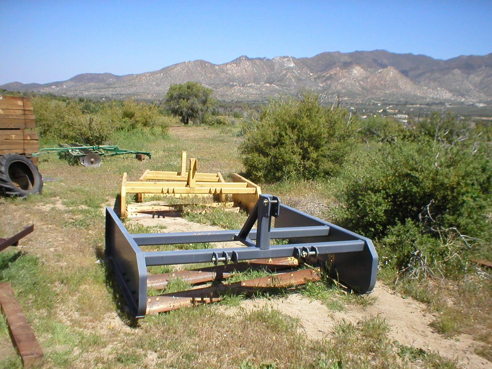

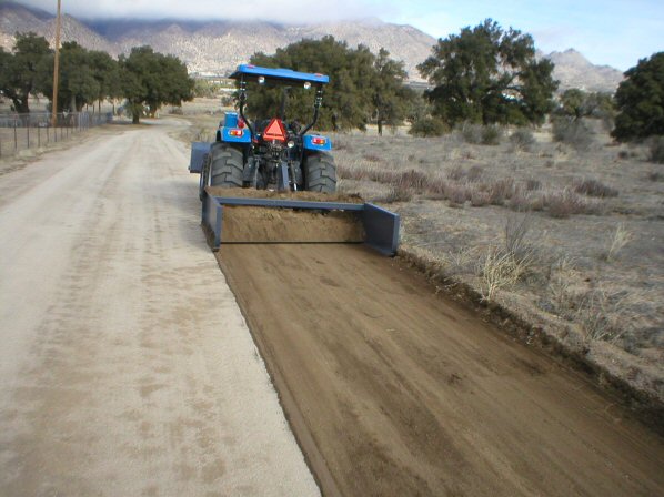

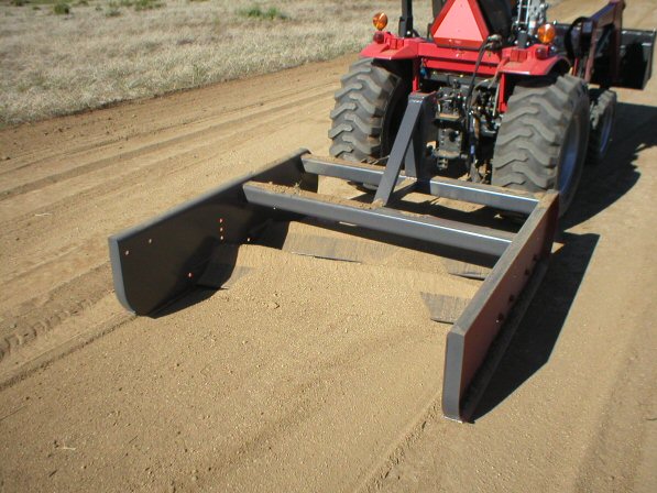

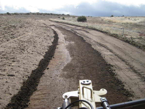

A few years ago I put in a new 1/2 mile long road to the top of our property. The 2 implements that I used were first my rear blade to get the main shape cut in and 2ND my land plane grader blade to get the overall evenness that I wanted on the road. So yes I used the grader blade in part of the building process. I never even used my box blade on it until last year to scrape the weeds off of it.
Now I didn't really need to move much material from one place to another, so for me the box blade was not needed for what I needed to do. I can only imagine what you will have to do with all those trees and rocks that you have. I'm sure that your box blade is going to get a real workout.
Now, if you want a deal on one of these land plane grader blades, let me know, I just happen to have an extra 7 footer, although I would venture to say that the shipping would cost more than the implement. :(

I have had these 3 grader blades for sometime. I bought them from a local dealer that just wanted to get rid of them. He had had them for about 10-15 years and was moving locations. I have had them for going on 6 years now. I had thought that they were early Road Boss graders, but after talking to the owner of Road Boss 4 years ago at an AG show, found out that they were his competitors grader the Road Master and long since out of business. :( The 7 footers are about 1400lbs and work very well. :thumbsup: :thumbsup:
