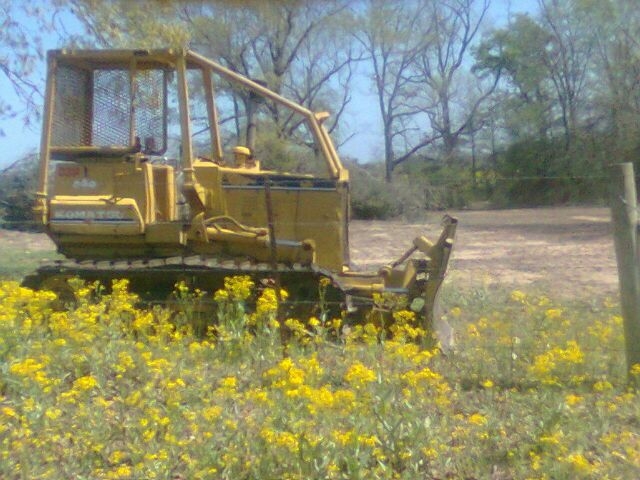

Thanks. I just couldnt figure it out. Cab certainly helps on long days but you gotta work with the sun behind you early a.m and late p.m. Dust on windows make working when the sun is low hard to do. But with that being said my next one will have a cab also. Haha.
I just got done cleaning up around an acre,took 2days,again I hate youpons trees. But spend the time to roll pushes to keep dirt out of pile and dressed it all up. Dust on windows alot better than dust in mouth:laughing: dozer.JPG

....,again I hate youpons trees. ... Dust on windows alot better than dust in mouth:laughing:View attachment 255838
I agree. Yaopons are a headache. Last time I cleared some land hired a mulcher for the underbrush which mainly consisted of yaopon too thick to walk through. Nothing to burn afterward though and if you use a shredder over them 3-4 times a year to keep them from coming back they will eventually die out.
