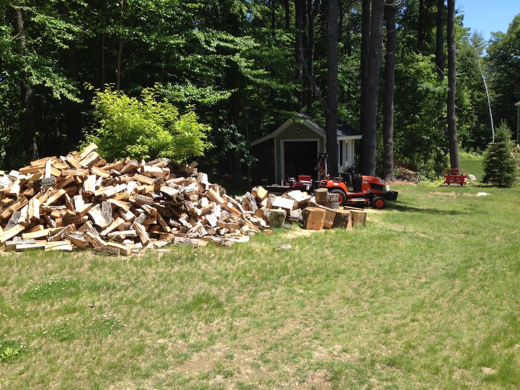

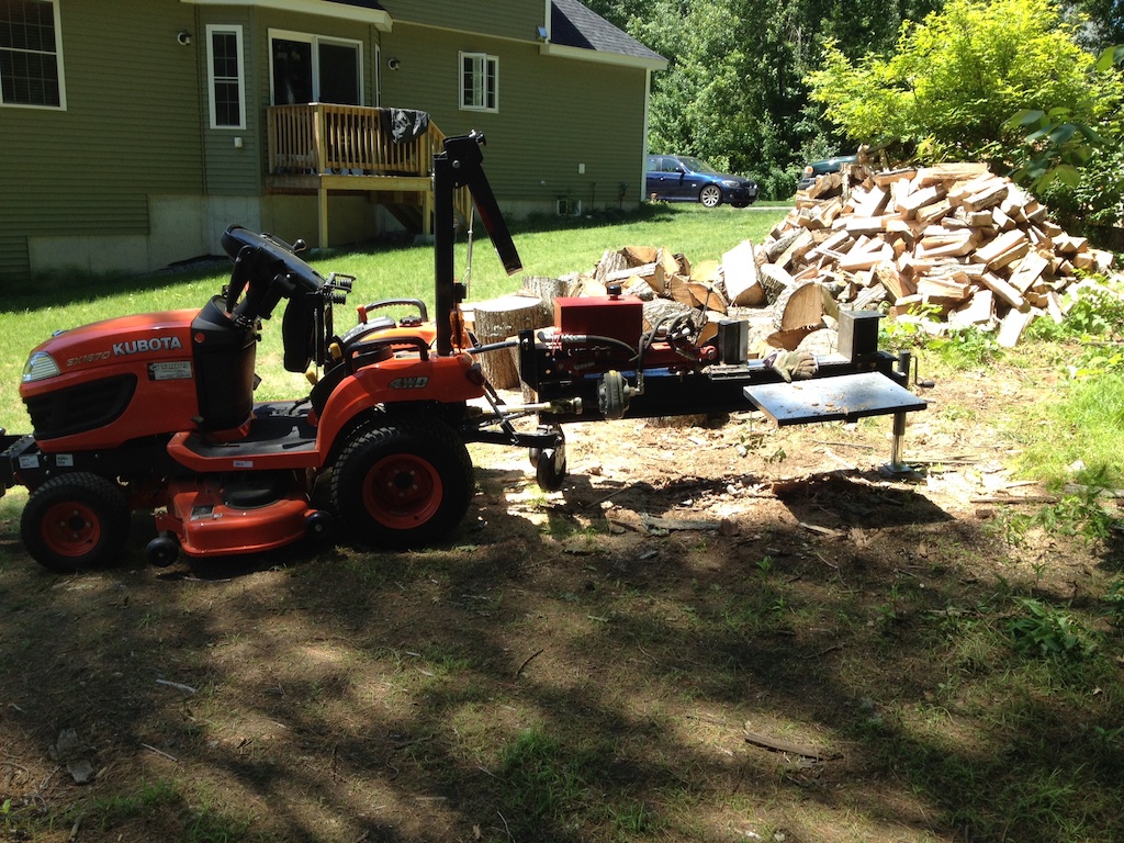

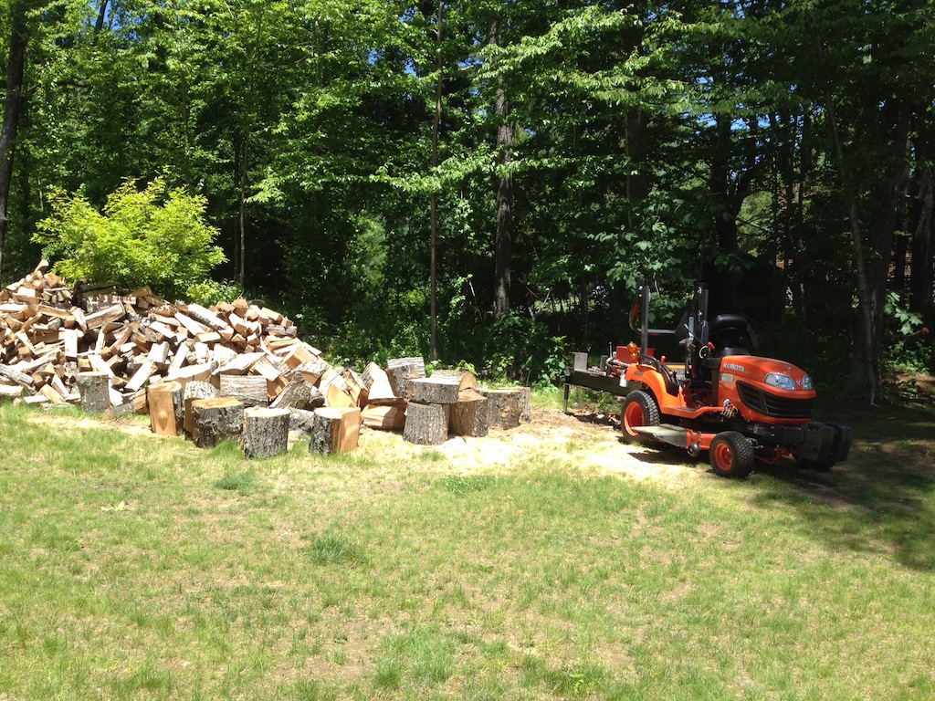

I've had my tractor for a week and have almost 10 hours on it between mowing and splitting wood. I added some fuel just be safe but the gauge read a little under half. even it was close to empty that's still way under a gallon/hour. I run the tractor at ~1800 when I split which seems to be more than enough to run the 11.4 gpm PTO pump and I run the mower at ~3000, I tried 2500 since the manual states to not run WOT until 50 hours but the tall stiff weeds weren't getting cut so good. The dealer said to run it like I stole it. So far I am happy with it.
The small 8x12 shed in the picture fits the tractor and snow blower nicely along with a few other things. wood3_small.jpgwood2_small.jpgwood1_small.jpg

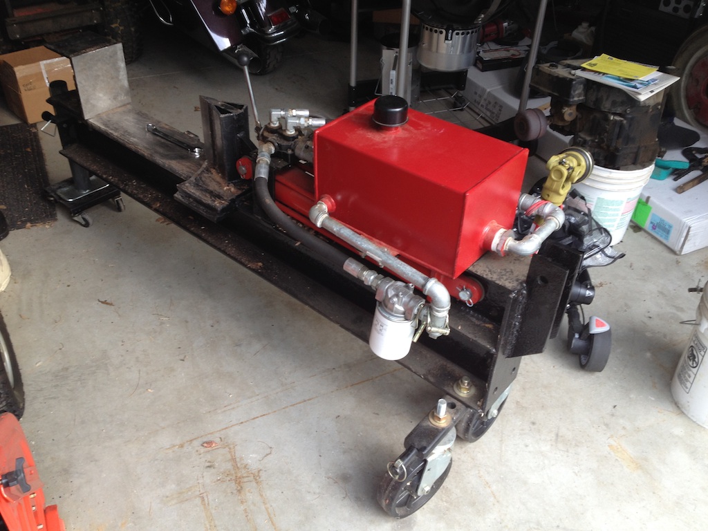

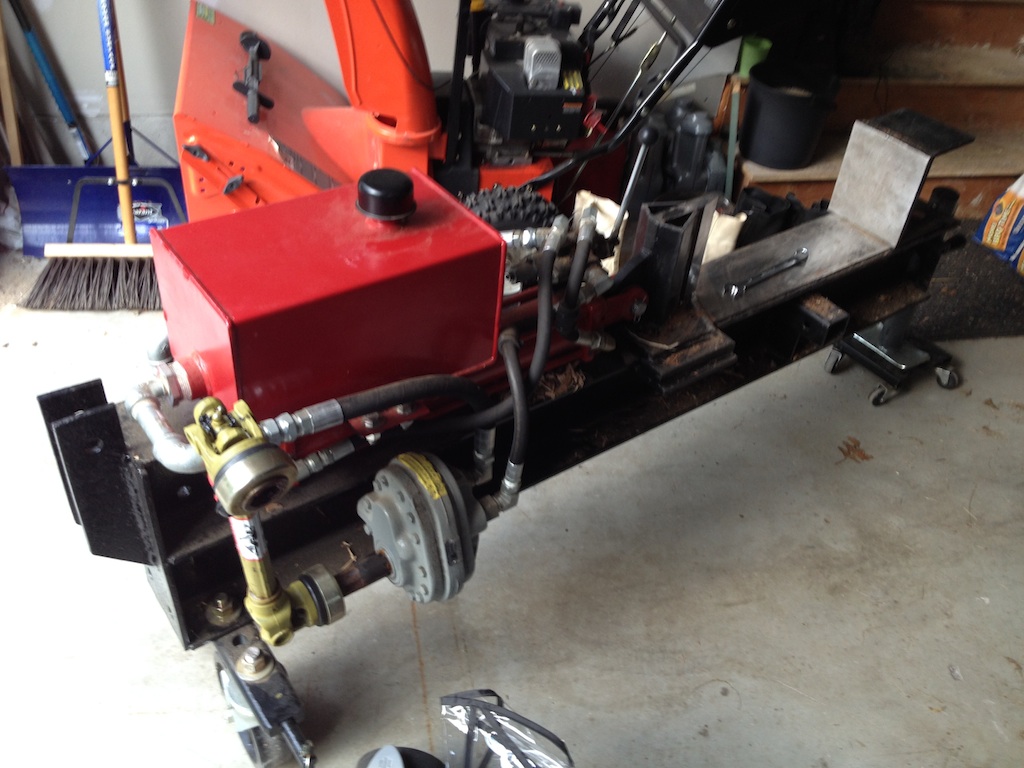

What kind/brand pto splitter is that? What is the average speed? Looks like a nice set up
   / Putting my BX1870 to work splitting wood
Thanks. I built the splitter myself - so far it has held up decent using it off and on for a few years. I put on a Prince PTO pump, I tried running it off of the tractor hydraulics on my BX-25 but it was slow and I had to run it at a higher throttle. I have a spread sheet at work that I made to calculate the cycle times based on RPM and PTO speed and I'll post the table later on today.
I should have enough wood for the year, that was just one pile and my wood shed is almost full. Less work to do next spring.
Here are the numbers I calculated a few years ago. I probably have a 10-11 second cycle time ~1800 rpm which is fast enough for me. I used a 3.5"x1.5"x18" long cylinder and the pump is 11.4 gpm. Hopefully the formatting comes out OK on my table. if not, the columns are - RPM, PTO, Pump Displacement, Extend (sec), Retract (sec)

Hi Steve,
Would you post some closeup pics of your splitter setup? I am considering a similar project for a similar sized tractor (BX1860) and wanted to see how you handled a few things.
