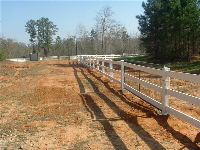

Here's a pic of some vinyl fence my girlfriend and I did over the winter. It's simple to install once you get your holes lined up. I have more pics posted in a thread called "Creating an Entrance" in this Projects forum if you want to search for it.
Gates are the biggest disapointment I've come across. All the manufacturers have plans for building them out of the rails. Every one I've seen isn't very secure.
Instead of going the vinyl route, I used a regular metal gate and screwed vinyl rails onto it. From a distance it looks like the rest of the fence, but up close it works like a solid metal gate. To suport the gate I replaces the vinly post with a five inch steel tube that I welded on some nuts to thread the gate hinges onto. Then I painted it white and it blends in perfectly. It's extremely solid!!!
Every now and then you'll get some green alge or mold growning on the fence. Easiest way to fix that is to spray a mild mixture of bleach on the fence.
The biggest issue I'm facing is weed eating around the posts. I don't want to develop a wear pattern at the bottom of the post from constatnly hitting it over the years with my trimmer, so I'm super cautious around there, which is a royal pain.
I'm thinking about putting something over that area to protect it, maybe some strapping from Simpson Strongtie. I'm still undecided but will have to come up with something in time.
