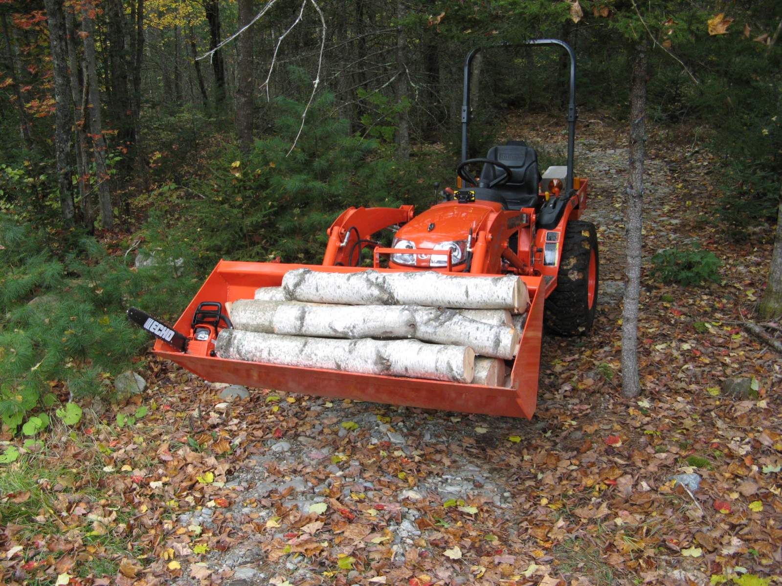

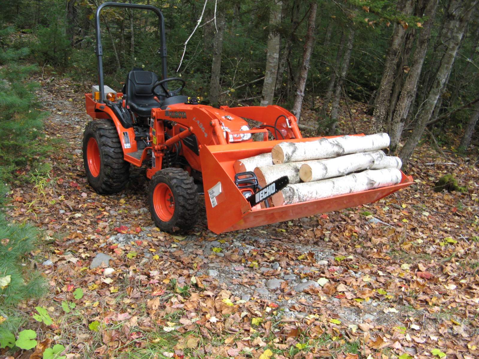

The 60 inch light materials bucket and QA is working out well for my b2620. Gives you more room for the light stuff. Hope it works good with snow. Now whee do I put my other bucket for the winter?:confused:

Nice outfit! Big buckets make snow work easy!
   / QA and 60 inch bucket for b2620 #3
That'll save you a few trips. Good work!

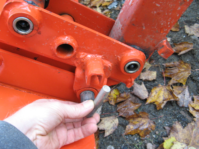

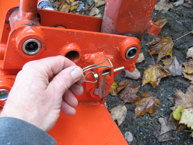

Here's a detail of the quick attach for any newbies like me that are interested.

Now do you actually have screws instead of the clips on your QA pins Chuck? I'd like to take credit for it but mine actually came with the clips, I'm not that bright. Not sure if that is what you meant in a previous post somewhere.
   / QA and 60 inch bucket for b2620 #9
There were small bolts in the original pins that came with the OEM loader. They are reused to secure the QA to my loader arms, but the pins that retain the bucket have the clips like yours.

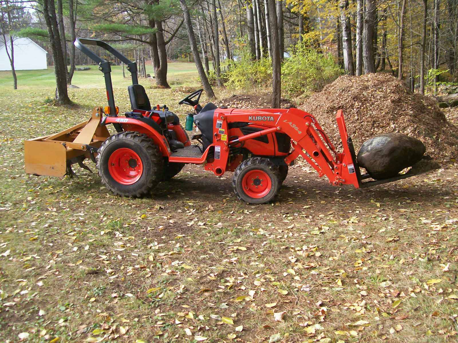

For those of you that have wondered about the effect of the QA on lift capacity, here is an idea of what it still can lift. Consider that this rock would't fit in the bucket, and if you chained it to the bucket it would be further still from the pivot point. By the way digging this rock out took three easy "stabs". One to define where the edge was, two to get under it a bit, and roll it up at an angle, and a third move to get completely under the rock, curl back, lift, and drive away with a minimum hole size to repair. In case you all can't tell, I do like this setup. A couple of minutes to put the bucket back on, fill the hole, and I was done... Don't have to mow around that iceberg any more.
This is the maximum this loader will lift. I couldn't lift it higher, and I sure wouldn't want to. My rear tires are loaded, and with the BB on back it still felt light on the back. Low range, creeping in 4wd all the way.
