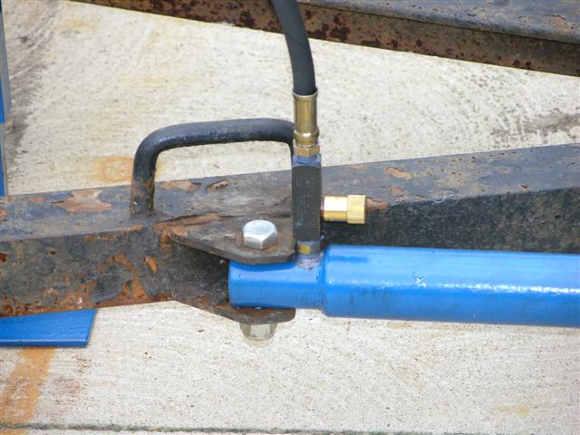

Re: QA plate on 7.5\' snowplow for FEL, let it snow
Added a flow control valve to each of the hydraulic cylinders so that we could control the speed of the angle cylinders arc.

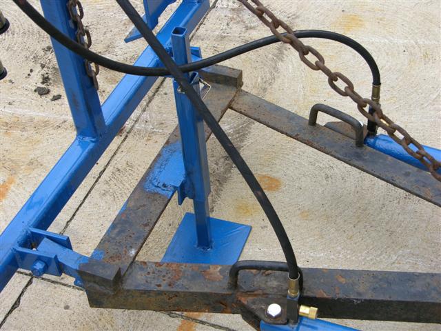

Close up of hydraulic cylinder plumbing and parking stand.

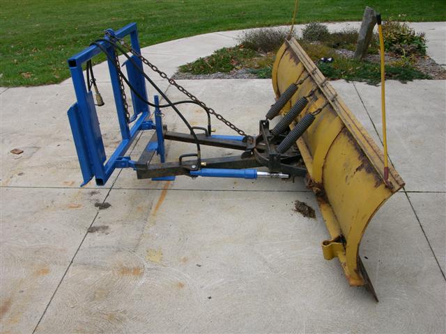

This is how the plow looks in the parked position.
There are still no plow shoes on the blade. Meyers gets just under 50 bucks for each shoe. /forums/images/graemlins/blush.gif So we went to TSC and picked up a set of plow shoes for a Western plow at less than 16 bucks each.
The Western shoes use a 3/4" mounting shaft which we quickly cut off and replaced with a 1-1/4" mounting shaft that the Myers snowplows use. /forums/images/graemlins/grin.gif

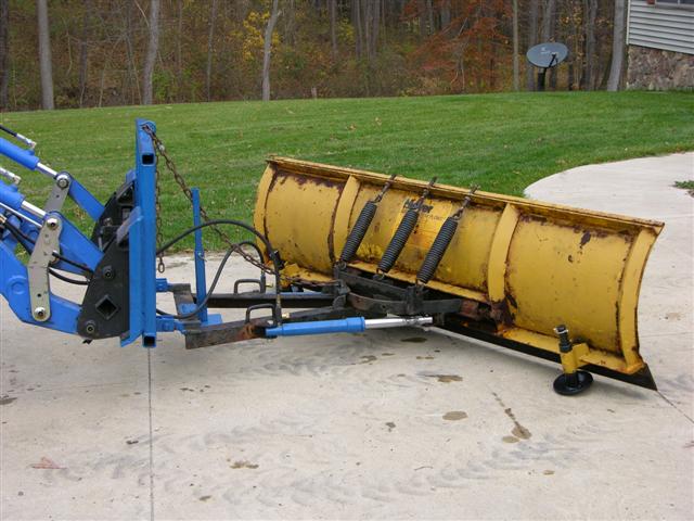

   / QA plate on 7.5' snowplow for FEL, let it snow
#18
The 17LA handles the weight of the blade very easily. I'm going to use the blade through this winter and if all goes well come next summer we'll have the assembly sandblasted and painted so it looks like new.
