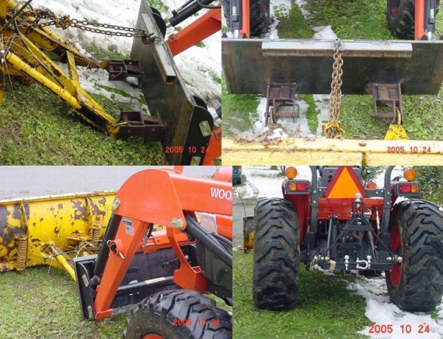

Hi, ( first snow yesterday, time to get going ...)
Starting slowly with this 'Build-it-yourself' stuff.
My 3430 has a woods FEL with a skidsteer style QA. I wanted to try and use my old snowboard from the long gone plow truck.
I ordered a blank attachment plate off Ebay and just welded onto it the OEM mounting pins from the old truck's plow frame.
I added a chain hook to the top edge of the plate and ran home before dark to try it last night. Operationally I see that I will need to extend the lift chain so the attachment plate is vertical when plowing.
I can see one big safety issue I need to resolve before this gets painted. If I were to lift the FEL to full height and then be foolish enough to curl the 'bucket' so to speak, I would probably end up with the heavy snowboard on my head in a rather deadly fashion.
Looking for suggestions on that? Is there a simple way to limit lift in the FEL without causing damage? Or should I perhaps weld a structure to my plate that will prevent the snowboard from coming up past some point near the horizontal? That might prove useful as a way to put downpressure on the snowboard by curling the attachment plate down....
I have yet to resolve how to steer or simply pin the snowboard for this winter. I would rather see if the tractor can deal with the weight before investing in the hydraulics to operate the plow swing. This FEL can be upgraded for 3rd hydraulics so that will probably be the eventual solution...
It is not much for a first try. However, I am having fun making something with the TIG welder... /forums/images/graemlins/laugh.gif

Your safety concern is valid. I occassionally read about a farmer backing up his tractor with a round bale in the bucket or on a carrier on the FEL that does not spear the bale. If you don't watch and your hand stays on the UP handle, before you know what happens, the bale rolls back down the FEL and either breaks your back and/or kills you, generally.
I'd want to safety it really well--you have to account for someone else operating it as well, with or without your permission!
Maybe a simple chain fastened with pinned clevises going from the front of the tractor to the bottom of the bucket??? Might have to use some tarp straps or something to take up the slack in the chain when the FEL is down........
Hope this helps; stay safe.
ron

I am considering changing the stock lift chain to a solid box tube. Perhaps a combination of chain (for slack) and then box tube pointing horizontally forward from the plate. The box tube would then serve to keep the snowboard from flopping all the way back if it ever got lifted and curl together by mistake.
I will wait a little to see if other better ideas pop up here. I will also ask my dealer about where to connect a chain that would prevent the FEL from lifting to an unsafe height as you suggested.

Your safety issue reminds my of the old joke about the guy who went to his doctor and says "Doc, I get a terrible pain in my chest when I raise my arm above my head". So the Doc says "then dont raise your arm above your head". Seriously, you can probably weld on stop plates to the lower brackets where the spring pins are or even a piece of 1/4" thick angle across the two so if you raised and curled the chain would loosen up but the two lower arms would hit the stops.

I'd replace that chain with a solid top link either off your 3 point or fabricate one then you can lift or lower it with the bucket curl control with the knowledge that it will not come crashing down on your head. /forums/images/graemlins/tongue.gif

If you need the top chain to allow the blade to follow the grade of its own weight, use a pinned clevis at each end of the chain, so it won't slip out of a hook. With the bottom pinned to the FEL and the top constrained by the chain it can't come off. It's not like a round bale that's not attached to the tractor. The chain works better than a solid link if your drive is other than dead flat.

I had great plans to construct a separate plow mount similar to what I had on my last tractor but....as DavidVT has noted, I have run myself out of time /forums/images/graemlins/frown.gif so I am planning on making a QA setup for this winter at least...
I guess my question relates to the need for slack in the third link. I had been thinking of having it fixed and setting the FEL in float mode....but I seem to remember threads from past years where people noted that the FEL would pop out of float when it hit bumps...is this why you would recommend a flexible link?

PS: I did add length to the lift chain and used a loop of chain and clevis to secure the upper connection to my QA plate...

Probably about 6 inches of heavy snow on the driveway this am. More than enough to test the new plow rig!
My 3430 with R4's and no chains mounted had absolutely no problem pushing the new plow setup! No rear weight or heavy implement either. (but for the filled tires of course)
The real test will be when the ground is frozen with hard packed ice.
I had to stop when the ole snowboard destroyed the lawn next to the driveway.... Curled it up like snow.... OOPS...
Oh well, I can breath easy that we are ready for snow....
I do have to pin the snowboard swing as I don't want to use the pistons this winter.
