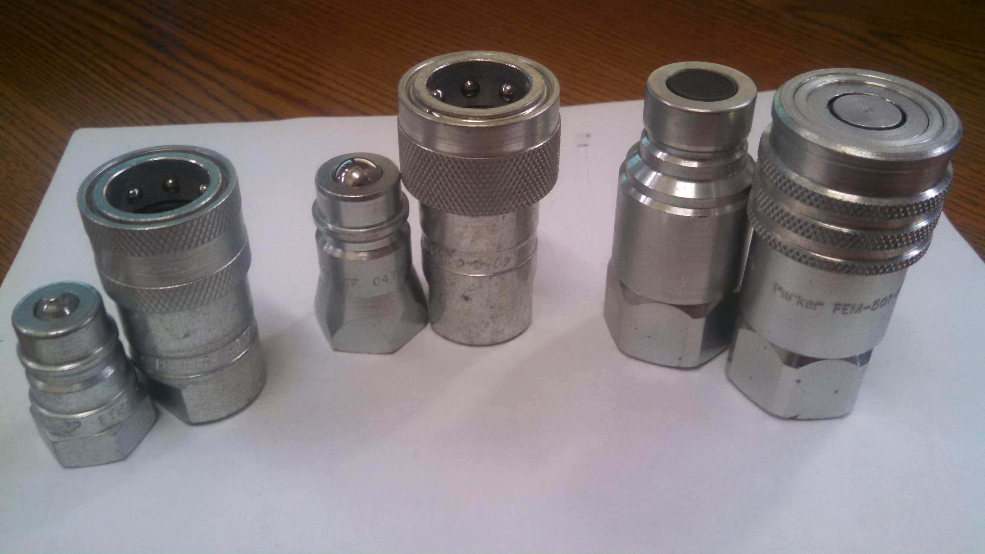

To be more specific, our standard coupler size is 1/2", but you can get 3/8" for no extra. Standard is 1 male/1 female, but you can get 2 male or 2 female for no extra.
Some people like flat face couplers, which are commonly found on skid steers. You can order the grapple with FF couplers for $75 extra.
For reference, here is all 3 types:
3/8"(left), 1/2"(center) and flat face(right)
And a more specific reference of each:

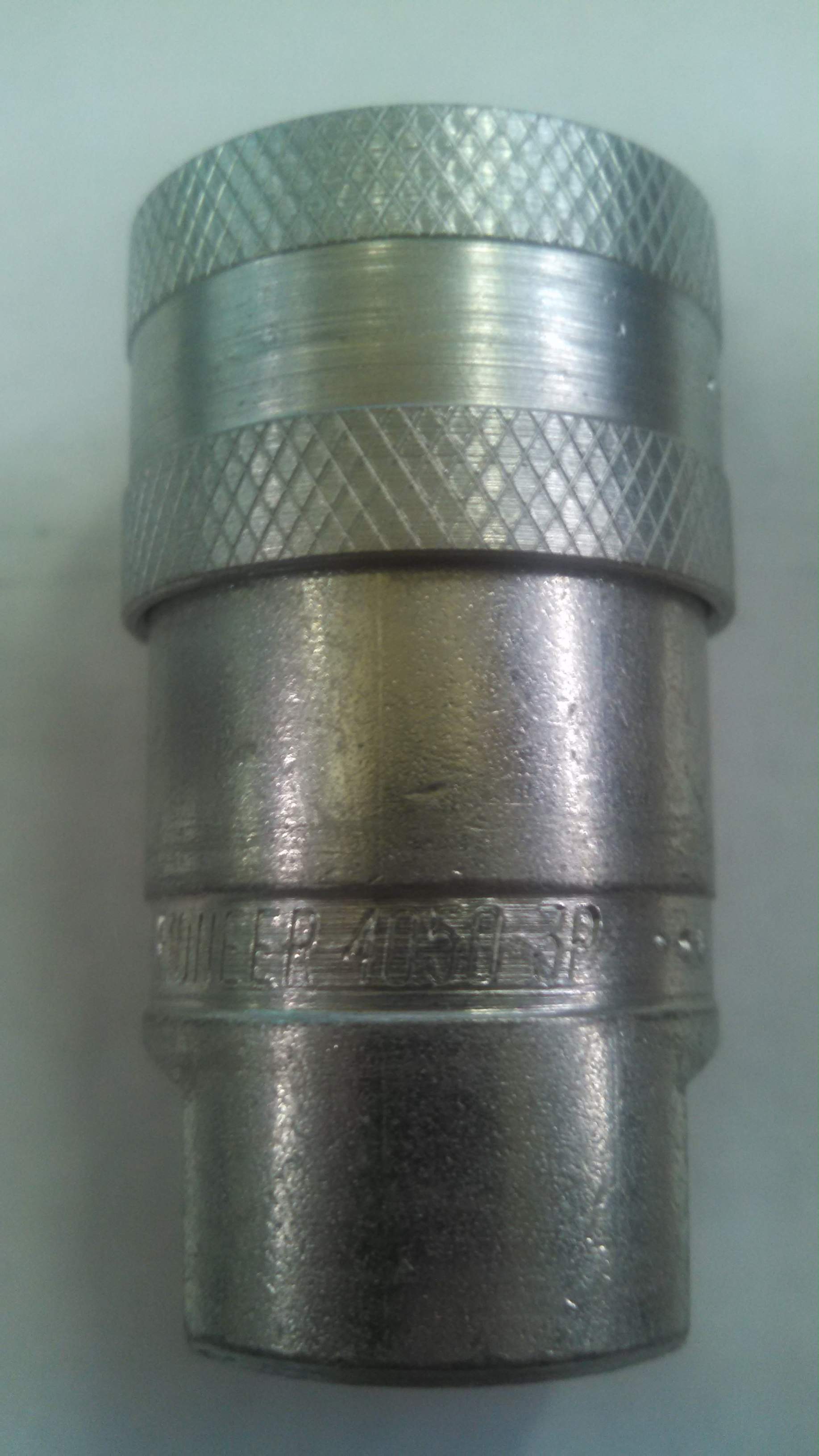

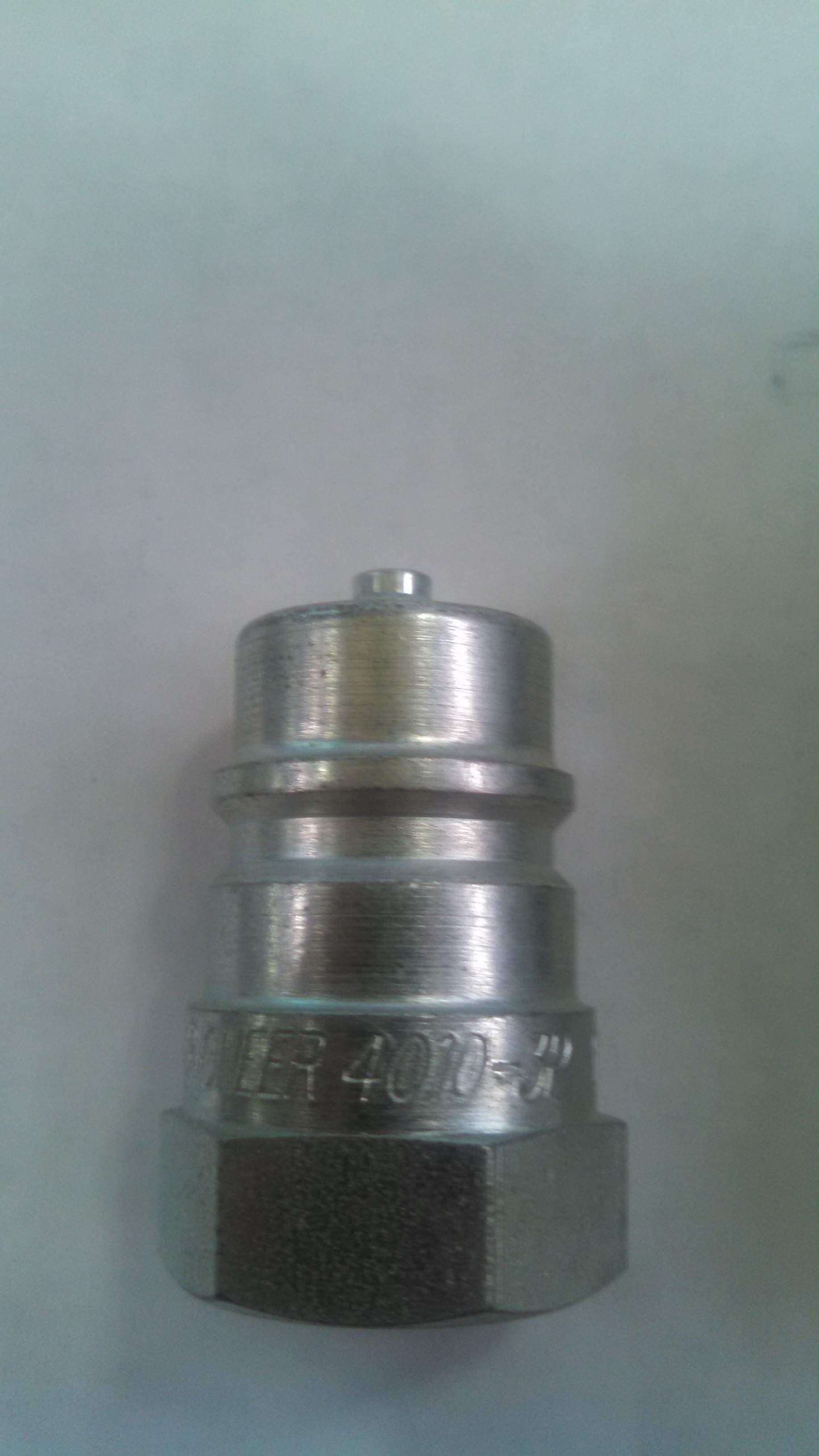

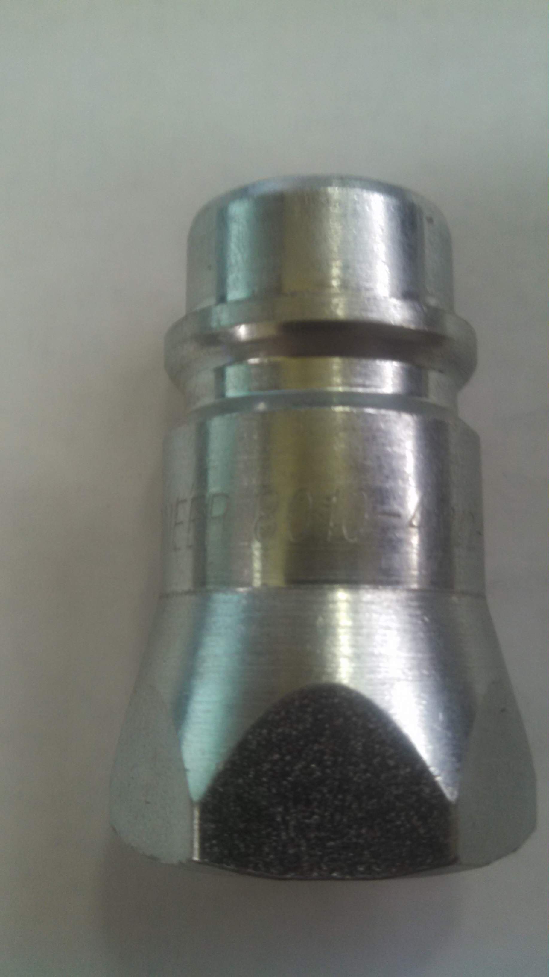

3/8" male....Pioneer 4010-3P 11PT
3/8" female...Pioneer 4050-3P
1/2" male...Pioneer 8010-4 1/2-14NTPF
1/2" female...Pioneer 4050-4 1/2-14NTPF

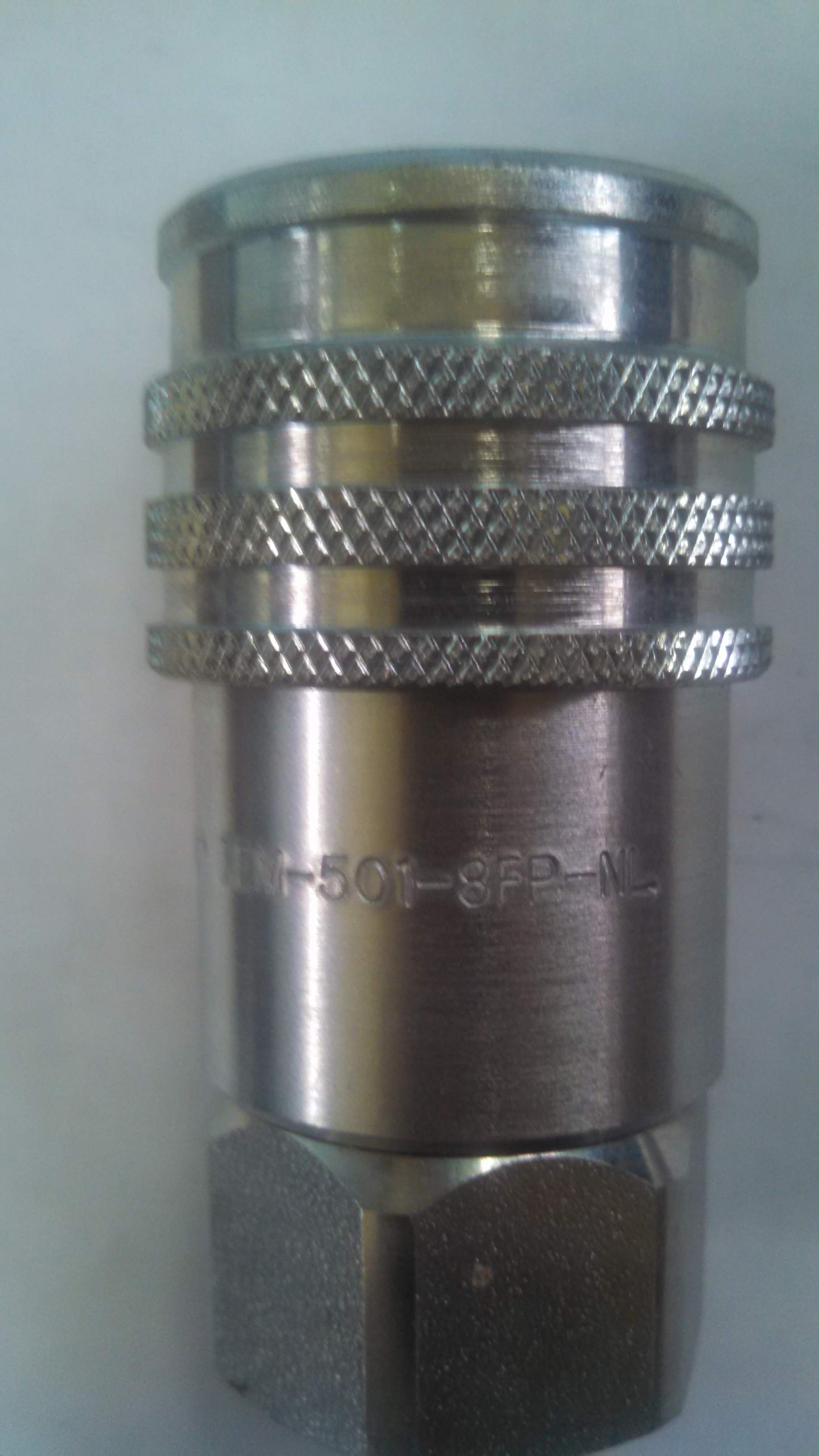

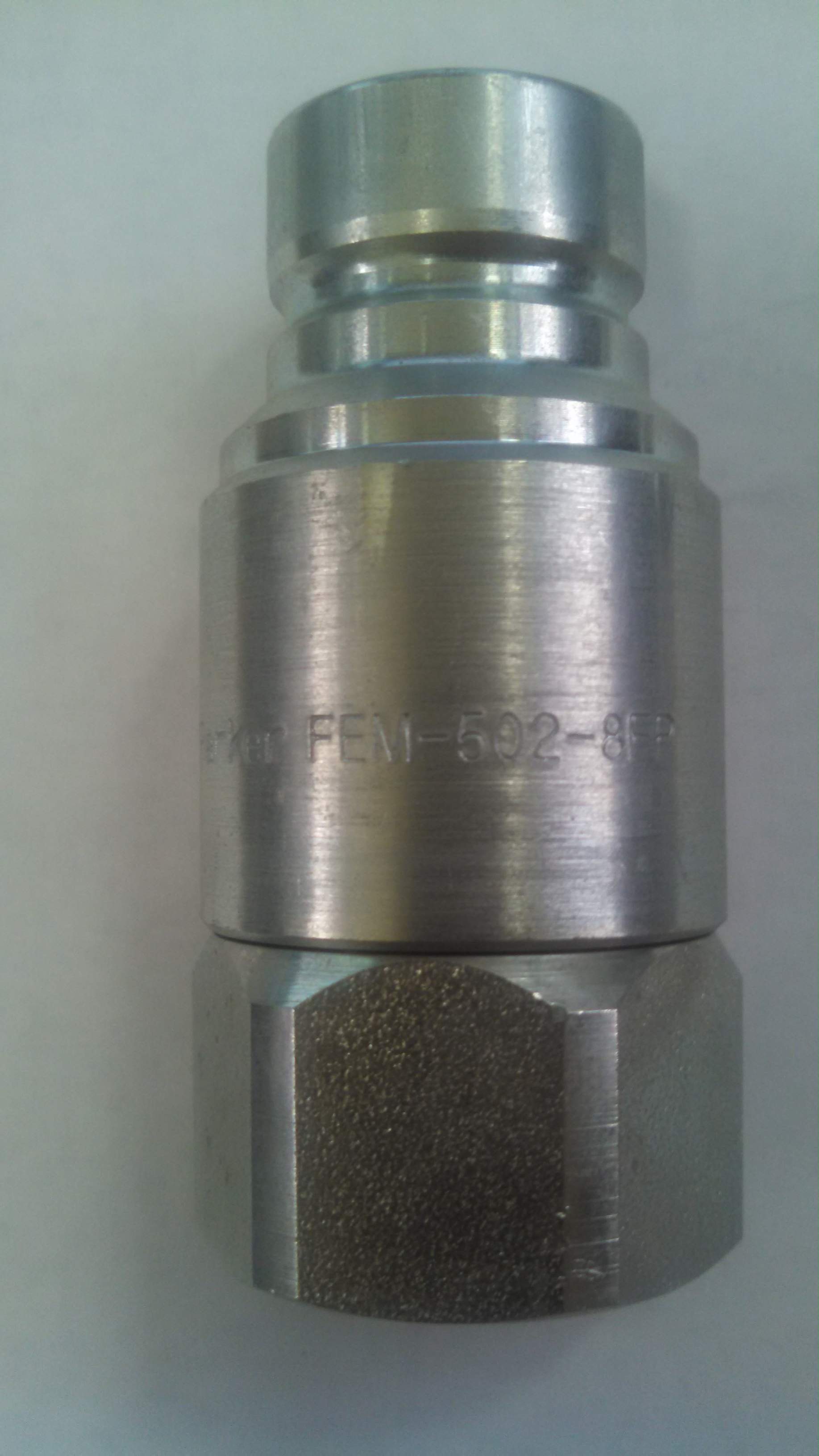

Flat Face Male...18NW Parker FEM-502-8FP
Flat Face Female...120W Parker FEM-501-8FP-NL

I like the flat faced for front attachments. Those are common with Skid steers that also use a lot of front attachments. Not that you can run the high flow stuff, but it gives you a common connector with a lot of other front attachments. Not a huge deal as changing connectors is $50 or so, but that is the way I did mine and it works for me.
   / QD fittings for 3rd functions? #7
Flat face couplers are much more leak resistant when unattached than the standard pin type. They also tend to be easier to couple and uncouple, worth the extra money IMHO.
   / QD fittings for 3rd functions? #8
Within the styles and sizes discussed already it is purely a matter of preference. All will work just fine for a grapple.
   / QD fittings for 3rd functions? #9
I'm annoyed I got ags instead of spending the extra buck or 2 for flat face. My ags drool for a while after you unhook em.
