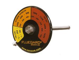

Don't concern yourself too much about the stove top temperature. Get a probe type thermometer for the flue and install it about 2-3 ft above the stove in the stove pipe. It is the flue that will gather creosote, not the stove. A probe type thermometer that is in direct contact with the flue gas is much more accurate than one on the surface of a pipe where many different factors will influence its reading.
Buy at Aamazon Amazon.com - FlueGardTM Thermometer (3-39). Most precise readings for DOUBLE WALL pipe. Durable genuine porcelain enamel with yellow, orange and red zones clearly indicated on black case -- shows temperatures in the center of the fluepipe, at a glance
It works perfectly well on single wall pipe. Much better that a surface thermometer.
