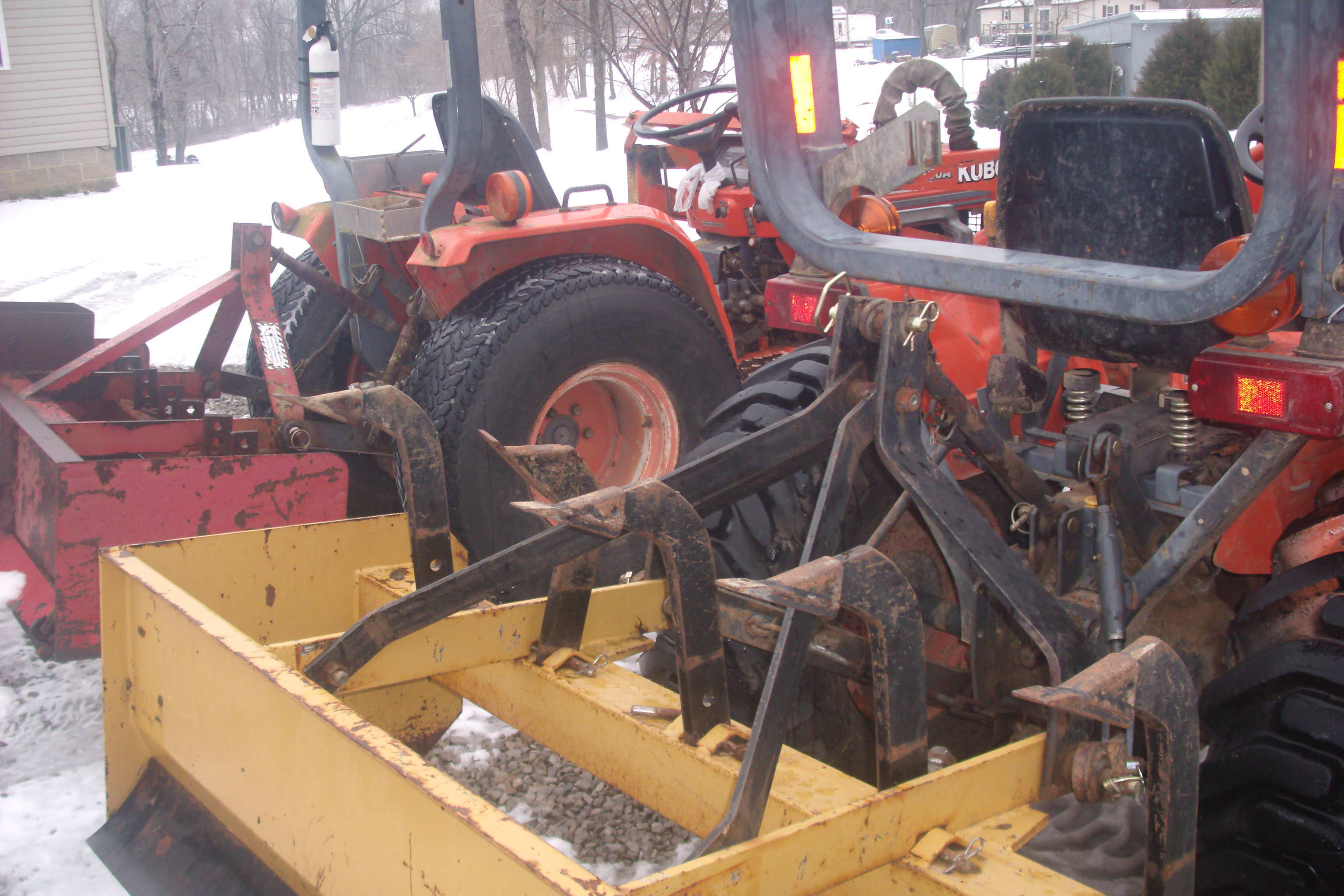

I use the 2150 to fix what the 7800 messes up. and industrial tires suck too. Actually, I take the 2150 over the 7800 in all applications except mowing. GEDC0203.JPG
