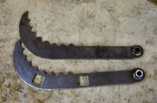

#112
The lower arm pictured is the center lift arm. It has cutouts to permit the 2 X 2 tubes to pass through it.

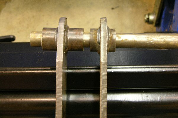

#113
The bushing on the center lift arm is much longer than the outer arms to accommodate the width of the hydraulic cylinder that will attach to it. You can see the difference in the outer and center bushings in this picture.

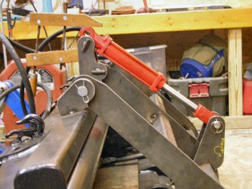

#114
Center pivot/cylinder mount being aligned for position.

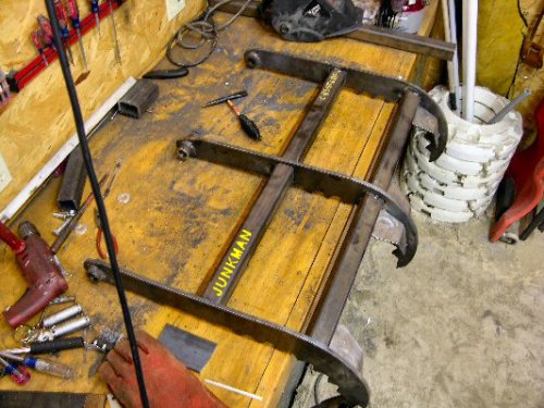

#115
Cross tubes positioned and tack welded.

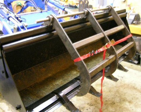

#116
At this point the business end of the grapple is removed by sliding out the alignment rod. It's not so heavy that it can't be easily lifted from the bucket.

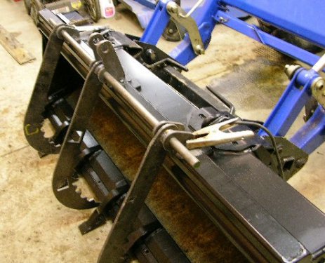

#117
Gussets added to strengthen the grapple tips.
   / Question about a grapple
#118
Another view...
Especially for you Junk !

#119
YYSIUA = Yes, you screwed it up again
Seems we miscalculated on the length needed for the height on the center cylinder support. After close measurement we are a full 1-1/2 inches too short.
This means we have no choice but to cut another center pivot/cylinder support.
