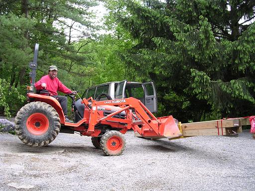

Hello, The one area of the B3030 i wish was a little better , the 403 loader lift capability. Does anyone know if it would be possible to put a woods 1012 loader on the B3030. The actual weight of the loaders are similar, but the woods is capable of a 1380lb lift compared to a 900 on the 403...Any one ? Matt

Matt, I can't answer your question as to whether the other loader could be put on the B3030, but there's a couple of things to consider that you may or may not already know.
1. I don't know what tractor, what hydraulic pressure, etc. was used to determine the lift capacity of the Woods loader, but would the lift capacity be the same on the B3030? Maybe so.
2. Tractor manufacturers design specific loaders for specific tractor models. If they use a loader with a lift capacity of 900 pounds on the B3030, will a loader than can lift more than that damage the tractor?
I'm not saying either of the two is an insurmountable problem because I don't know, but I'd sure be careful if I were you.

In addition to what Bird said...
Don't write of the loader on the B3030 as a lightweight. I will attach a picture of my loader lifting 6 wet pressure treated 16' 6x6s. I don't know what they weigh each, but judging from how heavy they feel when lifting one end, I would not doubt that they may be 200 lbs each. And they were out on the clamp on forks beyond the front of the bucket.
I had no problem lifting them with the LA402 loader on my B2910. I have loaded rear tires, but did not have the extra ballast on the back I normally would. Anyway, I had things balanced and did not lift a rear wheel, until I parked the tractor and got off. My weight made a difference, and the rear wheel lifted as I put my foot on the ground.
It was not an issue, since as soon as the end of the wood touched the ground, everything stopped moving.
I had my wife take this picture afterwards. By shifting the load slightly to the side, I could safely control the amount of rear wheel lift.
But the point really is, that along with the LA403 loader probably being able to lift more than it is rated for, putting on a different loader that is too big for the tractor may also, along with like Bird said with respect to possible damage to the tractor, may increase the potential for one to get into trouble due to lifting the rear end off the ground. This could be a problem both during the intial lift, and also during transport, since the B series Kubota tractors are rather light.
If you are worried about the lift capability of the LA403, you might be better off considering a heavier tractor, like the L series.
