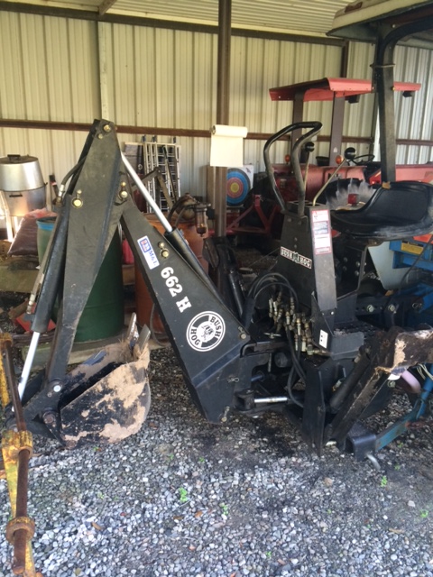

Hello all, my first post, hope I am in the right place. I have one of the cylinders leaking extremely bad on my Bush Hog Backhoe model 662H. Its one of the first older models I think they made I'm guessing in the 80s. I have looked at several posts and searched for the exact kind I have but even on the new models the cylinder looks to be made a bit different. I have ordered the seal kit for it and was wondering if anyone had experience with this type of cylinder. The Gland is loose and easy to remove. My question comes in, after unscrewing the Gland, if I can then just pull out the entire assembly or is there something else I need to make sure to undo like a snap ring inside the housing or something like that. I will post a picture of the cylinder and its leak. tks for any help someone can give.

Hi. Welcome. We like pics.
The piston should come right out the front. Go easy reassembling so as not to damage the orings and seals.

I don't know what a "gland" is but I assume you are talking about that disc with 2 holes encircling the shaft in pic #2. I agree on unscrewing it and the whole shebang comes out. First thing to do is to remove the hyd line from the rear of the cylinder too prevent a vacuum buildup when you pull the ram and have a means to capture it when it comes out so that you don't scar the shaft.
You should have a pair of seals on the "gland", probably a pair of O rings, one to seal the gland to the cylinder housing and the second to seal around the ram shaft.

Yes it's threaded....look at the opening end on the cylinder. That's an easy one. All you need is a good penetrating oil and a good set of large needle nose pliers bent on the end at a 90 degree angle (I have a pair) or make your own wrench, or a punch and a hammer back and forth punching at both holes at the lowest possible angle. All the stuff on the left is at the top and the stuff to the right is at the bottom. Don't know what you know about packing but packing is a seal of some sort and in these things it can take several forms. The top part is possibly an assembly that comes out when you pull the gland nut. But I'd bet it's not and the cylinder is counter bored and Item 30 probably rests against item 14 which rests against the diameter change in the cylinder and the O ring, Item 9, is probably mounted in a groove in Item 30. The gland nut jams all this stuff in place and on the up stroke the bottom part of the ram hits this top assembly of parts and that's what stops it's extending action.
When you pull the rod, with the gland nut out, all this top stuff will come riding on top of the stuff on the right of the breakdown. You will need to replace the wear items then be sure and load the top stuff on the shaft before you put the bottom on and torque the nut. Since the diameters will be different, as you push the rod back in, the top will stop at the counter bore shoulder and the bottom and the shaft will continue to the bottom.
I have had some I couldn't get apart so I used compressed air in the fluid connection at the bottom end to "blow" it out. Just remember the force will be the PSI of your compressed air X the area (½ diameter squared x 3.14). If you have a 5" cylinder with 100 psi you will be looking right at 2000# of force. Gotta use high pressure to do the job, but little squirts and watch the cylinder...just nudge it along and have a place for it to land.

Like any seal of the type, the flare is designed to seat with applied pressure so the seal has to go in such that fluid pressure from the inside will force the seal against the shaft or cylinder wall as the case may be for the inner shaft seals and outer cylinder seals. Just pay attention as to how you disassemble it and you should be good to go.
