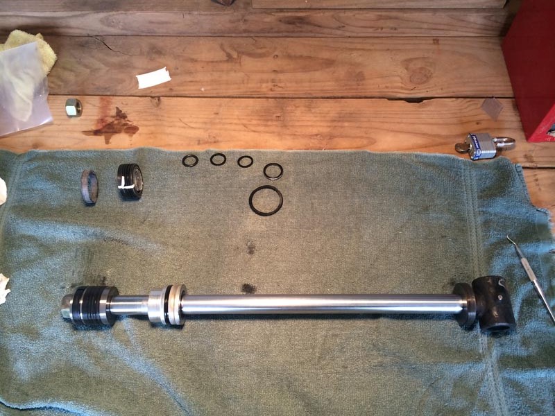

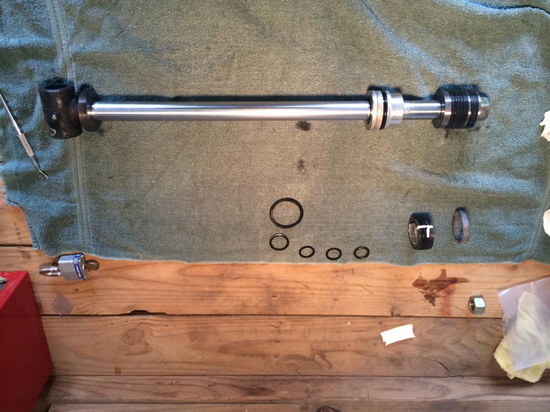

Well thanks everyone for the help relatively easy to remove and replace everything. So far no leak and working great. Now have my eye on the smaller ones where the backhoe pivots side to side where it connects near the tractor. Looks like a snap ring holds those in instead of a threaded type gland ring, one is leaking pretty bad. I'm including a pic of the inside of the ram I just rebuilt.
